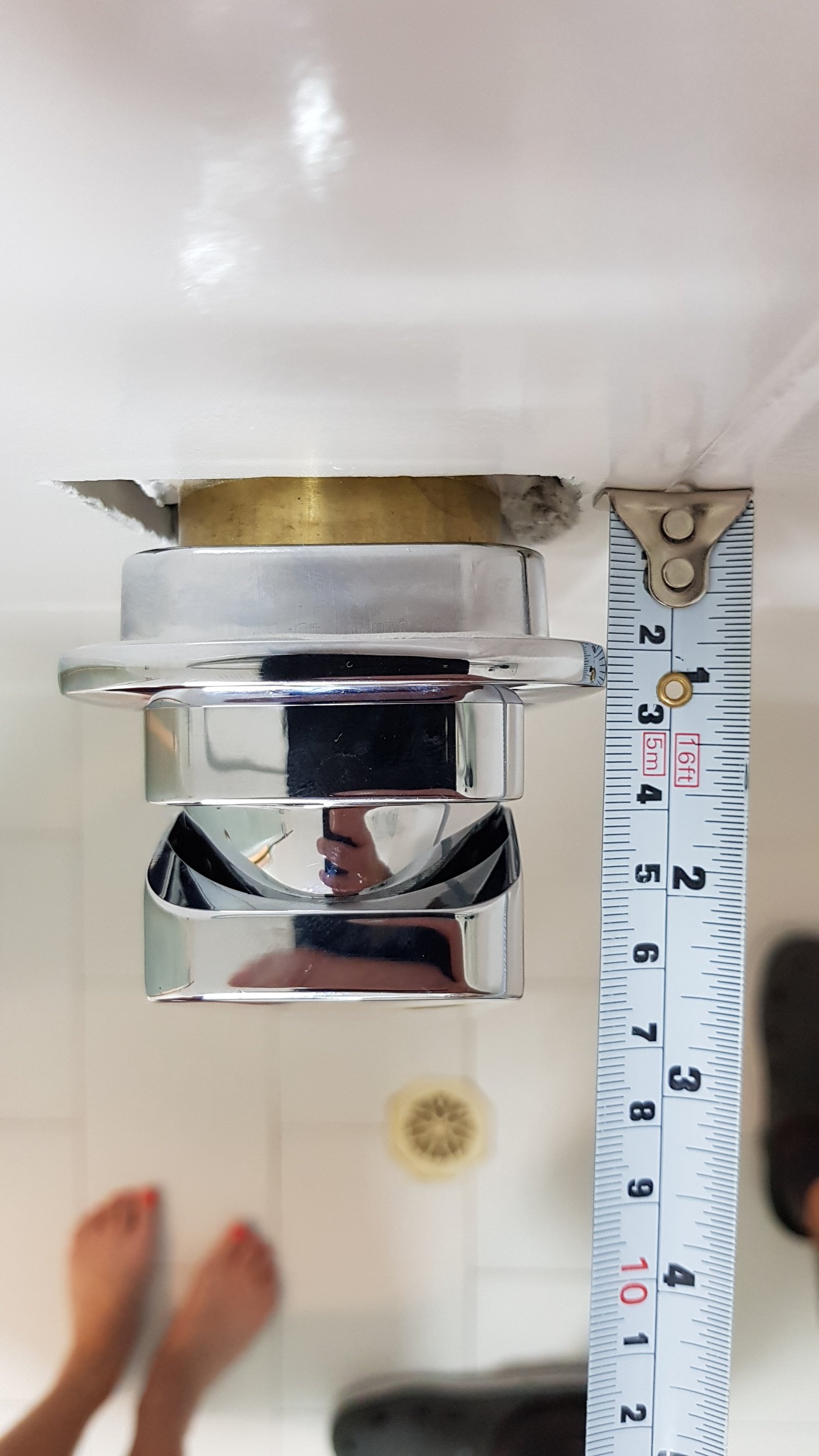

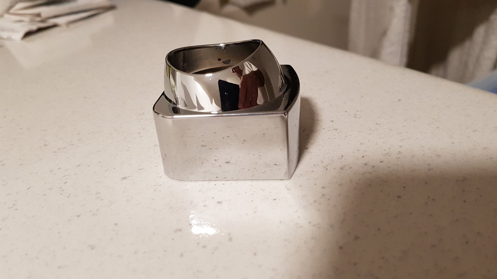

we need to recreate the 2 attached shower tapware parts. These parts need to be 25 to 30mm longer.
I need some help to get me a 3D design for these parts so I can get them 3D printed in a water resistant material.
Can anyone help me with this? I attached a couple of pictures to give you an idea. I can send more pictures to those interested.
thank you, Thierry.

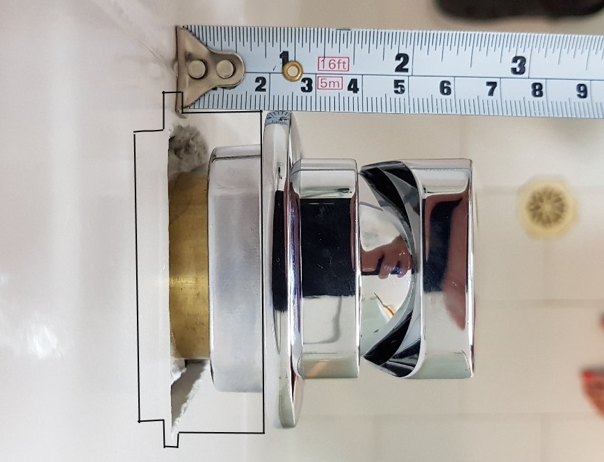

I don’t think you need to replace the part, I think you just need an extended cover plate from the wall to the backside of your current cover plate. I’m guessing the plumber left the pipe too long or you’re missing the piece I’m talking about. I created one based on what I can see from your pics. Hopefully the image will come through.
https://www.thingiverse.com/thing:2643159
Or go to tinkercad and type in faucet collet in the search engine and you will find my design.
