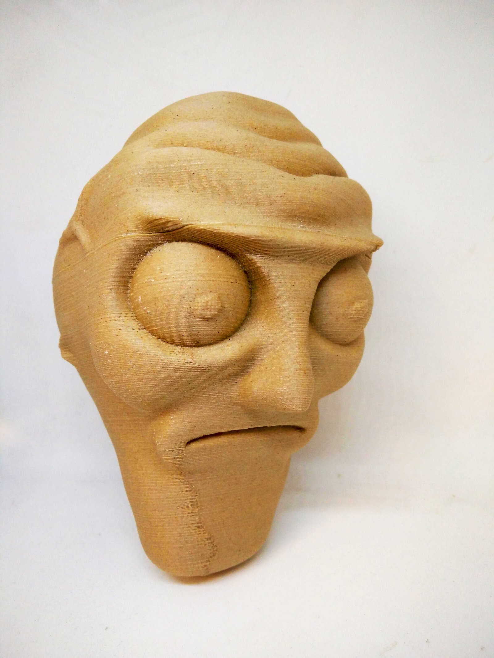

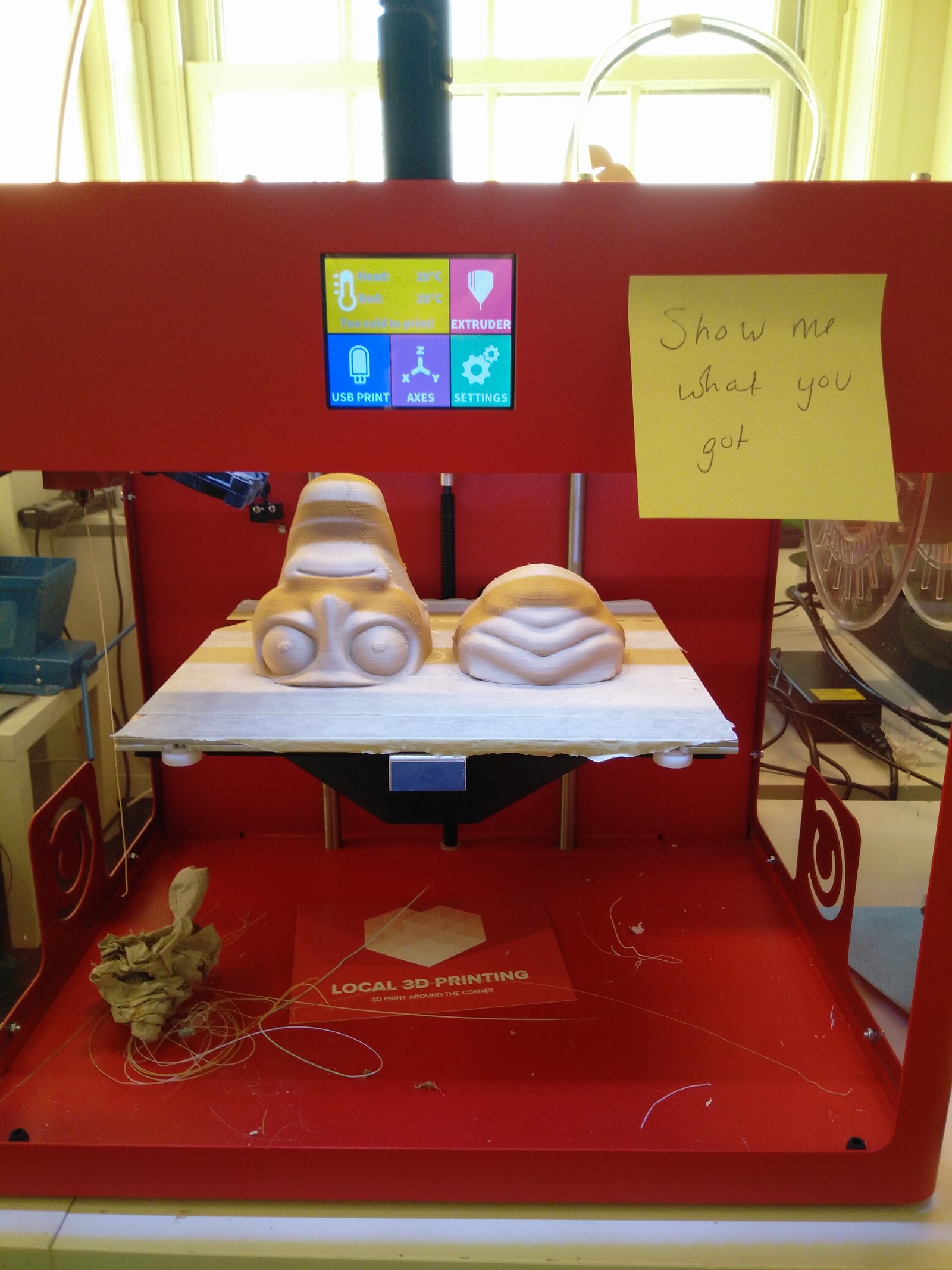

I was pretty happy with the result, and thanks to the magic of 3D printing, I could make it real ! I cutted it quickly with NetFabb Basic, sliced it with craftware and just launched the print on the CraftBot+ before leaving.
Aaaand this is what I found in the morning ! I love the feeling of a successful overnight print soo much ! (The Post-it note was added by somebody before I came in)
So it was printed in Woodfill with 20% infill, 200°C, heated bed off, 60mm/sec.
Result is not perfect but I don’t care it’s Schwifty as Hell !!

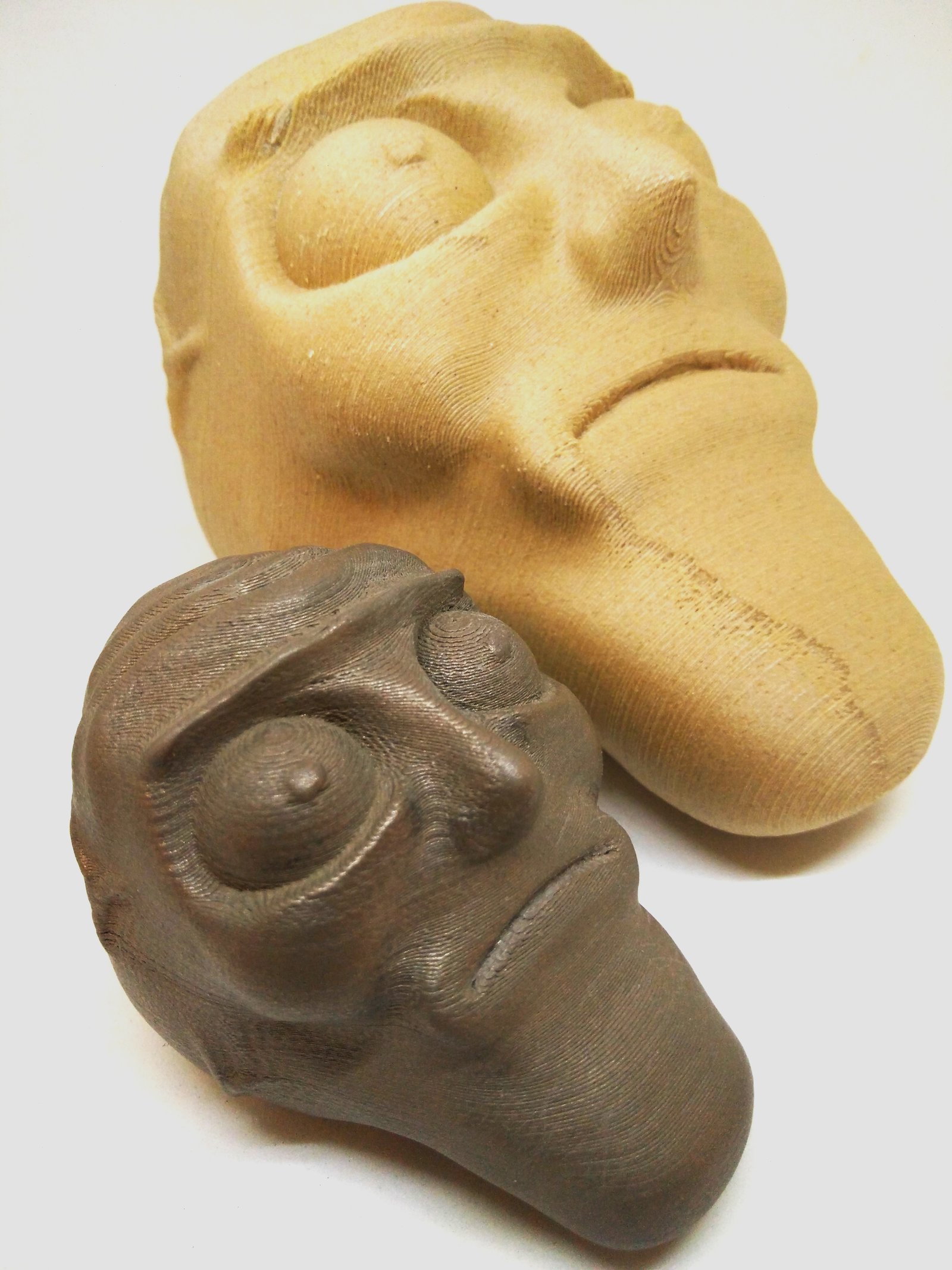

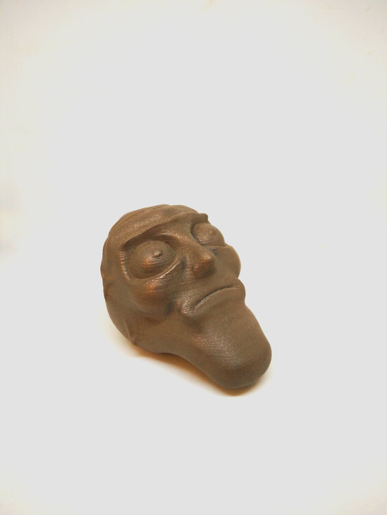

I was so happy with the result that I decided to print another (smaller) one in one part and in BronzeFill from @ColorFabb and then tumble it to make it shiny ! Still printed with the CraftBot+ with regular PLA setting (Fan off). Infill is 50% to make it heavier !

How’s the craftbot liking our filament? we haven’t got one in our lab, but since it’s a 1.75mm direct drive I imagine it should work pretty reliable, right?
I was amazed at the speed you were able to create this one Victor! Incredible work for a first practice sculpt in ZBrush!
Hey ColorFabb, I will :wink:
I was quite amazed at how the CraftBot handle your special filaments (Tried Woodffill, Bronzefill and Glow in The Dark so far).
Never had a jam or a bad print. I think a stainless steel nozzle would be necessary if we want to print more of these though :wink:
