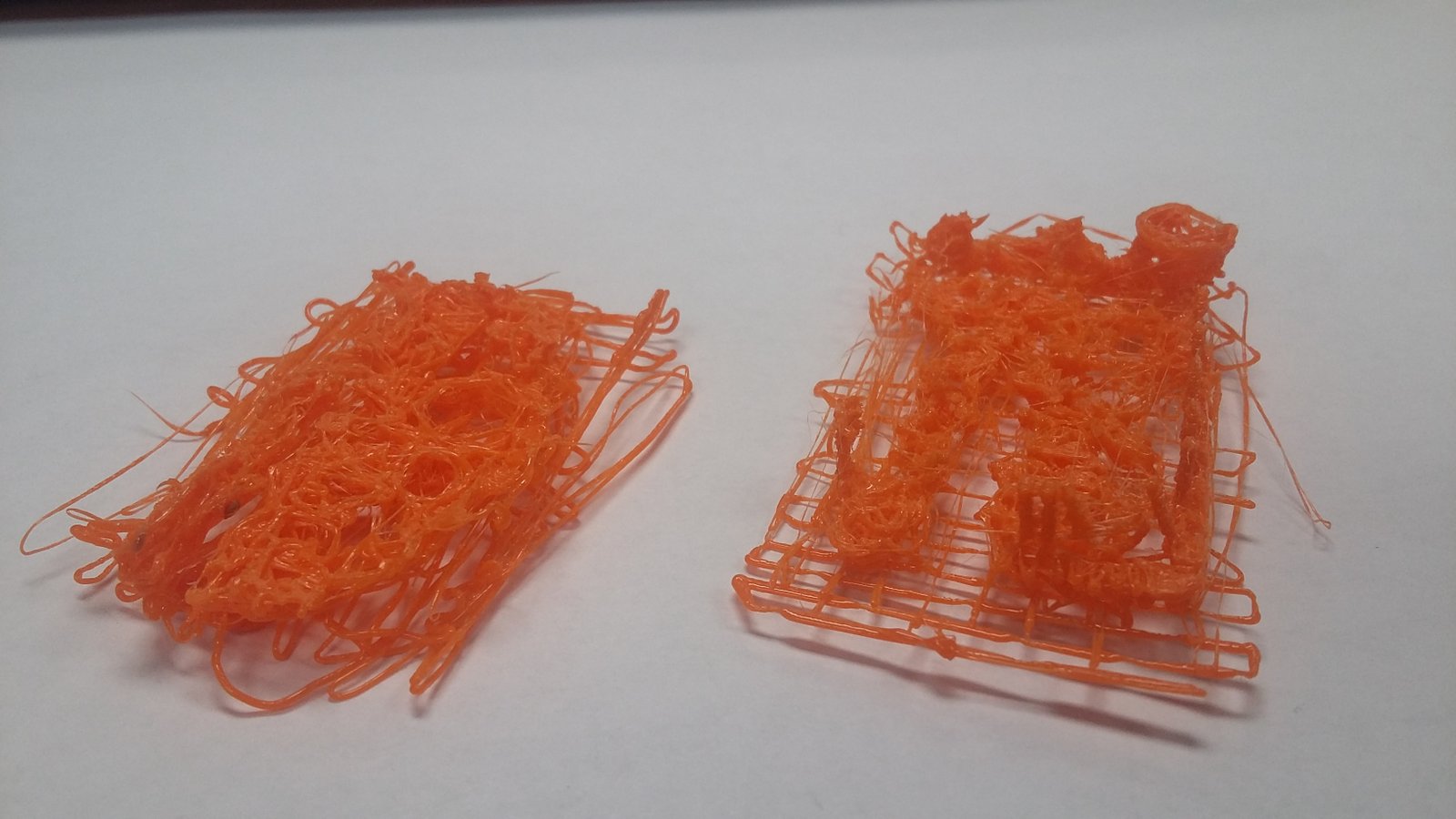

I am a teacher at a small Charter School and found a CTC 3D printer in a back room. Apparently when it was purchased a few years back no one could get it working. I took it home and after some testing with a lack of Z-Axis movement found the Z-Axis cable was plugged in tot he wrong place on the motherboard. The first image is what I was getting prior to fixing the cable. I used MakerBot to connect with the printer.
Unfortunately I also upgraded the firmware to Sailfish when I fixed the motherboard and the second…this is the result.
I’m getting Z-axis movement but the print quality is crap (I have tried using both MakerBot and ReplicatorG with no improvement). I have tried the atomic cleaning method and the PLA came out clean (although a flat nose instead of pointed). I have tried adjusting print speed (as best I can using either system) and temperatures. I am at a complete loss. As near as I can tell I am dealing with something along the lines of under extrusion combined with not sticking to the plate (the picture represents the best I’ve managed to get since the filament usually curls so much at some pint that it balls up the whole model).

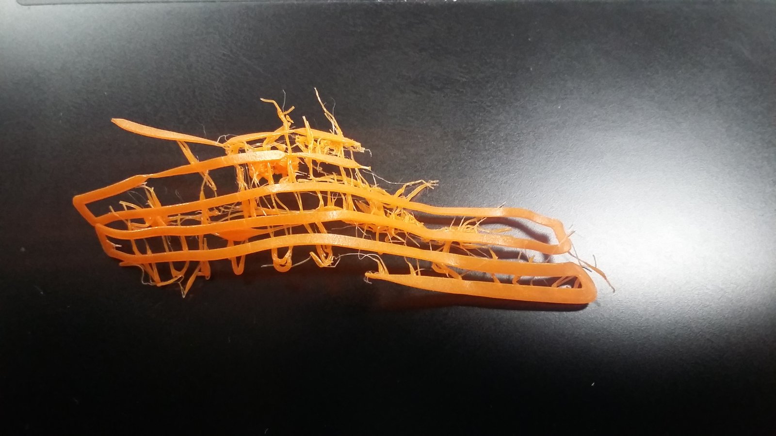

Thank you for the advice. I turned up extrusion temperature to 260C and saw an initial improvement. Here is a picture (someone tore it up not realizing we needed the failed sample to help fix it):
I took the image upside down to better show how the filament started. Unfortunately it quickly went back to how it was and then down hill from there. I have not been able to recreate the initial improvement in the above image.

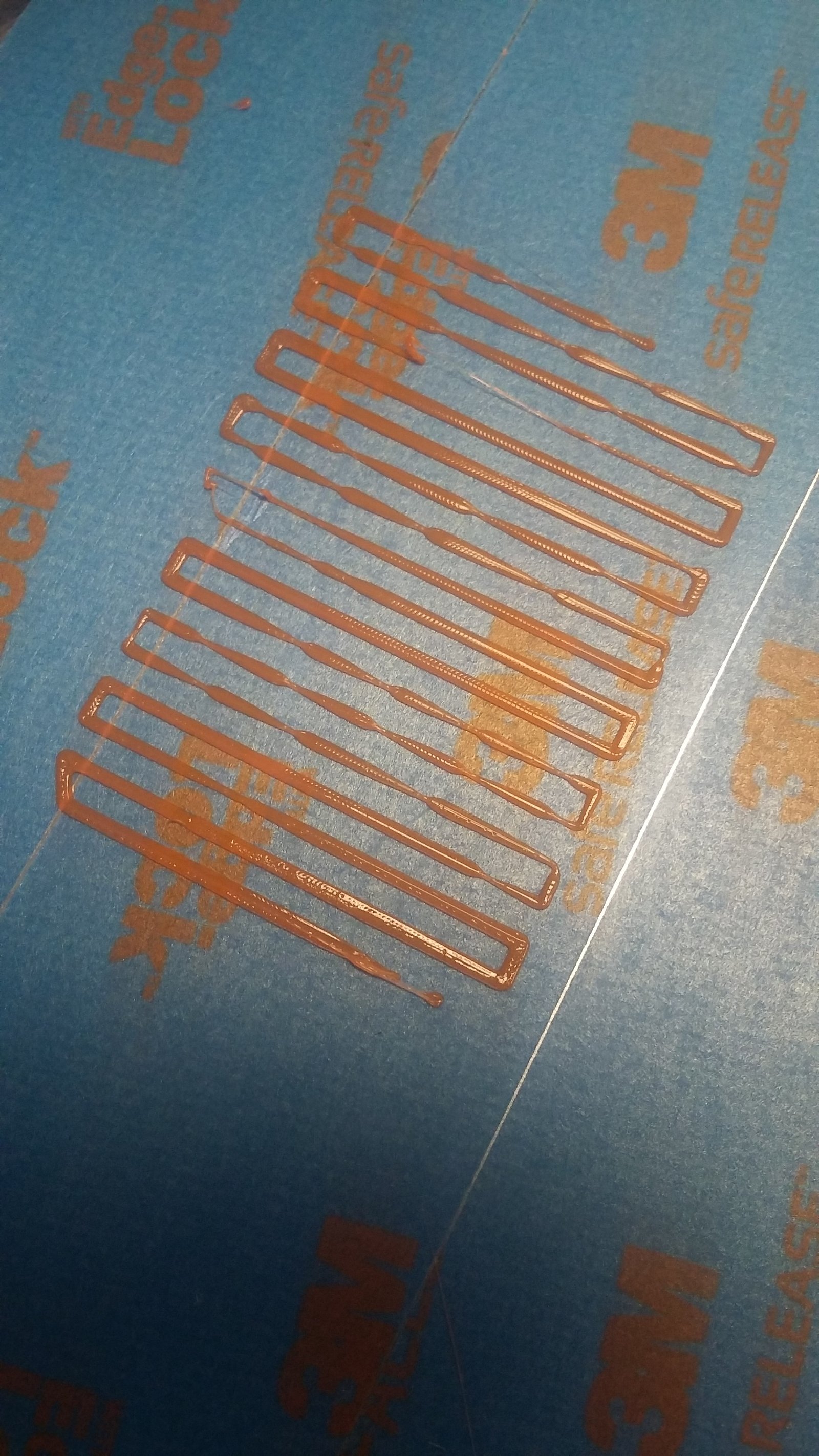

Yes, the black wooden frame and dual nozzles. Here is what I got on my initial layer today:
I confirmed my suspicion that the clicking (sounds like gears struggling) coming from the extruder coincides with inconsistent thickness in the filament being extruded. If left to continue the model continues being built similarly to the model in the first picture (on the right side). The base is no where as dense as the test image suggests it should be. Also the nozzle occasionally bumps into the extruded layers while building.
