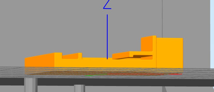

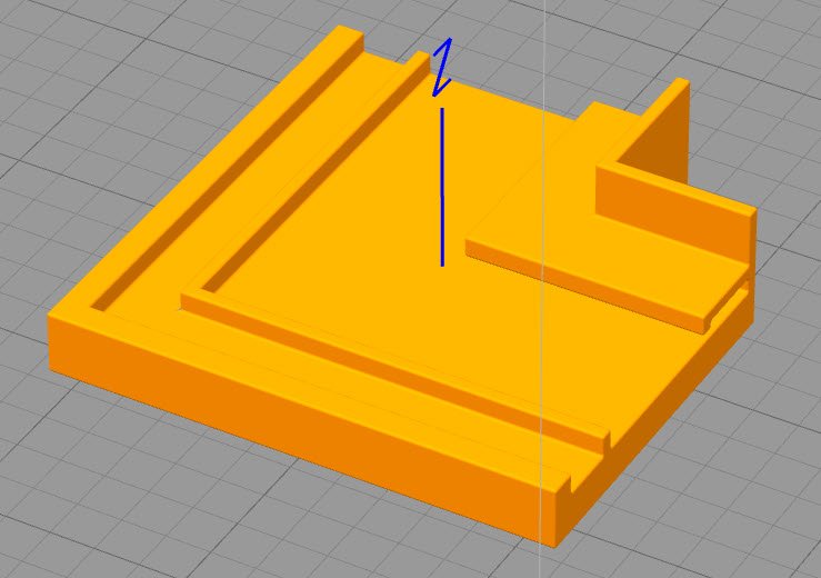

I have a small part that looks incredibly basic but I’m having an issue trying to print it successfully for a customer. It is a small 2.25" by 2.25" by .5" piece that he wants printed in ABS. Problem is it has a 1/2" long, 1/16" high overhang that goes around a 90-deg corner with a lip that brings the gap down to 1/32", almost like a drip edge.
I loaded up some HIPS in the left extruder and ABS in the right extruder thinking I’ll just print it, dunk it in Limonene and we’re good (I need to print 2 each of 4 similar parts (each with similar overhangs)). Anyway, I have been trying to get a decent print but that dang overhang is killing me for some reason. I just can’t get it right.
The client is VERY concerned about the bottom of the part and needs that as smooth as possible. It actually prints very nicely on a HIPS raft, separates easily.
I have tried printing the part standing on its end as shown in the last picture below and it comes out great but doing so adds an hour to the print time and almost doubles the material usage.
I’m using Simplify3D and tweaking settings, doing a test print, noting the results, tweaking, etc. I sunk the part down into the bed a bit so it gets to the overhang more quickly. Any thoughts/ideas/tips anyone has that may help me get a successful print for this thing in ABS lying flat? Thanks…!

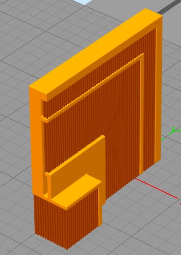

Can you share a bit more info as to what all your settings in S3D look like? And specifically what kind of failure you’re getting with the overhang? It may come down to your support and bridging settings…

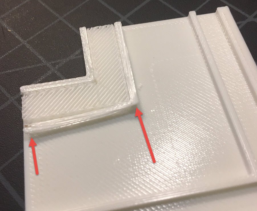

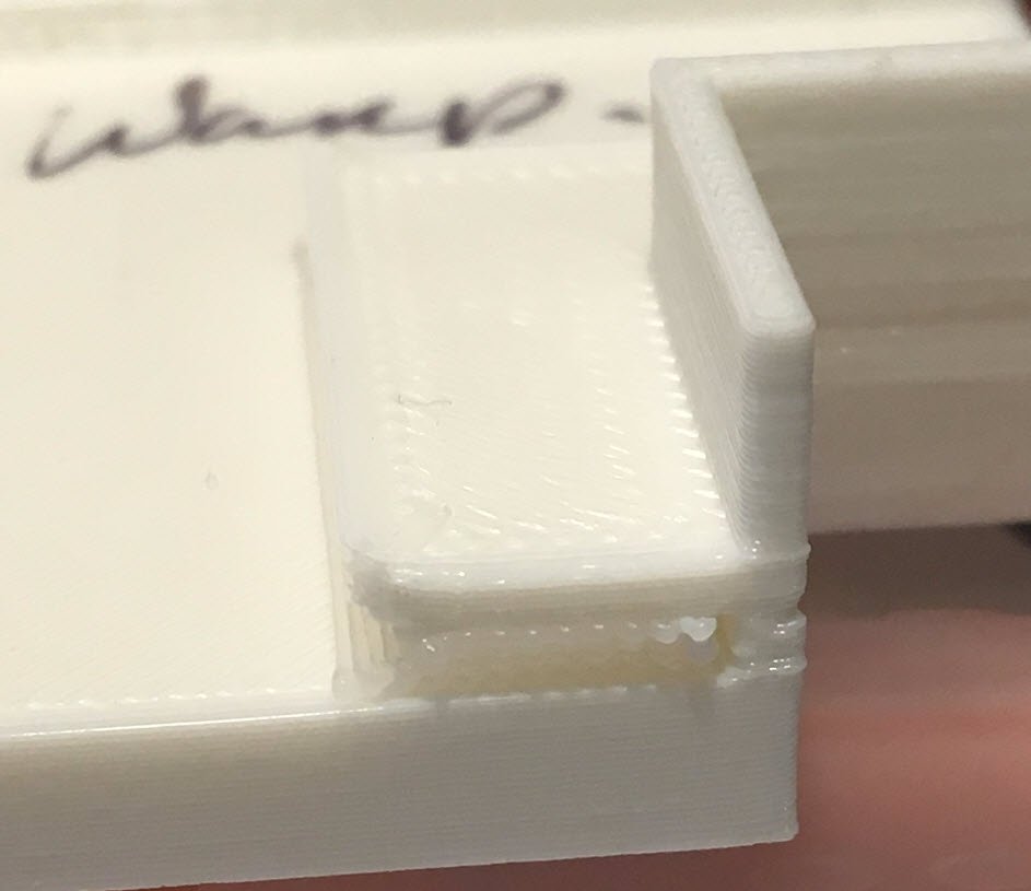

I actually have been able to get the supports to work, and quite well. It is the ABS that then needs to print on top of the supports that is giving me the trouble. I have one print that was successful but dang W10 updated overnight and I hadn’t updated the selected profile in S3D. Ugh. Anyway, here are a few examples of what I’m running into:
I see what you are up against now.
How about if you make the support closer to the lip-under side and use dense supports for more coverage?
Just replied with a few pics to @wirlybird. The support is being printed in HIPS.
The overhang gaps in the model are 1/32" and 1/16".
My settings for those particular prints at the time were:
Support resolution in those pics is 1mm,
Support Infill is 50%
Extra Inflation 0.00mm
Dense Support Layers 1
Dense Infill is 70%
Horriz offset 0.20mm
Upper & Lower Separation Layers both 0
Yep, I’m using HIPS for the support. I love how easily it breaks away…
Currently trying 1 dense support layer and 70% dense infill %, and I have the vertical separation layers at 0. Considering turning up the ABS temp a bit to see if it will bond better at least when being extruded.

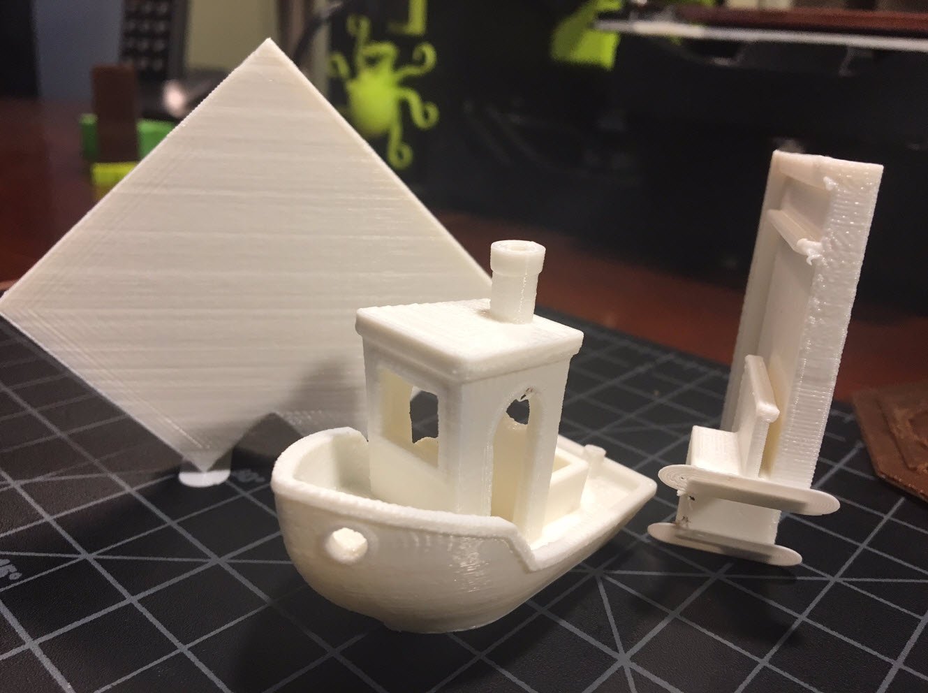

I want to first thank everyone who responded to my post. Everyone had great suggestions and I really appreciate everyone taking the time to try helping me out. I think I’ve solved my printing issue and am posting it as a separate comment as opposed to a specific reply.
@ChrisX35 - Special thanks to you for your QIDI FFF that you had posted on Thingiverse (@TTB_Studios - I tried yours too but it seemed to be specific to the FF and didn’t work on my QIDI - seriously appreciate your sharing).
I used that ‘QIDI ABS’ profile to print a 3DBenchy to see how it would turn out. Came out pretty good so it was a known quantity. I figured I’d just modify that to add the HIPS to the left extruder and work my way back to using both materials.
What I decided to do instead was flip the part to a 45-degree angle and see if it would print that way. I used a brim because there was almost none of the part touching the build plate but it held the part down (also set the first layer width and height up to help stick). At 45-degrees it shouldn’t need any supports at all theoretically. I also had to rotate it 90-degrees so the ridges were facing the cooling fans otherwise the far side didn’t look so hot.
Below is a shot of the final result… Still need to do a little cleanup on the parts but they actually came out pretty good I think. Again, thank you to everyone who offered advice. I really appreciate your time.
