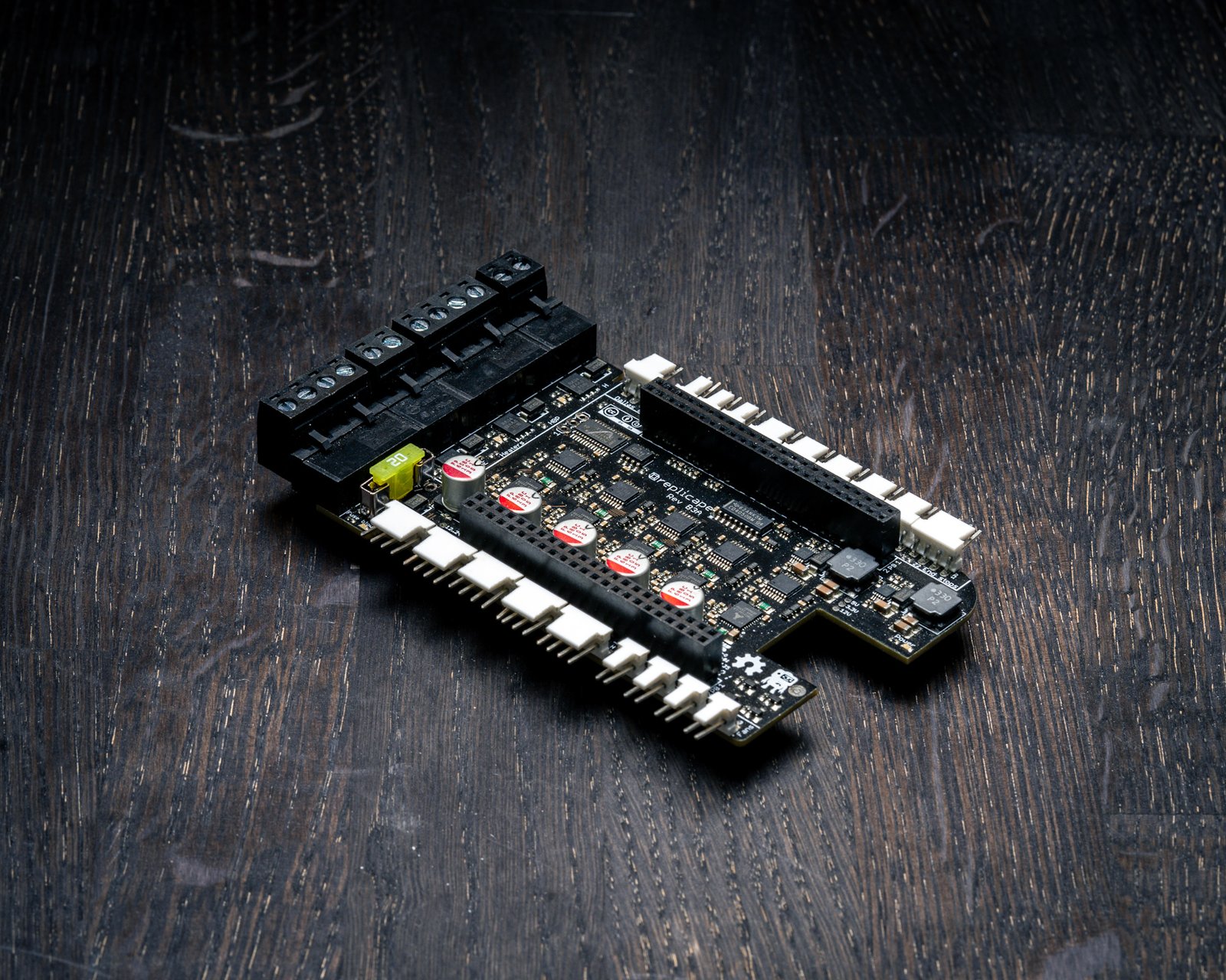

otherwise you could consider the Replicape on a beaglebone which does have some interesting advantages.
