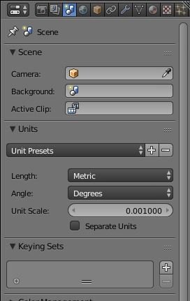

I’m using this setup on Blender and export the models 1:1 Scale
to double check my units I open the STL file in Netfabb
