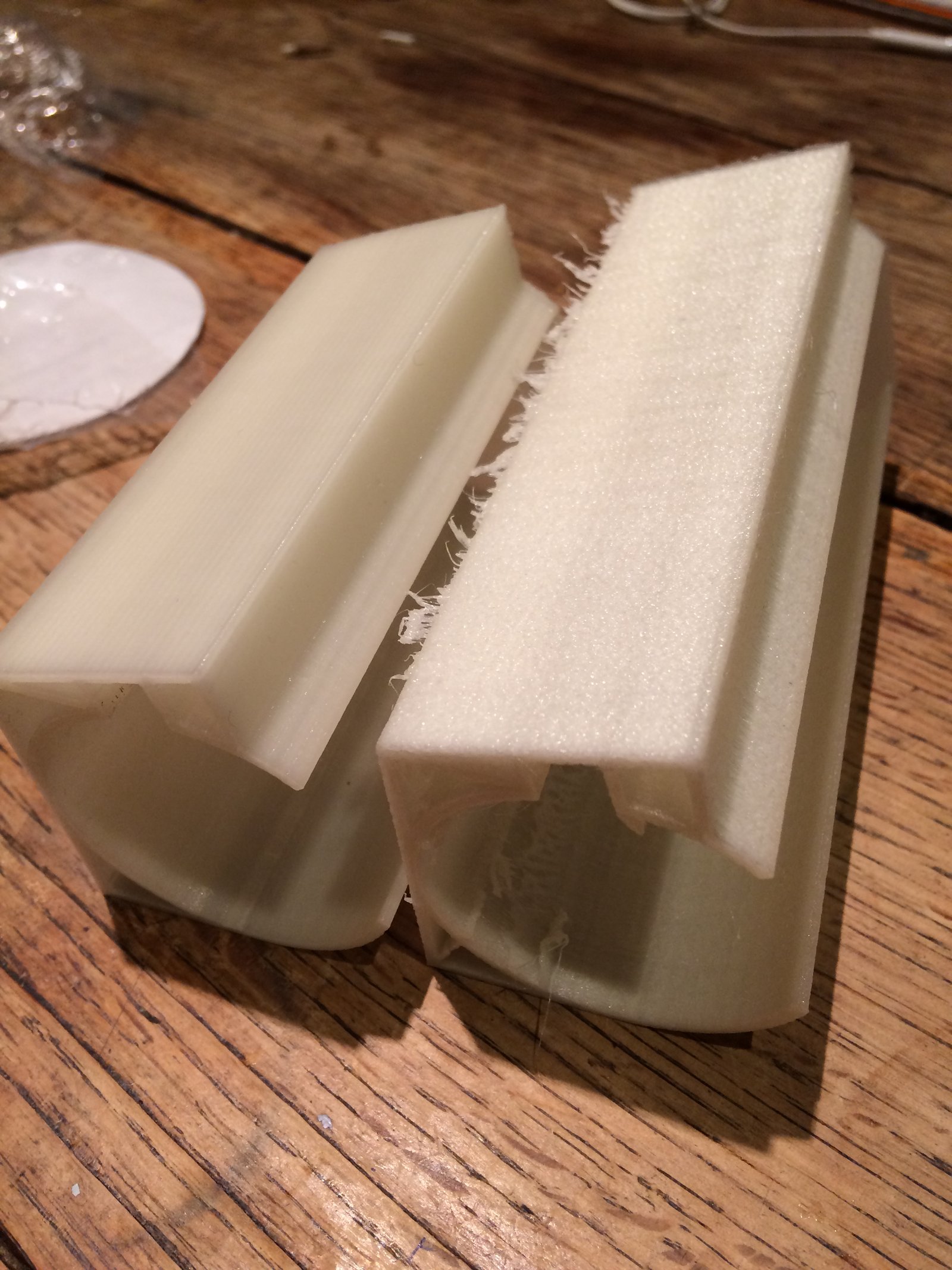

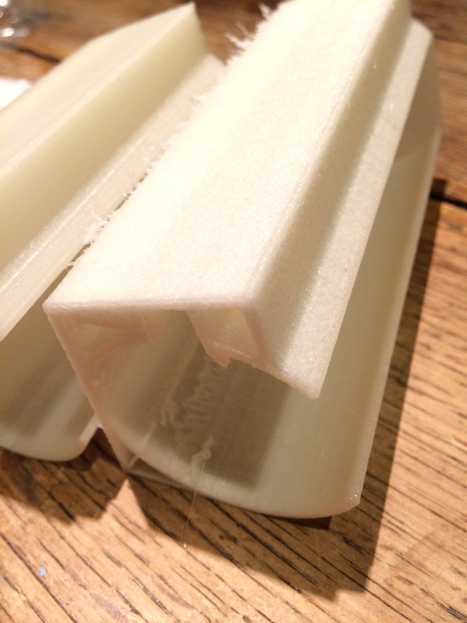

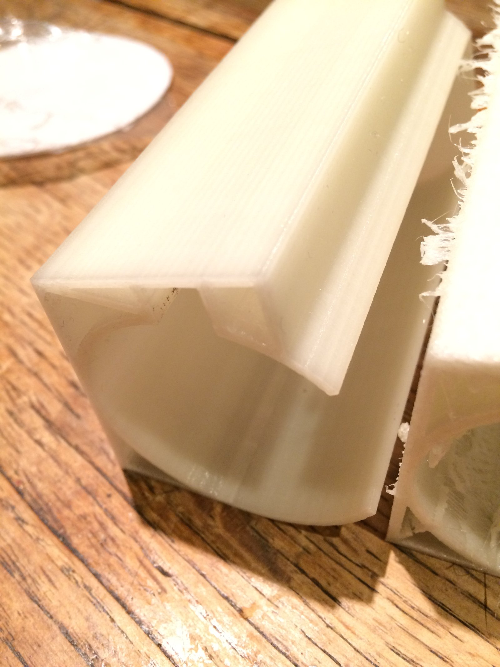

I then changed filaments to a new roll of black PETG and again had a lot of trouble to find the right temp (this time 250). Now I just loaded the old roll of glow-in-the-dark PLA back into the printer to print another part at the original settings that used to get decent results. Suddenly, the prints are totally different?! As you can see in the pictures, the structure and color has changed. Furthermore, the wall thickness has increased with almost 0.5mm.

On the left is an example of the result I got a few weeks back, on the right is what I get right now. (As you can see the stringing got back too…)

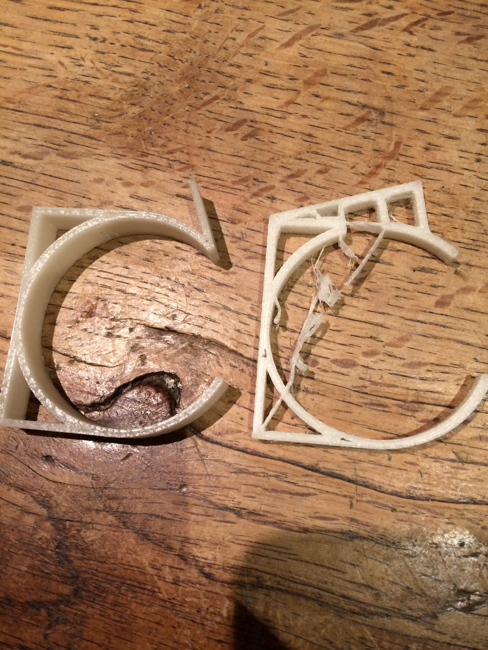

Same story here (although slightly different part):
I also use Replicator 2s, and the pictures certainly look like it’s a temperature difference in the two parts. Your printer isn’t shared with other people who could have changed out the print nozzle, is it? I have 5 different Replicator 2s that are running different nozzle diameters and this sort of looks like the results when I use the wrong settings for a particular nozzle diameter. Also, are you running your machine on the Makerbot firmware or sailfish? I have all my printers running sailfish with great results, especially since I use Simplify 3D as the slicer. Another thought… was the temperature in the room where you were printing relatively the same on both prints? I can’t see that causing too much issue, but here in Texas the temperature can change 30 degrees over night and that certainly can cause various results.
It sounds like a temperature issue. I have had issues with ambient temperature swings causing significant differences in print quality. Also if the cooling fan or temperature control components are failing, that can have an impact. Another potential issue, depending on where you live, is humidity. Plastics do absorb ambient moisture. Some plastics are much more susceptible than others. Most plastic injection molders make sure their plastic are dry before running it through the molding machines.
Cheers!
Looks like water in the plastic tbh.
My thoughts are this. PTFE tube? If so then over 230 and starting to ask for trouble. At 250 it is probably damaged.
Also if you ran PETG at 250 then went back to PLA at 200 or so you very well could have PETG still in the extruder since with the PLA temp it isn’t hot enough to melt it out.

The PTFE tube is fine, this doesn’t really come into contact with the heating block. Your other point does seem like a very likely cause. Any ideas on what be the best way would be to remove any leftover PETG?
Yeh I thought about that. Could definitely be as there’s a time difference of about 2-3 weeks between both prints. It’s plausible that the filament has absorbed water. I might try drying it out, thanks man!

Thanks! I tried this a couple of times and at first I thought it was working. Unfortunately I still get the same results. Very frustrating. What botters me most is not the change in structure and color, but the change in width of the parts. Every wall becomes at least 0.7mm wider then what I had modelled. I think I will go ahead and order a new nozzle. Where do you order yours?
I order from ebay.com. I typically will buy them in multi-packs and usually try to get a variety of diameters. In the meantime, would you like to send me your STL file and let me slice it for you in Simplify 3D? All I would need to know is your extruder nozzle diameter. The standard Replicator 2 has a .4mm nozzle. I would really like to rule out the possibility of this being a software/slicer issue.

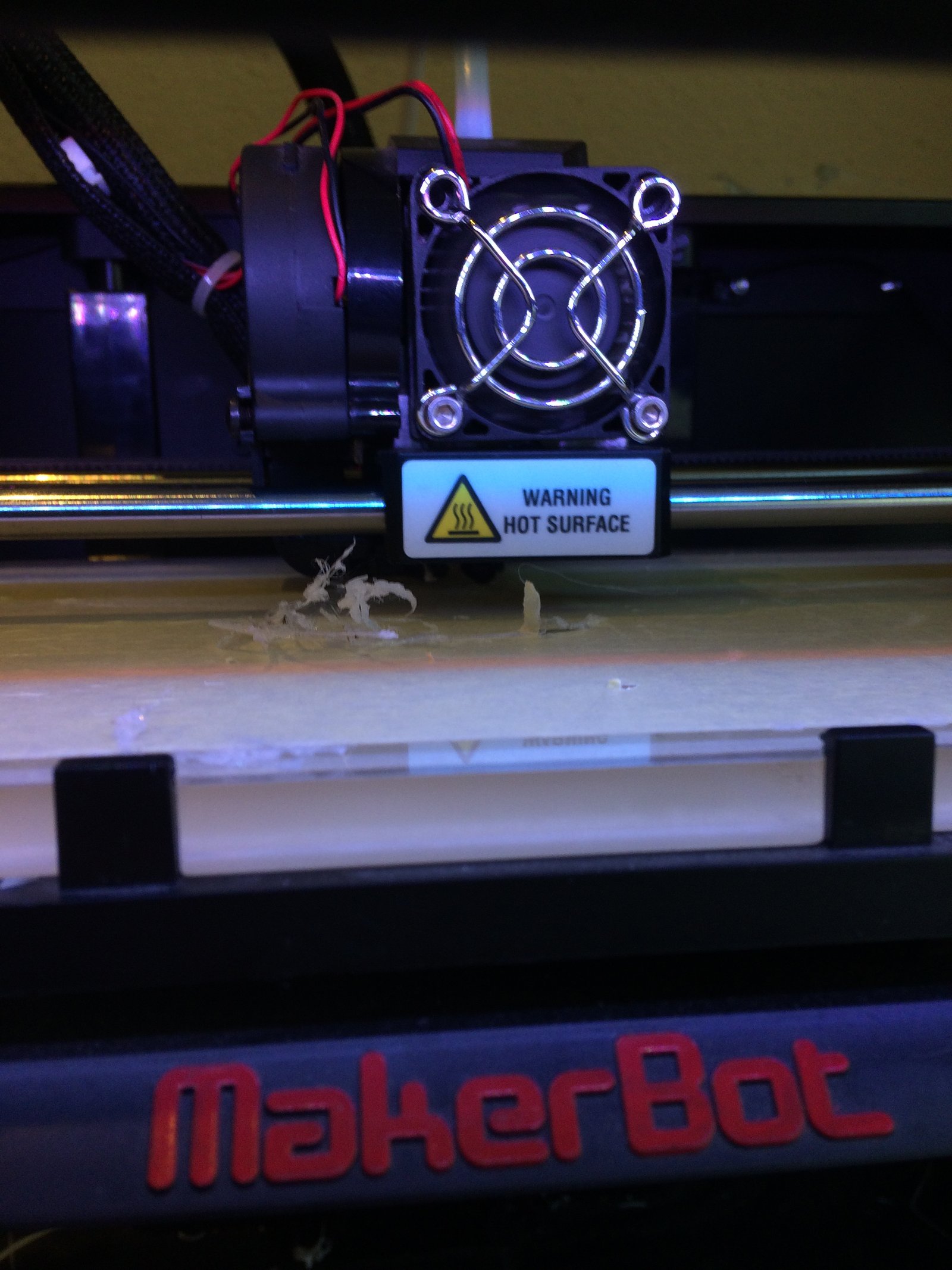

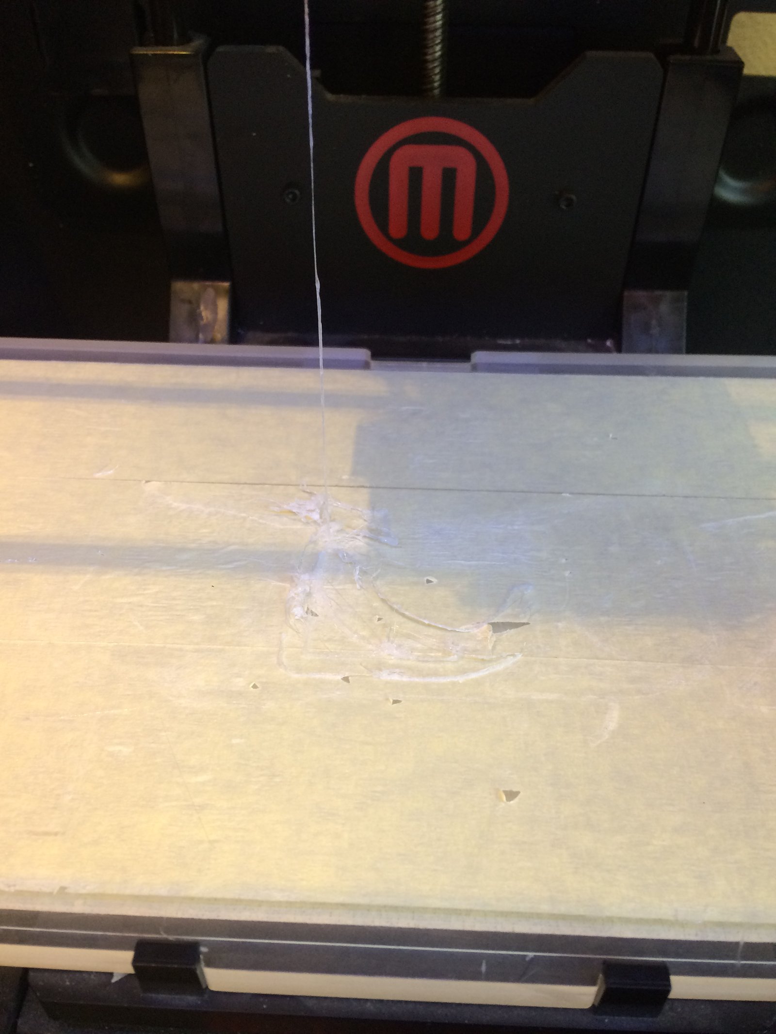

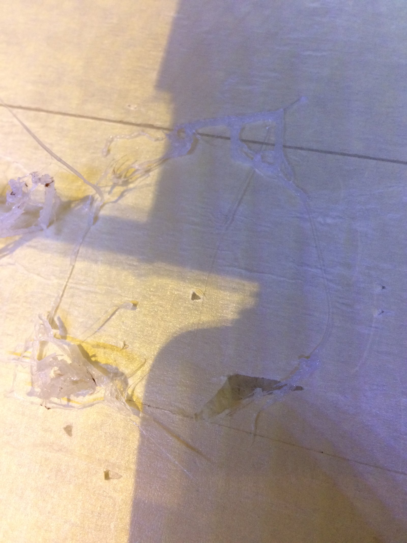

Sadly to say, it wen’t horrible… The first layer did not stick properly and a bunch of plastic kept sticking to the nozzle. I then brought the build plate a little closer to the nozzle and tried again. But not much difference… I added some pictures.
I just ordered some stuff on ebay (for instance a ceramic insulation tape, which I did not have any more). Hopefully a new nozzle will fix the problem.

Wow! That was horrible! Haha… I’d say the new extruder should fix you up. Don’t forget to set your preheat to about 150 when changing that extruder. It will allow you to get the old one off and new one on without damaging anything. You may want to look up a detailed procedure on this. I was curious though… did you ever get any good prints with any other materials after it started getting bad results with the glow in the dark filament?
Haha yes hopefully it will fix it. A good to know, I will look up a procedure just in case. I haven’t tried that yet. If I do, I’ll let you know ;).
