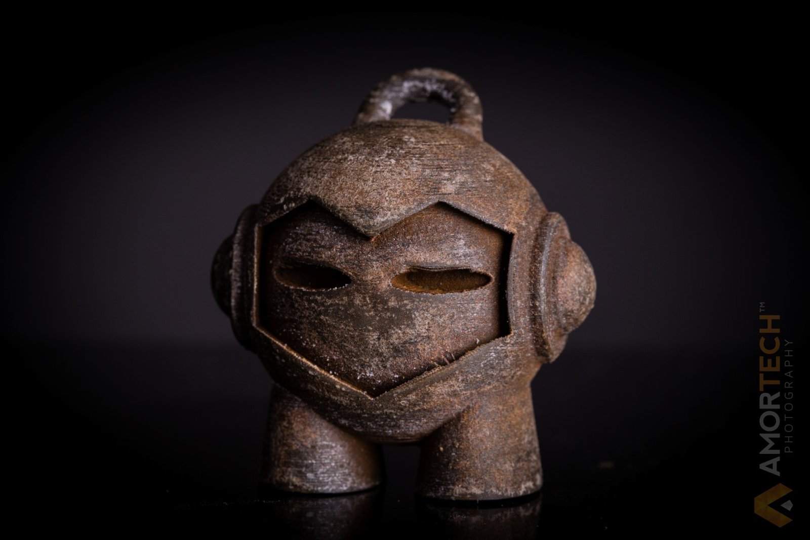

We haven’t seen too many of these around so figured we would post up our first attempt at some rusted finishes.

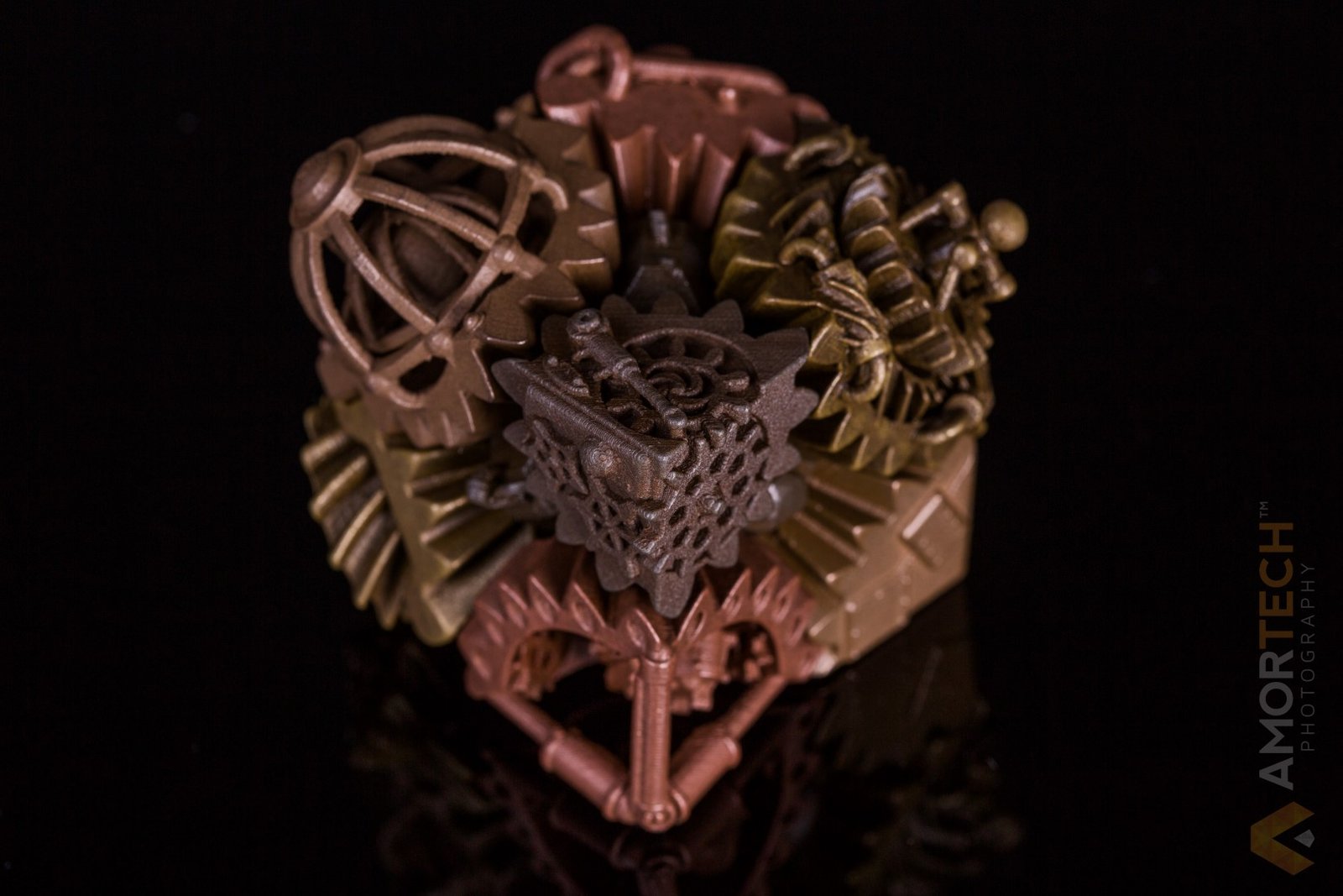

Printed with the Proto-pasta Magnetic Iron, a little salt bath and some sun and we have a classic antique marving on our hands. Really liking this filament and wait till you see how it looks in our steampunk masterpiece!

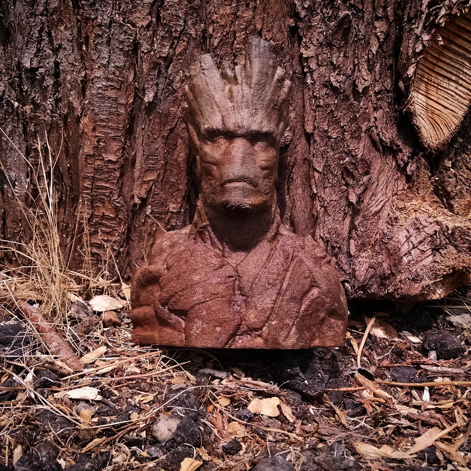

Check this one out :wink: I wrapped him with a peroxide, vinegar, salt soaked towel and put him in a plastic bag in the sun. The rusting is almost immediate but I left this over the weekend. More steps on our @proto_pasta Instagram page :slight_smile:
Wear with the iron is not too bad. It’s only 40 wt% and the iron actually helps the plastic flow more easily.
You can try a 125g loose coils without worries or pick up a wear resistant nozzle from Proto-pasta.com if it makes you feel more comfortable trying this out! A little risk for a lot of fun!!!
Prints super-easy like pla. Rusting is easy too! Give it a try :slight_smile:
Love his steampunk look, really nice job! How long does it take?
Thanks for the feedback! Yeha as mentioned it prints great - I actually run the same settings for it as I do with the Colorfabb which is pretty much the recommended settings and it prints awesome. I actually quite like it when it fresh as it looks more metallic than the other metal fills. Cheers!
Haha - we’ll have to customize him and add some gears next time. Gears for ears would be dope.
About 2hr to print (he’s 2x size) and rust only took a day - salt bath for half - in the sun for half. But he’s getting more sun as we speak and I cleaned up some of the salt crystals so he’s gonna be looking extra grimey.
Wow thats a cool method and looks awesome. I just did salt bath for couple hours then a couple hours in the sun. Cheers and thanks for the tip!
Check out how the rust is playing in to our latest project.

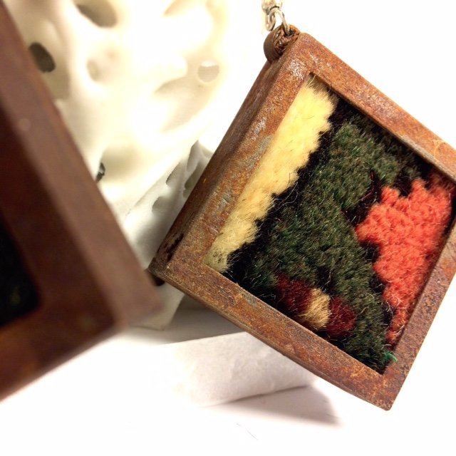

We also tried out the @protopasta iron filament trick. The different functions each of these filaments can produce is absolutely amazing!
