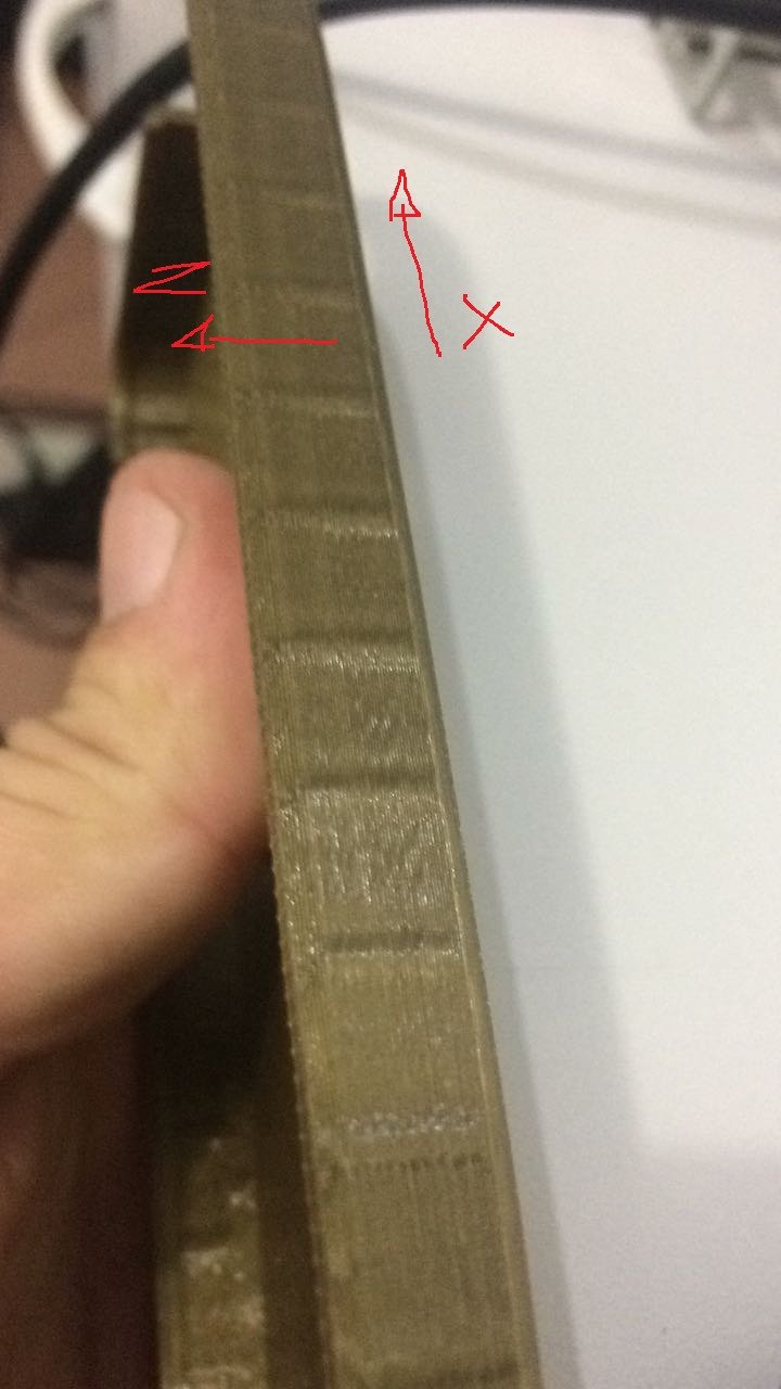

I have a Prusa i3 clone that I managed to get working quite right but there is one problem that I can’t fix : On any straight walls I print I get weird vertical ripples
  1. Things I know
  • It is not due to infill poking through as it happens even on hollow prints
  • I have no problem what so ever with organic shapes
  • My X axis belt might not be the tightest of all be it’s pretty good and my Y axis belt is perfectly tight yet I have this problem on both axes
  • This happens even on straight walls at a 45° angle from the axes
  1. Things I have tried
  • Lowering the acceleration (from 1000mm/s^2 to 200mm/s^2)
  • Lowering the jerk setting to 1/5 of the print speed (was at 20 before that)
  • Augmenting the print speed as I thought it might be due to the way the extruder deposits the plastic (drops - moves - drops - moves - drops - …)
All of the things I tried changed nothing to my problem, the only thing that changed was the pattern of the vertical lines.
So, if any of you have a clue on what could be causing this issue I would be more than happy if you cloud post a comment.

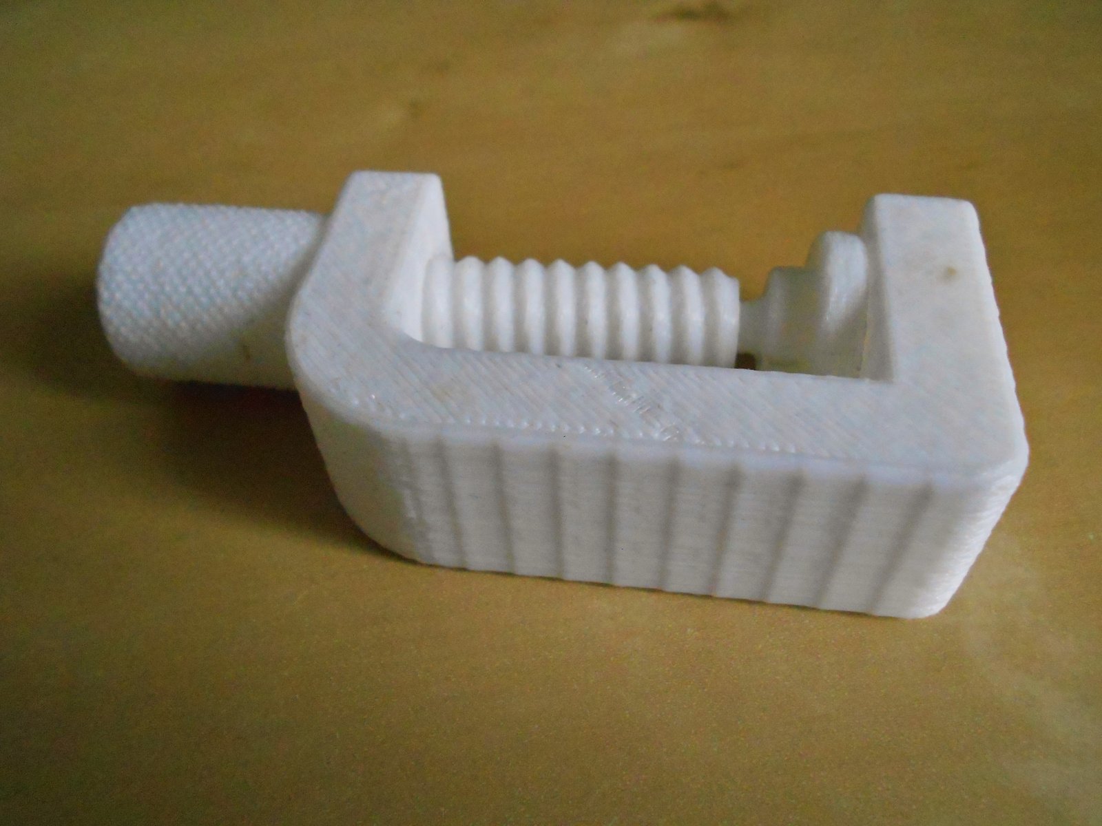

i’m attaching a picture of mine, it appears to be exactly same problem…
i will make more tests, if i discover something, i report here.
thanks again
