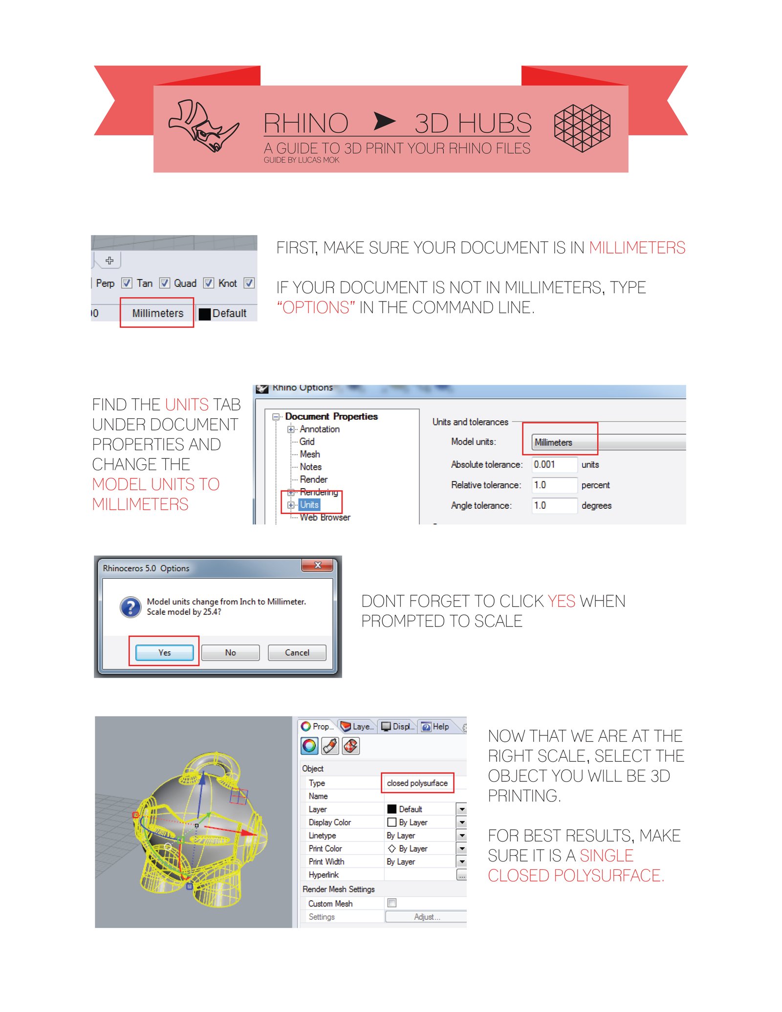

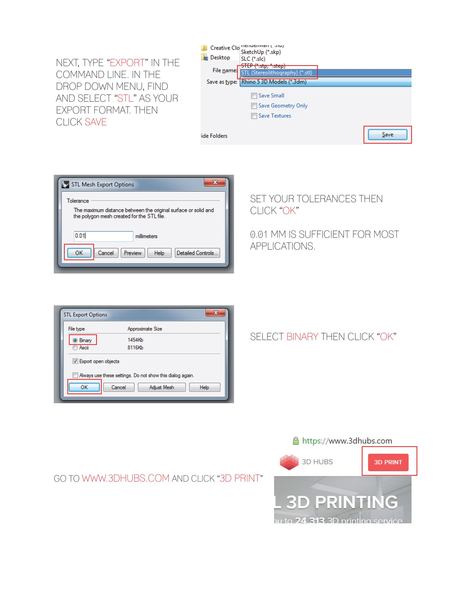

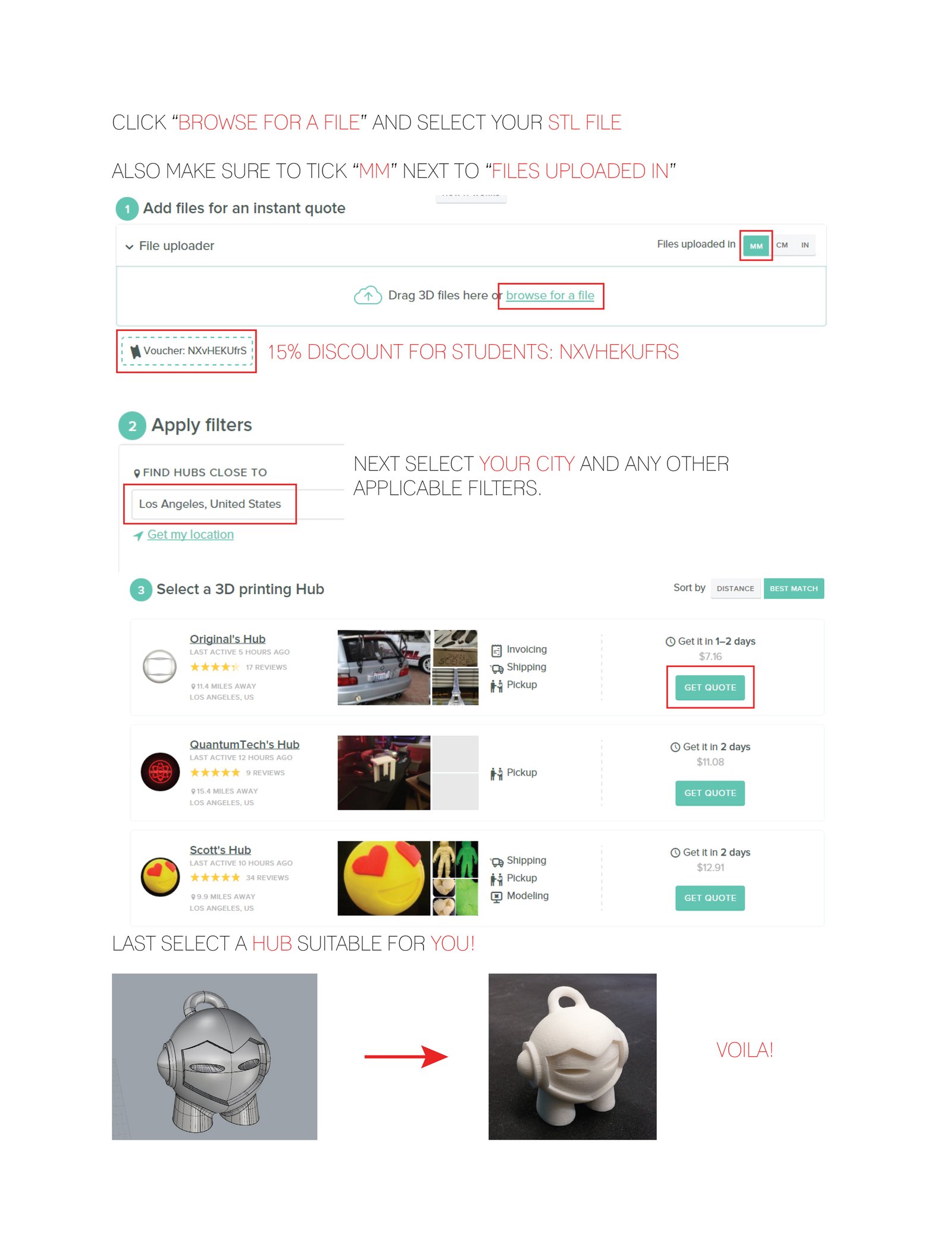

Rhino 3D to 3D Hubs
Export your Rhino 3D models to be 3D printed on 3D Hubs.
