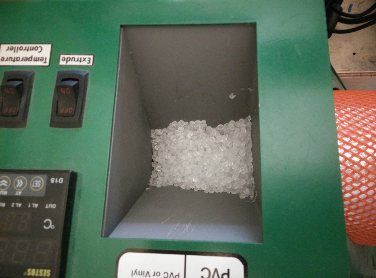

As a first step we decided to extrude and print with new PP pellets. We ordered the pellets through Ebay and used very normal pellets that are more commonly used to fill stuffed animals.

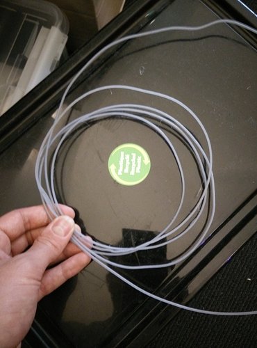

This went a lot better than expected and we actually managed to produce rather consistent spools of filament for extruding at 160, 165, 170 and 175 degrees Celsius. The only problem was that the diameter was on average 2,0 mm instead of 1,75mm which meant we couldn’t use the filament on our Leapfrog.
Luckily we found a part that was thinner which we pushed through the feeding tube using a normal piece of filament which we placed behind it. The filament could definitely be extruded but so far we haven’t had any succes with actually printing an object.

@Emre_1 Hey Tyler, any tips on how to get the right diameter on extruded strings of filament? We considered maybe drilling our own nozzle, with a smaller diameter hole. Any less radical solution maybe?

I think professional extrusion machines, whether its for filaments or sheets control the pulling of the extrusion to get it to the right diameter/thickness. That means that you have to have a winding spool whose speed is controlled and a little faster than the extrusion speed. Some machines even have a laser thickness gauge to have a closed loop control with the winding spool, to have very tight dimensional control. There’s a video a filament maker made showing this, but I can’t find it for the life of me.
Awesome test! We have been playing around with PS (Polystyrene) from Ben and Jerry’s Spoons.
For the filament being oversized that is from die swell. It is the change of pressure from the extruding process. There are a few variables that can be changed to help with the swelling. Extrusion temperature as you noted in your post can change the size, a hotter extrusion temperature can reduce die swell, lower temperature more die swell. With our Filabot extruder we ship two nozzle a 1.75mm and 3mm nozzle, in actuality the nozzles are drilled smaller to compensate for die swell. The 1.75mm is drilled at 1.35mm and the 3mm is drilled at 2.85mm.
To solve the issues of oversized filament I would suggest getting a new un-drilled nozzle and drilling it smaller. The new nozzle should have a hole size of about 1mm or 1.1mm
