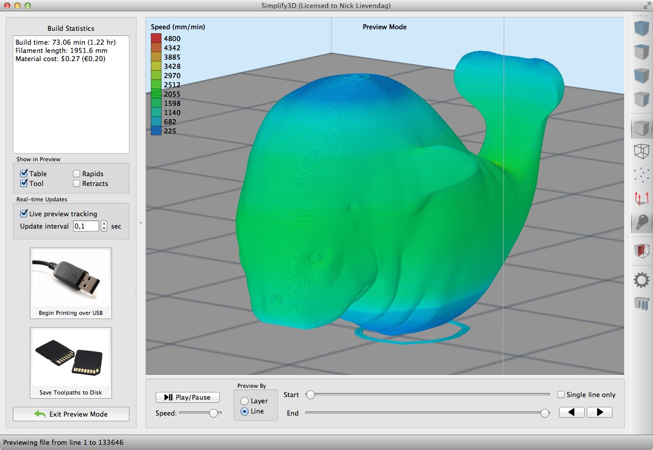

Just did the test!
On import Simplify3D asked me if I wanted to convert the STL’s units to mm. I clicked yes and the size matches your digits (see screenshot 1)
Import took 1 second and slicing was done within 2 seconds on 100 micron with 30% infill on a Macbook Pro with 2.6 Ghz Intel Core i7 processor.
For comparisson: I ran it through MakerBot Desktop and that took 25 seconds to slice on 100 micron.
Nick
By the way: the 25,4% scaling you see was the automatic scaling S3D did on import to get the size correct.

I did some further tweaking on the makerbot at the lab I was at and was finally able to get the desired dimensions, though what I noticed and in the screenshot you showed is that the model orientation changes from what it is from when I export it from zBrush.

It’s true that the orientation can be different from ZBrush, but as you can see in the screenshot you can easily rotate it in Simplify3D. By hitting the Center and Arrange button in S3D after rotating it will always center it and place it on the build plate.

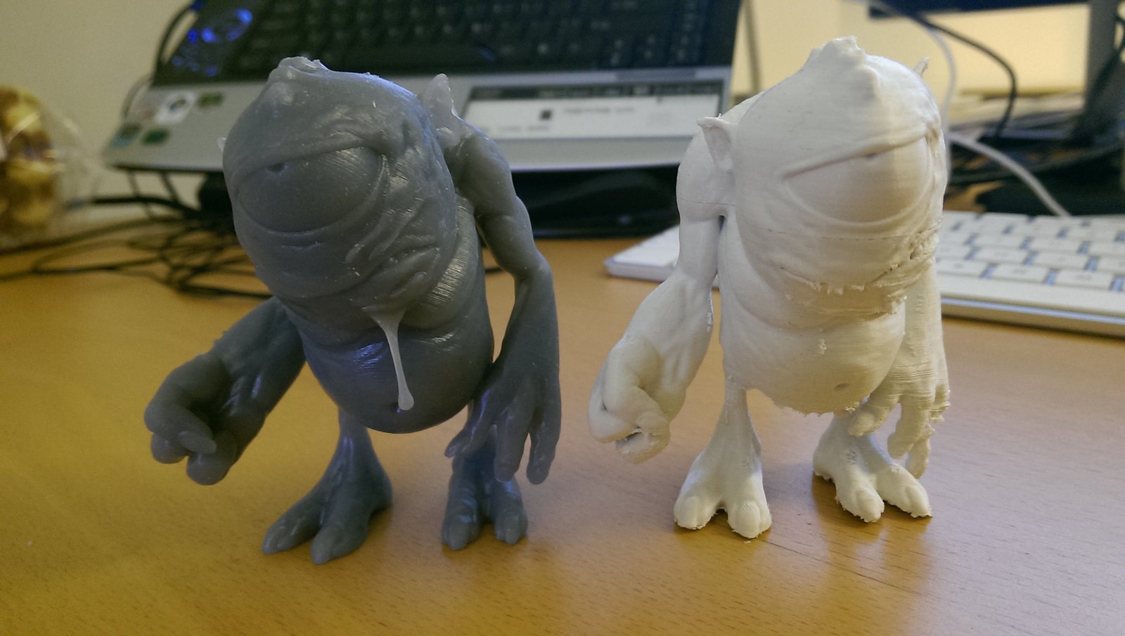

Hi Pandanus,
I saw this Talk and think I might have something to add as well. I’m a regular ZBrush user and have begun printing my sculpts on both on a FDM and SLA machine. I brought my model back from about 16 million poly’s to around 70 K using the decimation master, which is still an incredible tool. Using the the 3D printing exporter within ZBrush I was able to create an STL file that was about 23 mb’s.
For the FDM printer (which was an Ultimaker 2) I used Meshmixer to slice up my model and add supports. (I had quite a few overhanging pieces) There are two main things to keep in mind here:
- What is the most efficient angle to print your model at that will require the least amount of supports
- Support usually leaves traces so think about where you don’t mind seeing these (I used the back of my character)
For the SLA printer (which was an Formlabs 1+) I use the standard program, PreForm with all the standard settings and again made sure the supports were on the back of the character.
Feel free to check out the results of my prints below (the left is the Formlabs 1+ and the right the Ultimaker 2)
I do have to admit that both could be better, but this is my first try on both printers. (The model itself is about 7 cm in height)
