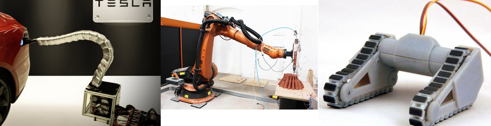

I see you are experienced with robot arms. What do you think about mounting a robot with an extruder? (+ and put it on wheels?) I envision visual calibration by many (cheap) optical sensors like laser, kinect2? Accuracy of 5mm is acceptable for me.
I know real world positioning has become true and will be very accurate soon,. Or am I asking for trouble again ;D

How large do you want the extruder to be? Given you have tolerances of +/-5mm then normal 3d printing won’t work. Sounds kinda interesting, could you make a sketch to explain your ideas and maybe describe the purpose
Why can’t you print with those tolerances? Purpose is mainly for furniture. Inspiration comes from the internet, (see Pictures)
