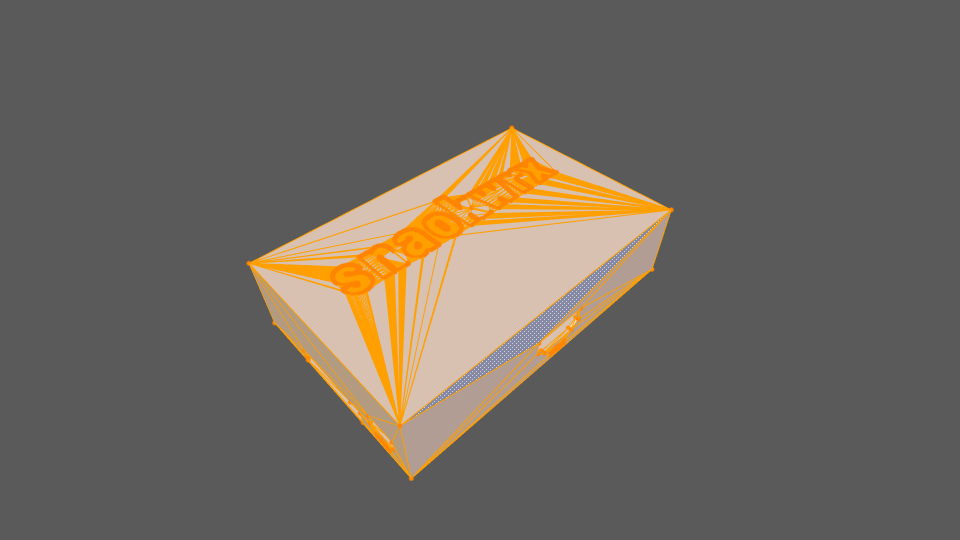

Just out of extra caution, this is what I get with the Boolean modifier after I cut the text. does this look feasible?

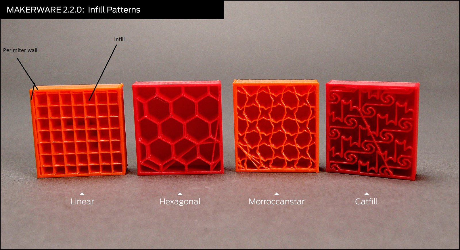

2 Shells just mean the printer prints 2 solid lines for each side of the wall between the perimeter walls is infill. This should be fine for making a case. To explain this better I will find a diagram and attach it. 3d prints are normally hollow on the inside with an infill structure like a honeycomb or linear box. This is done to reduce plastic use and print times. By default, it’s probably set to linear. This infill is surrounded by a thin wall which is the perimeter wall. More shells mean thicker outer wall not the thickness of your part. More or fewer shells dosn’t affect the dimensions of your part.

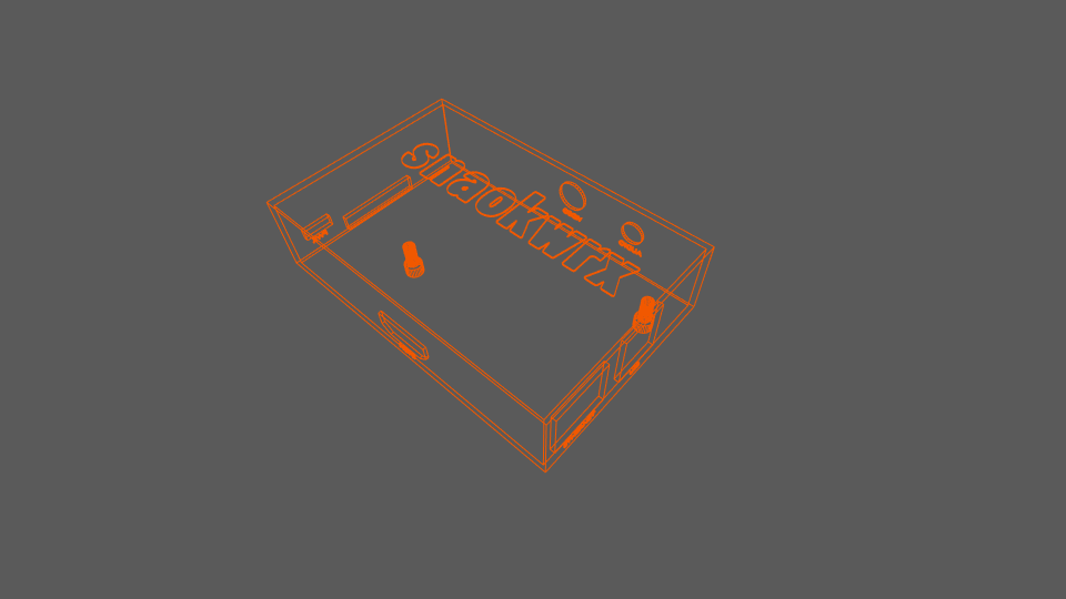

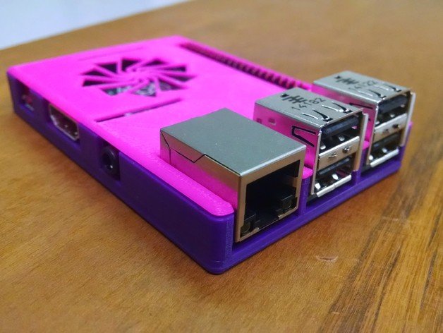

For M3 screws that’s one way of doing it. You could also have the holes go all the way through the part and have the nuts on the outside in a recess. I forgot to mention you could model pegs for the raspberry pi to sit on and have the lid hold it in place like this design.
Form the picture I can’t really tell if it will print or not but I can’t see any obvious problems with it. if you want you can send me your file and I could slice it with Simplify 3d and see if anything wrong with it.

The pins are what I had in mind, but I was thinking of using screws to hold the lid on. Maybe pins to hold the pi in place or something… actually I was thinking maybe some sort of snap,toggle thing. I have not really finished ironing out a lot of the details yet like I wanted the entire thing enclosed. Like the model I now have still has the lid connected, or part of the same mesh.
As far as sending you the model, thanks for the offer but I have to adjust what I am working with now that I’ve learned a bit. That’s good that you think there are no obvious problems, it just looks like a lot of edges/faces/vertices. I have to try and implement these new ideas into the model.

The extra faces and vertices are normal when working with text on a plane so there is nothing to be worried about there.
