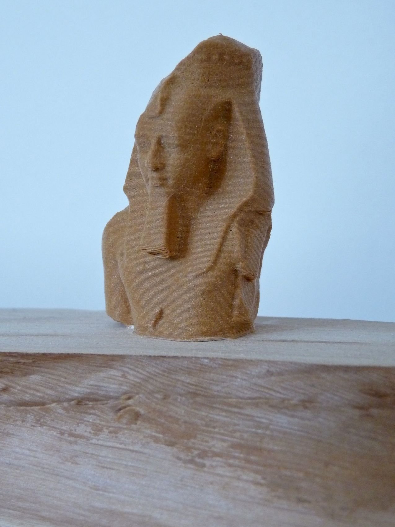

Ramesses II
Printed with Polywood, 210°C, layer height 0,2, slicer Cura, CELRobox.
The polywood looks really nice. Have you tried the woodfill - I believe these are the only 2 ‘wood’ filaments out there?
Btw. Did you get the model from thingiverse or was it made by you?
Hi Gabriela,
No, I did not try woodfill yet. Polywood is 100% plastic, there is 0% wood particle. Polymakr advices to use it like PLA, with just increased nozzle temp and decreased speed rate.
Eloy
The model is from Thingiverse (busts)
