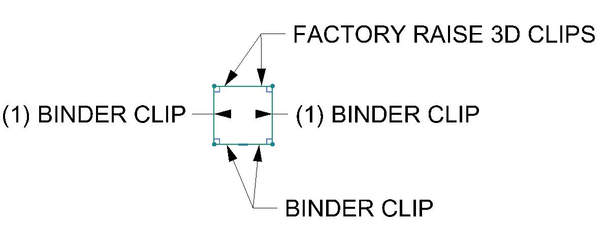

i have the same exact 3D printer and have had the same issue before. How I resolved it was added two more binder clips to the side. Its alittle frustrating putting them on but it has kept it from moving anymore.
I realize its not a high tech fix but it works
I’m assuming your entire build plate shifted though. Thats what happened it my case
Yes, my entire plate shifted, I will try 2 more binder clips and let you know how it works.
Attached is how I have my setup
Thank you so much, this helps a lot.
glad it worked out for you
