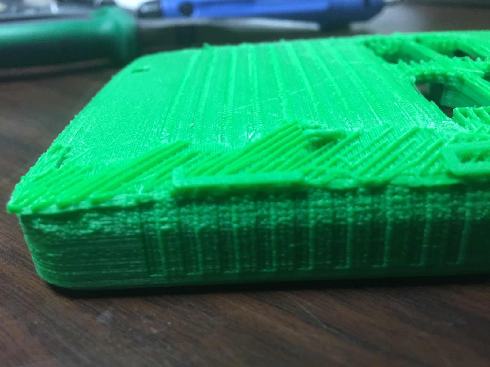

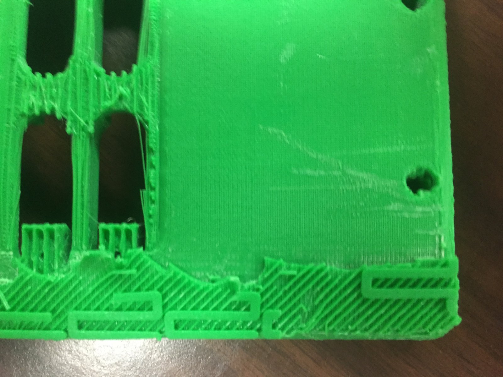

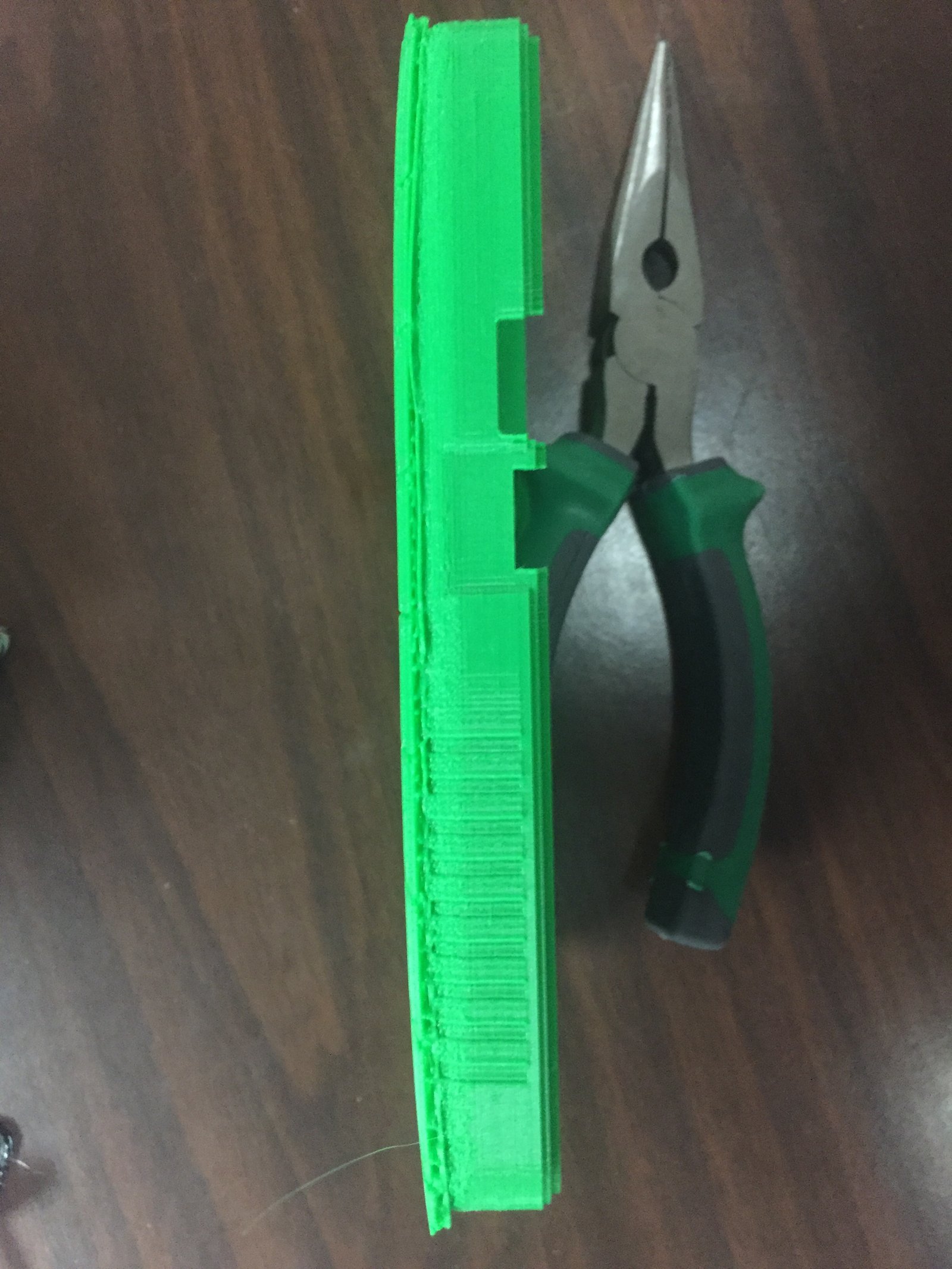

Hi all,
I am working to print a case, but am having trouble with the raft adhering to the print on the edges (see attached photos). I’m using a MakerBot Replicator 5th Generation printer, with RepRapper filament. Have you run into this issue, or do you have any suggestions about how to alleviate the problem?

From the pictures and with your print curling on the edges, I’d probably suggest in the first instance re-levelling the print bed. Don’t trust the in built leveller. Nine days it was level and there was a 2mm difference from one side to the other. I did it using a small spirit level. Then once that’s done in the settings I would increase the raft to model spacing to around .5mm. Next step I would lower the extrusion temperature by 5 degrees. To make sure it’s not too hot and cools in ample time and doesn’t stick to the previous layer.

It looks like your edges are curling up to. Your raft may not be sticking well and curling up and fusing to the case rather than staying separate. You need to get your raft to stay flat the entire time.
First have a look at your settings under raft, and the support to model spacing settings. I seem to get mine perfect every time, it’s almost impossible to not get the raft off. If you’d like, when im

Thank you, everyone, for your responses and help. I am using MakerBot PLA on the fifth generation desktop with the smart extruder and MakerBot Desktop software. I have rarely had an issue with the rafts in the past, and never come across this particular problem. In fact, I have printed other parts since then, and they have come out fine.
The fifth generation has neither a heated bed nor a heated build chamber, and my extruder is running at 215 celsius. Room temp is about 71 F and humidity hovers around 40%. I do need a raft for this part, as it doesn’t stick to the bed otherwise. Just an FYI, the infill is 100%, if that makes a difference.
If you cannot tell from the pictures, this is a case that has rounded edges on the outside. The software notes there should be support around the edges, but what happens is the raft curls up to meet the part.

I used to have this issue but after ensuring that the Z axis calibration is spot on and the bed perfectly level I then slightly increased the gap between the raft and layer 1.
I can now simply pull the raft off.

Wish i read this when you asked but i shall still answer for others that have a 5th gen MakerBot (long live the King).
The issue from your picture, in my more than 15k hrs printing in the last year(i could be wrong still), have fixed that simply by adjusting my Raft to Model spacing which is the biggest thing that can affect your print sticking to the model. PLA looks like it varies depending on the quality/condition of the nozzle which if set to .45 -.75 (model raft spacing to vertical offset) tends to come off easier. Always use a raft with a 5th gen when going more than 50mm high on Z axis (it looks better & wont fall over). I have my travel speed at around 165 all the time. As JhonT said on the temp 190-220 is cool an i even go as high as 235 but with some other settings changed. IDK about the 30mm extruder speed thing he mentioned because mine has had many settings. Mine is currently set to 55mm/s, 1st raft layer cooling speed 67%, 28mm/s 1st raft layer speed, 2.86mm raft size, 0.69mm raft to model vertical offset.
