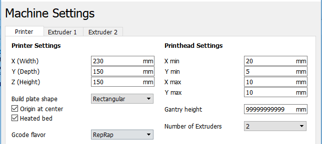

I’ve been printing with this machine for about a year or so now and I’ve really enjoyed it, but I’ve felt that the quality and complexity of my prints has been held back by the older slicers that came on the SD card.
A while back I tried using Cura as a slicer but ran into issues and resigned myself to my fate of using the most up to date version of MakerBot desktop.
Recently after more research I think I have most of the problems worked out using a newer version of Cura (3.2.1). However, I’m running into one final issue that I can’t seem to get passed; my printer will heat all elements to the specified temperature, but when the print begins, the temperature is set to 0 and everything starts cooling off.
Does anyone have a profile or group of settings that get’s this slicer and printer working in tandem? I’ve seen a lot of examples of the start and end g-code that worked for people, but they haven’t seemed to workout for me.

I have the Exact same problem. Were you able to fix it?
You could try the QIDI version of Cura. Send them an email to get a link to download.
Also, for the Tech-1 Flashprint will work since the machine is essentially the same as a Creator Pro 2016 style.
The most popular choice is Simplify3D but it will cost you.
Thank you. I’ll try flashprint but the engineer in me wants to figure it out… lol
I used the start code from flashforge in cura and it kinda works but gets stuck in the middle of the bed just before starting the print…
Problem is that all start scripts are not the same so parts of the one from Flashprint may not be recognized by Cura.
For instance, Cura may tell it how to heat and wait in one way while Flashprint uses slightly different code to do the same thing.
