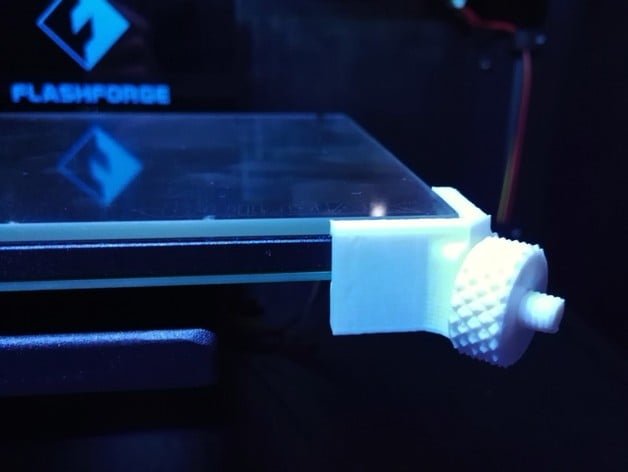

How thick should the glass bed be? Whats best to hold it down?
I used to use I think it was 1/4" borosilicate. There are a variety of holders. This is a good one but use only two. One at opposing corners I found is best.
