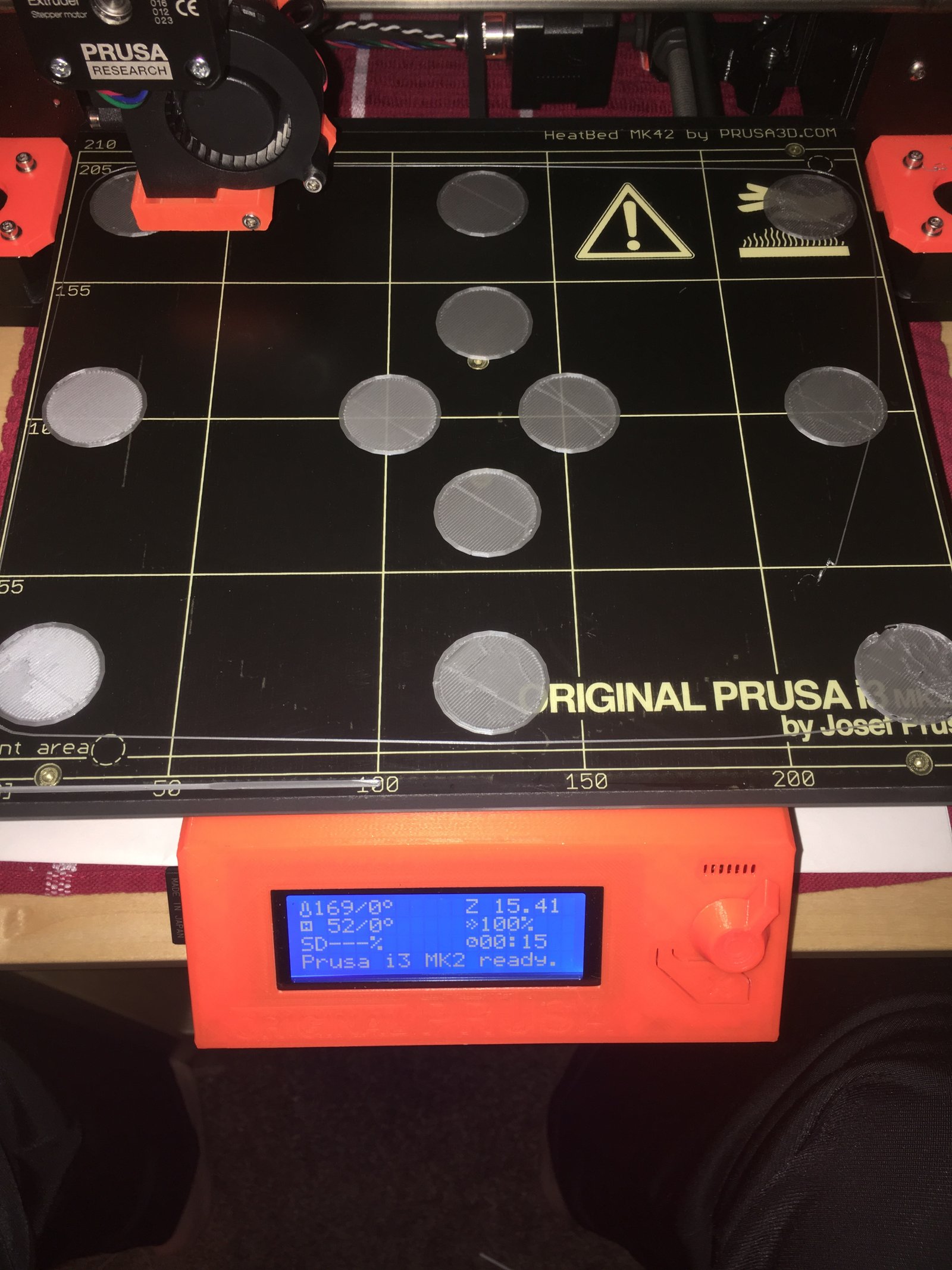

I printed this file and apparently the bottom right corner of my bed is low, and same with the top right and bottom left a bit. I thought the auto-bed leveling was supposed to account for this. If anyone know why this is, please let me know.
It will to a point. there is another leveling that you do manually. It is in the calibration menu right after mesh level I think where you can enter an offset to help account for low spots. Some also try to shim the bed slightly.
