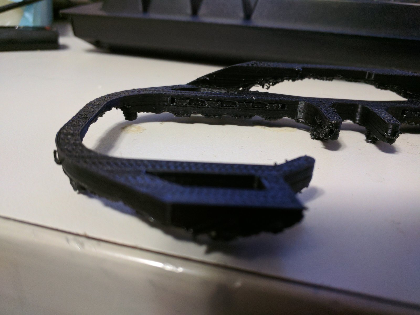

My problem: I can successfully print things however whenever I need to break off supports the area where the supports were is rough and looks terrible
this is what it looks like after I break off the supports. any side that does not have supports turns out great like so.

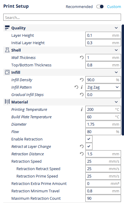

my print infill density is 90% with a ZigZag Pattern
Wall thickness: 1 mm
top/bottom thickness: 0.8 mm
Layer Height: 0.1 mm
Initial Layer Height:

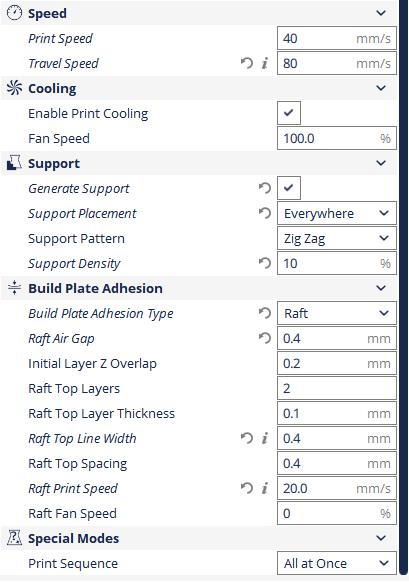

my supports have the following settings:
Support Placement: Everywhere
Support Pattern: ZigZag (I have tried Lines and Grid both gave same results)
Support Density: 10% (I have tried 20%)
