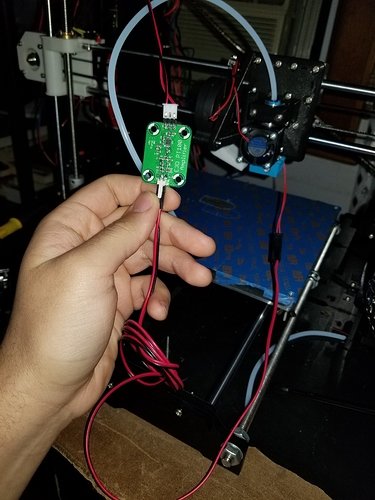

  2. As for the hotend. My issue has been with the Pt 100. I had installed it to the hotend, wired it up to the amplifier,
    and wired it to the mainboard by making a custom DuPont 3 pin female wire. When i Tried testing it gave me weird outlandish temperatures
    when i tried to preheat the hotend, it would stay the same temperature for 20 seconds and give me an error saying “E1 Heating failed.”
    I have a feeling it either might be because of my wiring, marlin configuration or the heater cartridge.
I have pictures that show all the wiring that i had to do and what i had changed on marlin. As for the Pt100, i had changed it to the stock thermistor that came with the V6 and i still had the same problem, Just with a different temperature reading.

Firstly, be aware that you may have a safety feature enabled in your Marlin firmware that prevents the e motor from going if the hot end is not above a certain temperature. Try heating up your hot end to 170 degrees c or above and try the extruder motor again.
That brings me to the second point, did you make sure the correct thermoster has been set up correctly in your firmware? otherwise you may have to ditch the amplifier.
Check out Marlin Anet A8 config · GitHub for some Anet A8 Marlin settings
