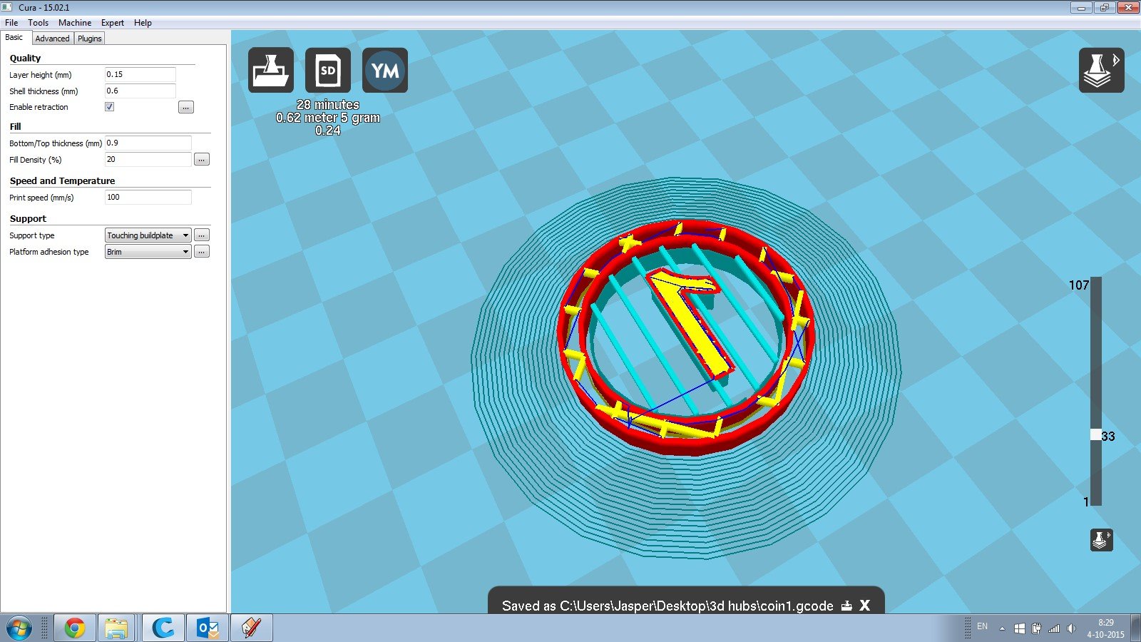

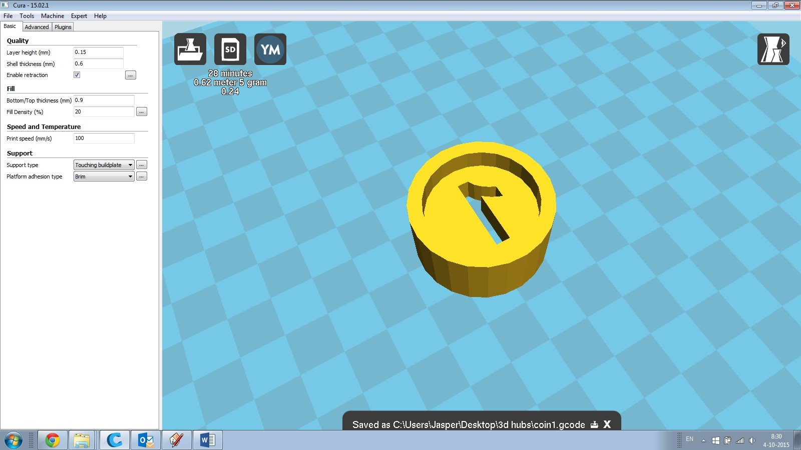

In Sketchup i have draw a coin (see added file) i have uploaded this coin in Cura and want to print it flat.
In Sketchup the ‘1’ is a massive piece. After printing it with Cura its a hollow piece. I took a look in the layerssection in Cura and saw that Cura isnt printing the platform where the one is stamped out. What am i doing wrong? If i rotate the coin so it stands up, Cura IS recognizing the platform…

You might want to try the “expert” tab in Cura,
and try one or both “Combine everything” tabs, (lower right of the menu)
it could be that the object is not completely closed.
http://polaridad.es/wp-content/uploads/2014/12/cura\_expert\_settings\_dialog.png
Hello,
thanks! This was the solution! In all the frustration that i had with sketchup vs Cura i forgot those settings.
