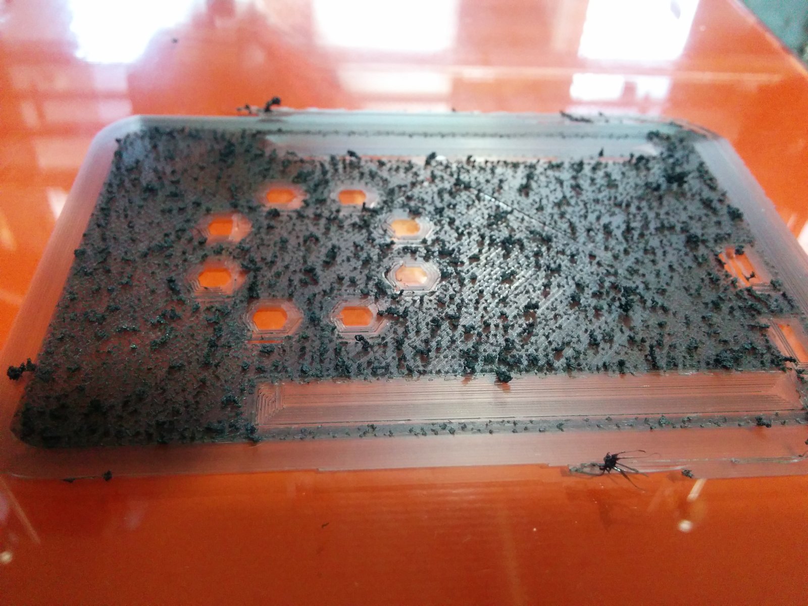

I’ve been trying to print ABS on my new 3dprinter for some time now, however the results are not what I hope for them to be. I’ve attached a picture, below are some of my parameters for printing, hopefully someone has some tips for me on what i’m doing wrong.
It are the intermittent layers that form a problem, the bottom layer seemed to be going fine. As you can see the intermittent layers end up in crumbs.

Hi @arganeon wow, that’s a mess, isn’t it? Can you print with other materials? It’s not easy to tell from the photo, but it looks like those lumps are almost unmelted. How old is the filament? Has it been kept in a dried container?
@cobnut, thank you for the reply, the filament is about a day or 3 old (I don’t know how long it has lived on the shelve though). and was vacuum sealed. I opened it just before printing.
So that can’t be the problem. The larger lumps seem to form out of smaller ones after a while, it seems to be printing some kind of a striped pattern, (so no neat lines). Other material is possible, I’ve got PLA, but I think it has more to do with incorrect settings on my side…

If photo shows the first layer. It looks like the nozzle is too close to the bed.
Do you have a slight “grab” upon a sheet of paper when the nozzle is homed at zero?
Could also be under extrusion or too having the print speed to high, maybe take it down by 5 and try the same print again.
i would soak the nozzle in acetone or force a piece of filament through to clear any blockages, but also check the clearance to the bed it might be too close for first layer. raise the temp to 245 see if that works too
It’s also a good idea If you are changing from PLA to ABS to extrude a large length of filament so to clear the nozzle.

It seemed that (under the hood) Cura set up 80m/s for infill speed, which is far to high for my extruder, besides that also the retraction was set to a wapping 6.5mm by default, which is far to much offcoure.
It seemed to be OK, but after a few layers the problems started again, it looks like the extruder is climbing to fast over the z-axes and the extruder and model are getting further apart. I think this is also the main reason for the lump forming.
Any ideas on how to fix that?
If it is a dual head the chance is there that the second non printing head may be rubbing against the print wiping it away. Your heat is quite high maybe try doing 230 rather and make sure the printbed is 100% level with your axis movements.
107% extrude rate? When you do a solid infill(like those first few layers) where do you think that extra 7% of material is going? Looks like you are getting over extrusion and the extra filament is getting scrapped by the nozzle, eventually causing it to clog/jam.

From the picture it looks like the print bed is 240 deg and the nozzle is 110 deg :smiley:
