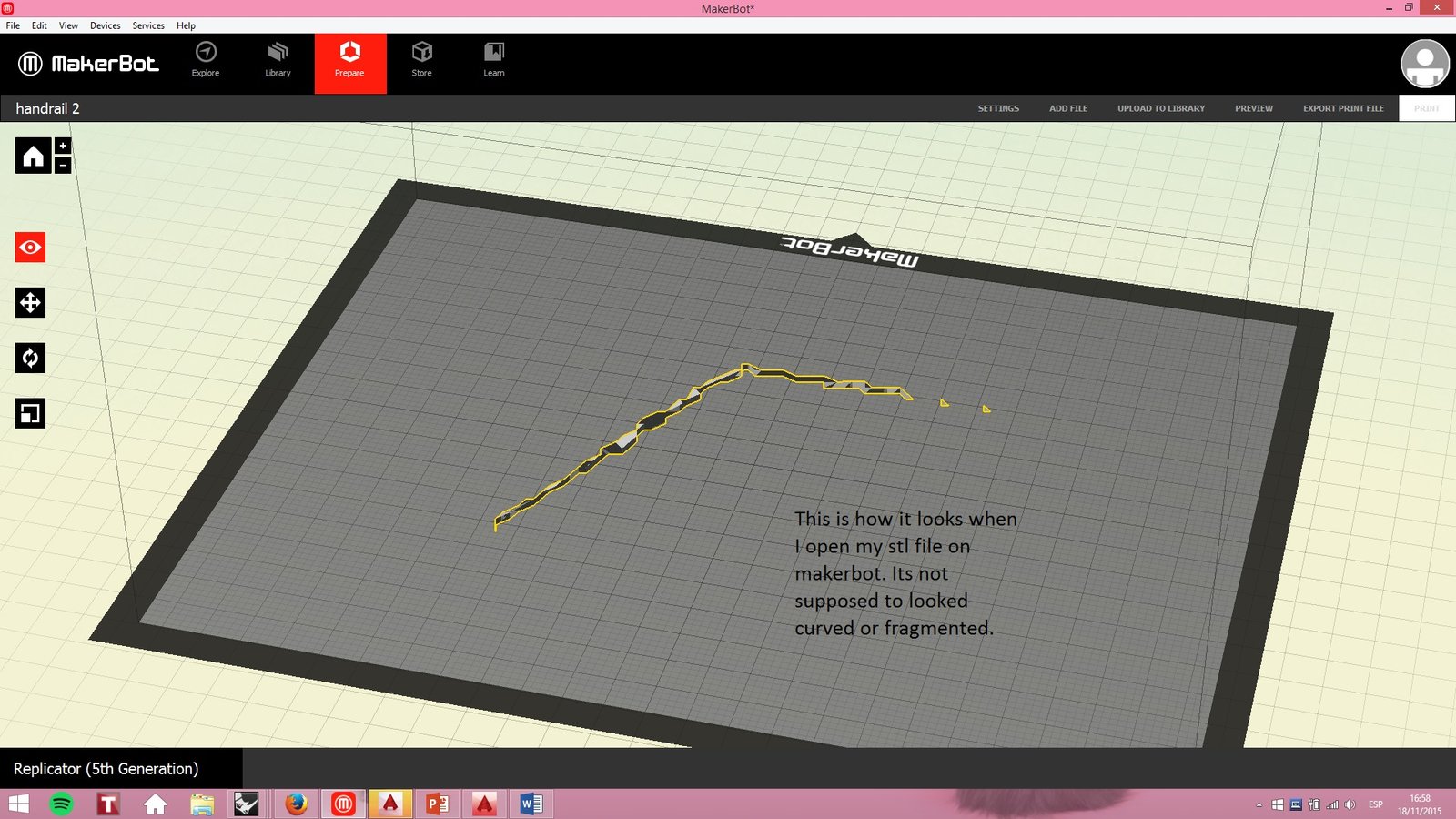

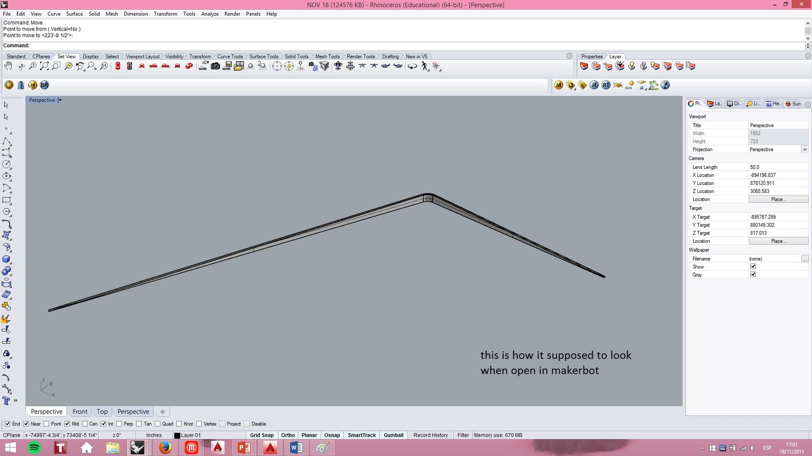

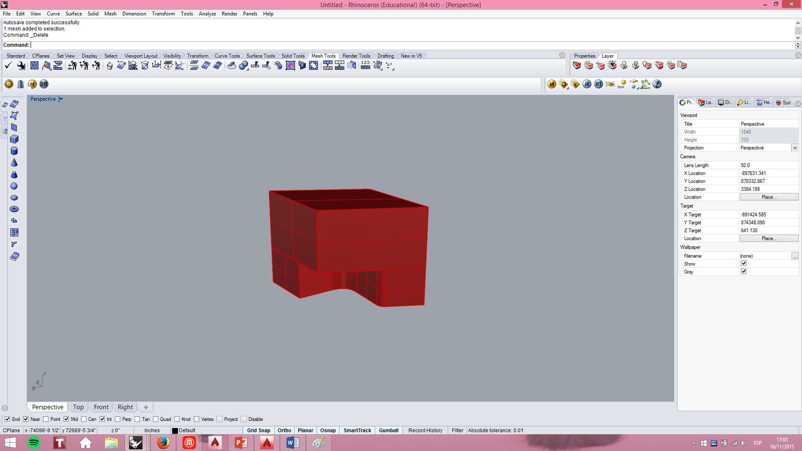

I have been using rhino and the makerbot for 3 months now. However, Im having trouble printing my file on the makerbot. Im having two different problems that I can manage to fix. Everytime I open my rhino file on makerbot it shows some of the surfaces black, and in some other cases the entire model comes out curved and weird… Im attaching photos to explain my problem…

In rhino, do you have your back faces represented as a different color than your normal faces. You can check, in the display tab. Or another option is to run the command “unifymeshnormals”, after you convert your model from nurbs to mesh. Another reson it might be doing that is due to you scaling the geometry, you might want to set your tolerances higher in the ‘units’ panel, from .01 to .0001, this will help with the scaling issue.

Hi everyone! I was able to figure out the problem with a friend. the problem was that I had the model in inches and when i exported to the makerbot and changed the units to mm it stretched the surfaces so much that it damaged the file… So I had to change in Rhino the model from IN to MM and then bring it to makerbot already in MM and now it works :slight_smile:
