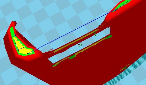

So i took a look in the layer view in Cura and i have something similar to this:
(It’s a screenshot from another case i found on talk).
You see the small lines that are added? That’s the problem.
NetFabb or MeshMixer detect some errors but when i repair it the case gets worse.

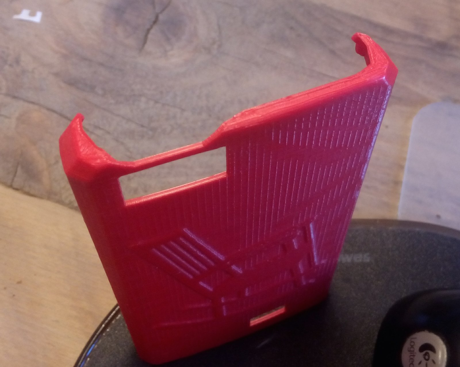

I made a picture of my own case which was printed here at the office. Do you mean the patterns on top of the case that you can see here?

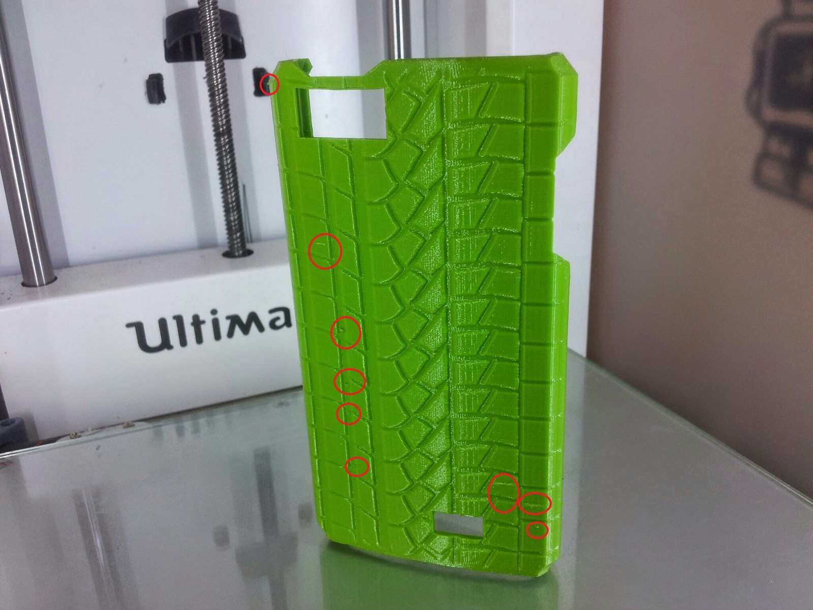

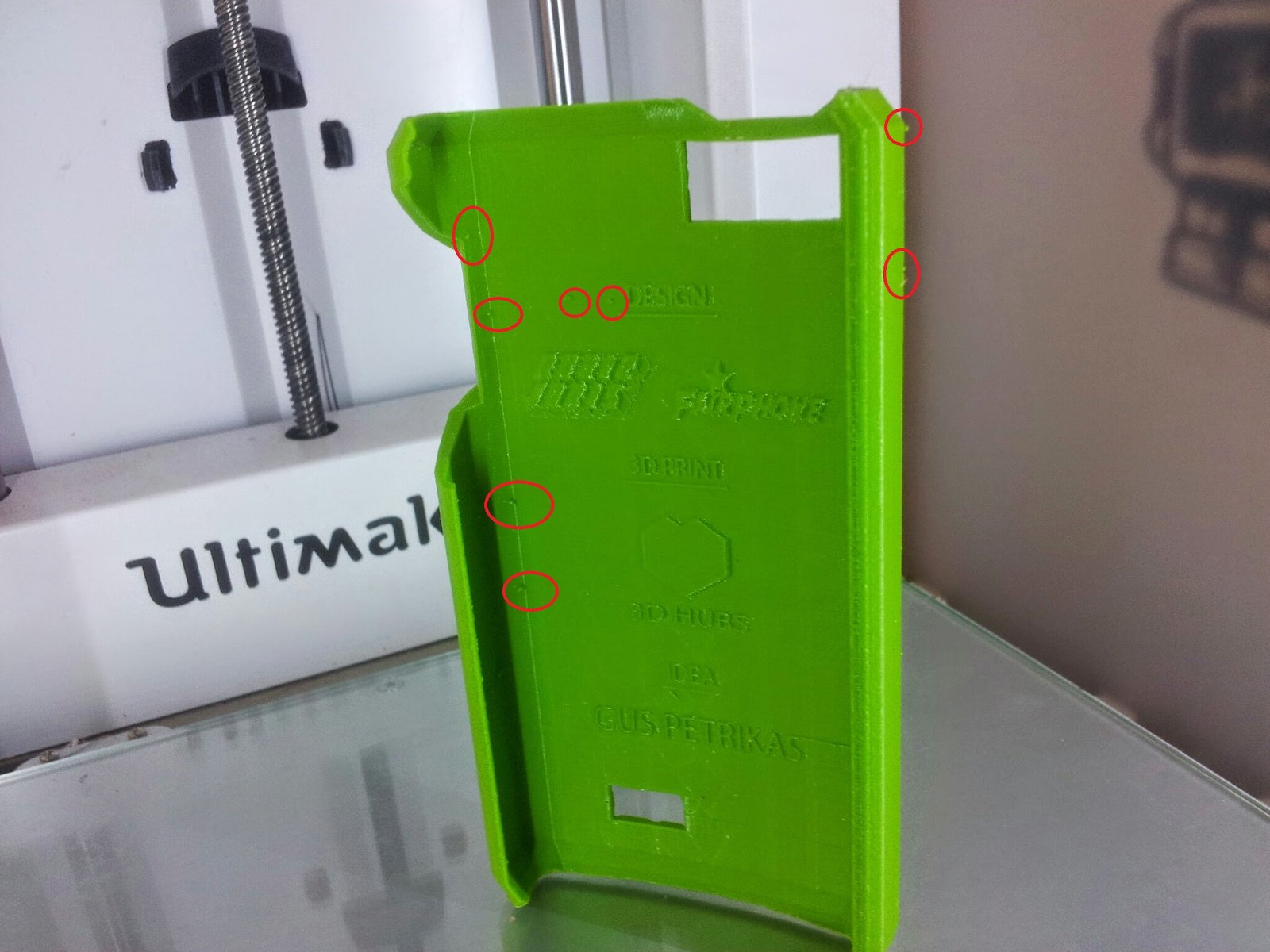

No, i added two pics of my latest Grippy Case, it was cleaned as much as i could but still shows some artifacts, i highlighted them in red.
I can assure you that they are printed and that it’s not a problem with the printer but more with slicing of the STL in Cura. As i said the layerview in Cura shows some added lines there (i will provide a screenshot when i’m home).
So it’s more of a Cura issue with the STLs (although netfabb and meshmixer detect errors). Cura must be doing some kind of automatic repairs that cause this kind of weird behaviour.

Or slice it with Cura and go to layerview to see the extra lines that create the artifacts
