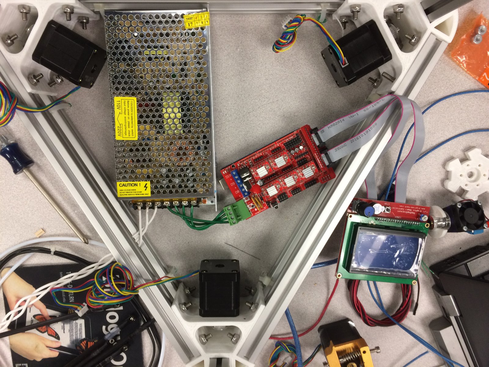

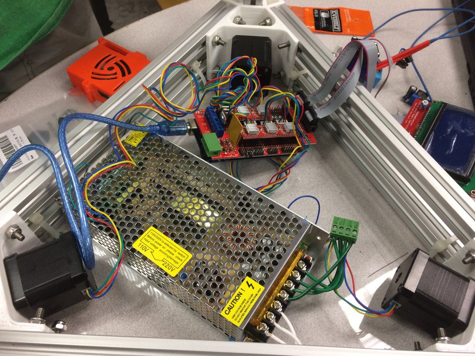

Here’s the photo. And yes we are running on Octoprint. When we press “Connect” it tries to connect and then that error message pops up.
Also just a few moments ago the stepper motor module fried on us. The heat sync melted off with a flame.

You’ve not got any heatbed or extruder connected to the D7,D8 and D9 connections next to the power have you? (as the pictures show nothing connected) If you don’t have anything connected the board won’t draw any major current unless there is a short or major fault on the board. You should have been able to power on the RAMPS board with the PSU as per your wiring without it melting the green power connections. And the fact one of your stepper drivers has burst into flames (!!) suggests there is a major fault! Your Arduino board is probably fried, and maybe your RAMPS board…

I assume this is a 12V system, and the power supply is a 12V supply? What amp rating is it? Switching power supplies should only provide what current is needed - it shouldn’t push all its available current through. If that was the case then yes - something probably would go “pop”! From what I can see in your images it looks correct. Connecting the PSU to the RAMPS board via the green connection is correct, which the RAMPS board sat on top of the MEGA. The RAMPS board will power the Arduino via a power connection which will go through that 5V regulator which I mentioned before on the Arduino. You don’t need any motors or hardware connected just to get the firmware uploaded and the board communicating with the PC. I would leave the Octoprint for now - you need to get the printer working correctly via a PC first.
