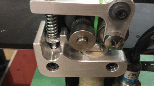

My direct drive gear seems to be stuck or catching on something. I have taken the external parts apart and placed it back together but it still doesn’t seem to want to turn. I have played with the idea that the filament is held too tight, too lose, i changed the type of filament. I even ran it without any filament and all have the same results. I am able to feed the filament through manually so I know the extruder isn’t clogged. I am thinking that it may have something to do with the motor (which I have not taken apart) but I am not an expert.
Any advice would be greatly appreciated.

It might be stuck on the set screw, pull the hobbled bolt out a bit

I took the whole hobbled bolt off, cleaned it, reattached it and tried again a few times adjusting the tightness of the set screw but there was no noticeable change.

Does the motor spin if the bolt is off? The thing is, in my experience, the steppers that Printrbot uses are strong enough that they will sooner strip the filament than start skipping in the case of a jam. I’ve only ever seen them behave like what you show here in the case where the set screw is in such a position that it it colliding with the body of the ALU extruder, which is something that the ALU V2 extruder solves by having a guide for the hobbled bolt to sit in. If you remove the filament and this still happens then I can guarantee you that it is the set screw hitting the extruder body. The only other thing I can think of that would cause it to skip is that the voltage is somehow too low, which would indicate a fault with the printrboard

Have you fixed this issue yet? If not try tightening the tensioning screw I have mine much tighter than that with good results. You can also try increasing the current of the extruder motor through the M565 command. Let me know if this helps.
