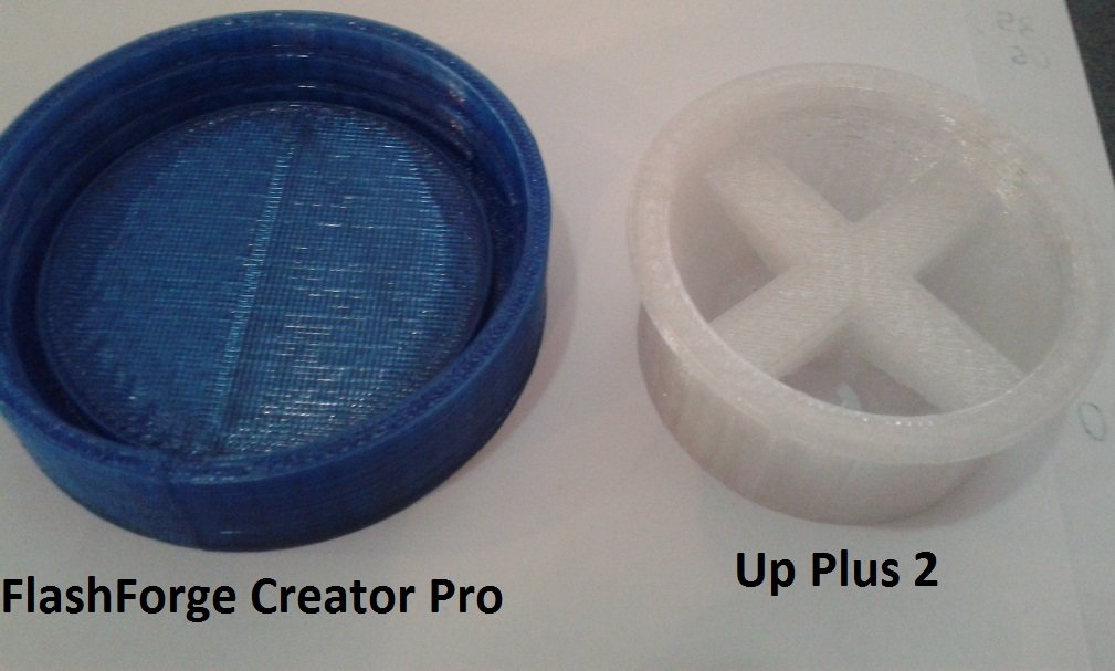

Photo 1 and 2 are of the prints on both printers.

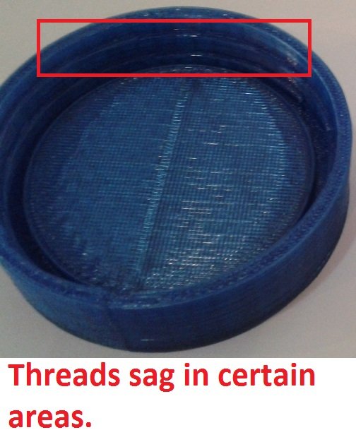

Photo 3 is my problem. Im trying to create a lid for a bottle and the threads inside the cap droop when printed out. Usually with ABS or PLA slight overhangs such as these arent a problem. But because the T-Glase is so much more like “sticky” it tends to be horrible with even slight overhangs and bridging.

Your threads are sagging because you are printing way too hot (Tglase MAX temp is 248 for reprap printing, I can also see you are under or over extruding judging from your layer lines.I don’t have any when I print, it’s solid because I set the extrusion perfectly by averaging 20 different points on the filament down to .005mm …you are also printing your perimeter too fast. The first time you calibrate it, you’ll need to re calibrate the platform height too. Too close and it will pull up the extrusion behind it as it travels, it will sort of curl upwards. Too high and it won’t stick because it doesn’t press into the platform. Remember that part. A good first layer is the key here when you have it calibrated.
One more thing i mised, max layer height on a .4 for tglase is .32, not .35… .35 is for a .5mm nozzle. It said 70-80% of the nozzle size, not the setting. You just increase the setting in addition to the layer height to widen the line
