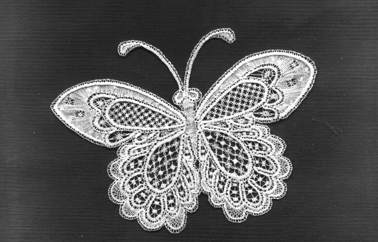

I want to print intricate lace patterns that I will then use to create silicone molds (for cake decoration). Unlike traditional lace, the prints should be rigid as that will make the mold making process that much easier. The patterns tend to be quite intricate (see attachment for an idea).

How big is the item in that picture?
I assume this was printed with some sort of embroidery machine.
Can they not embroider it with a stiffer material?
This one was machine made, yes, but not by me, and I don’t have access to the equipment. I intend to come up with unique designs and then create molds from them. The sizes can be anywhere from 1.5" rounds to long 10" x 2+" bands.
No, no stl file yet, that’s the next challenge. But I will start with a more simple pattern, something to test the relief that I am looking to reproduce.
Thanks everyone for the feedback. It sounds like this is doable, I will test and see with PLA, ABS and resin, but definitely with a smaller nozzle to try and reproduce the fine detail that hand made lace can have. Exciting!
