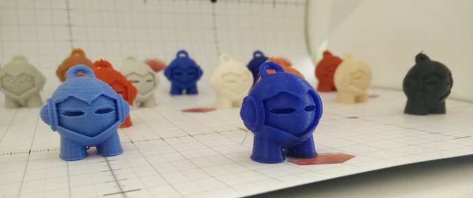

Hi there! I’m Bram and I’ve been stretching the shredding, extruding and printing machines to the limits here at our 3D Hubs HQ. After a lot of experimenting now it’s time to show the results of some serious printing with recycled filament. A sneak peak, this is what your homemade fully recycled PLA prints could look like:

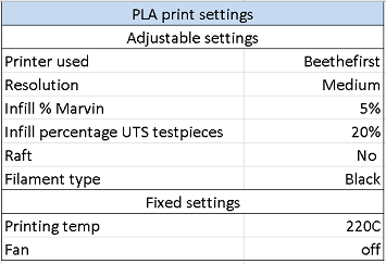

PLA is in general regarded to be more ‘easy’ to print with than ABS. With the strings of filament that I produced I definitely had this experience since printing PLA went super smooth whereas printing ABS took quite a while to figure out. For printing the PLA filament samples I used a Beethefirst printer by the @Beeverycreative company. This printer is very user friendly and produces very constant and good looking prints. Recently an update of the software for the Beethefirst came out that allows you to import and export Gcode files. However at the time I made the prints this was not yet the case so only a few of the settings could be altered.
(Print settings Beethefirst printer)

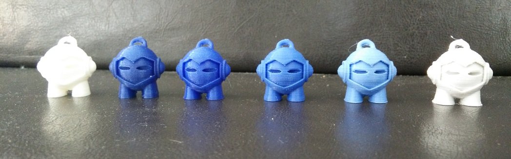

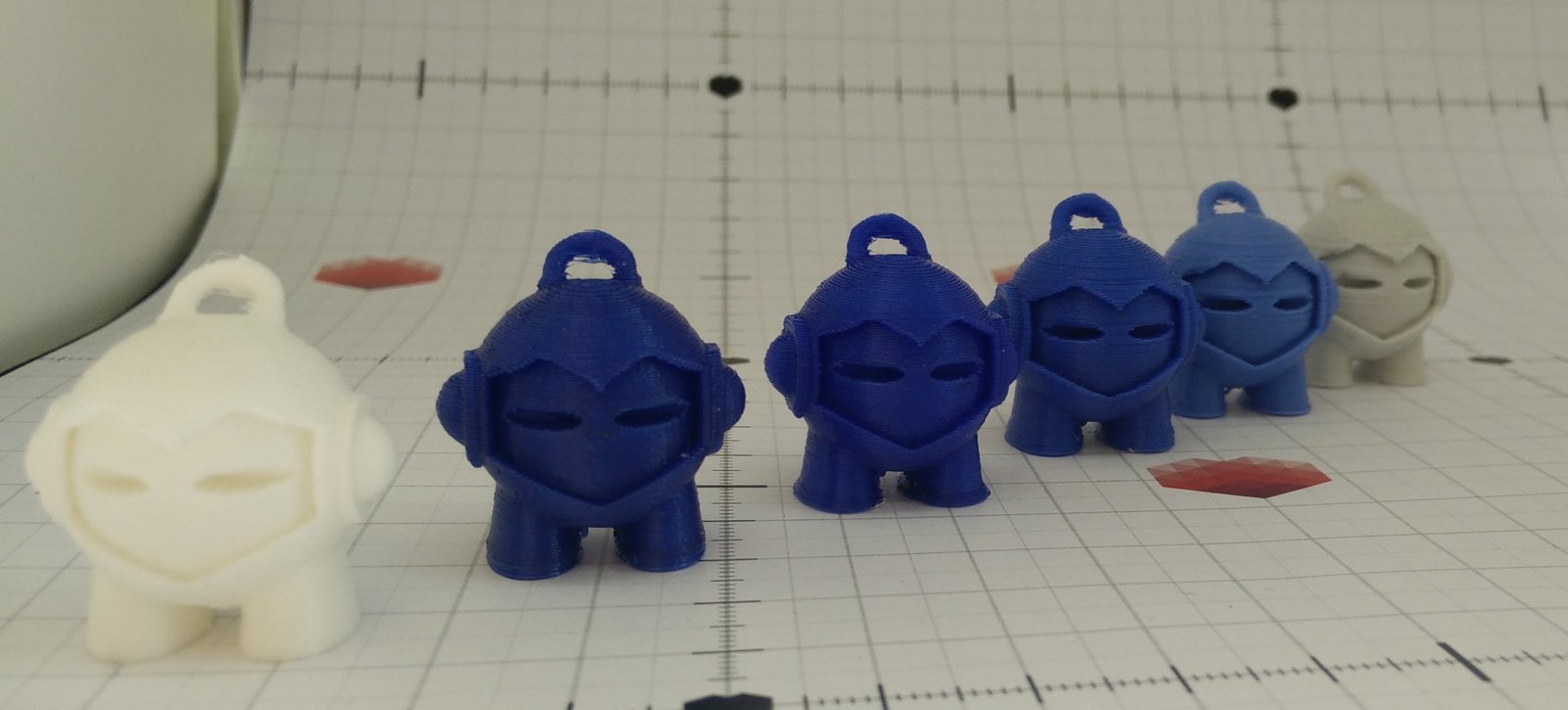

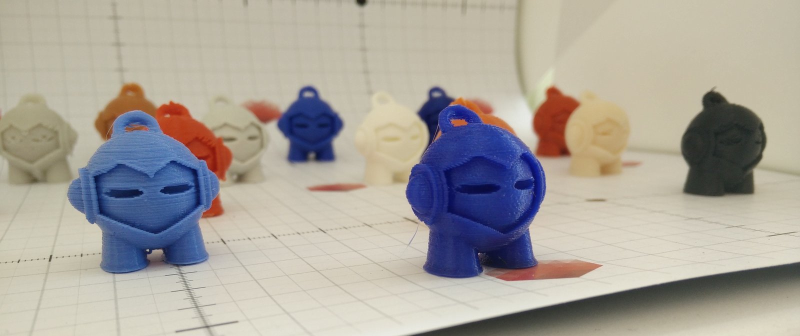

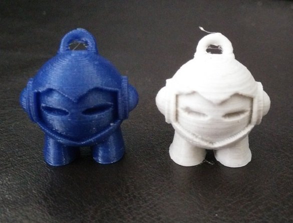

Using the Beethefirst printer I turned each filament sample into a Marvin and into 3 pieces to test the strength of the material. The pellets were blue and the recycled old prints were white and as you can see from Marvins different tints both of these materials mixed very nicely.
(From left to right: new filament, 100% pellets, 75%pellets, 50% pellets, 25% pellets, 100% recycled material)
The Marvins turned out great and to be honest I was surprised by the quality of the prints but even more so by the very small differences between the different prints. The higher the percentage of recycled material in the mix is the rougher the surface of Marvin looks. Apart from this there seem to be no real differences between the Marvins. At least not ones that can be seen by eye. Furthermore all Marvins needed only one cycle to be printed.

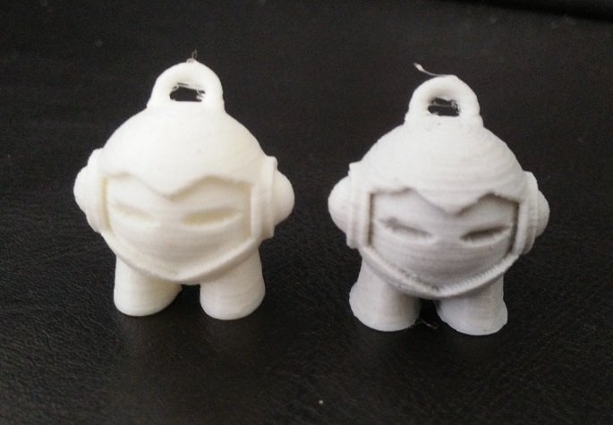

To see the difference between fully recycled and completely new filament I printed two Marvins that used the same original filament. One of them (on the right) had been recycled with the Filabot already once and the other one (on the left) is brand new.
(Left Marvin: 1st cycle, Right Marvin: 2nd cycle)
As can be seen from the next picture the difference between a fully recycled Marvin and a Marvin printed with filament from 100% new pellets isn’t that big either.
(Marvin left: 100% pellets, Marvin right: 100% recycled)

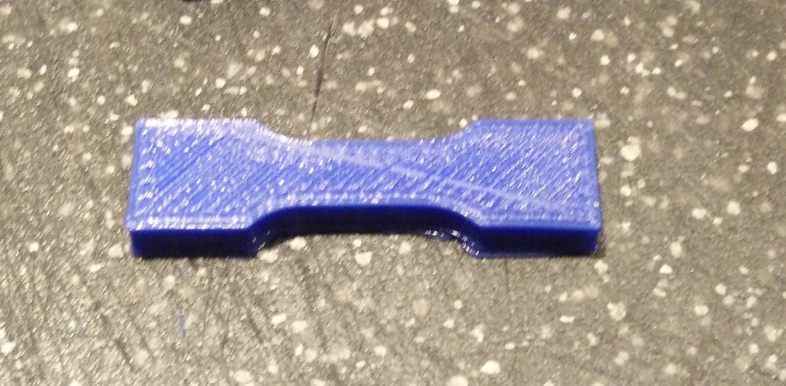

For each filament I printed three pieces that are designed to test the strength of the piece.

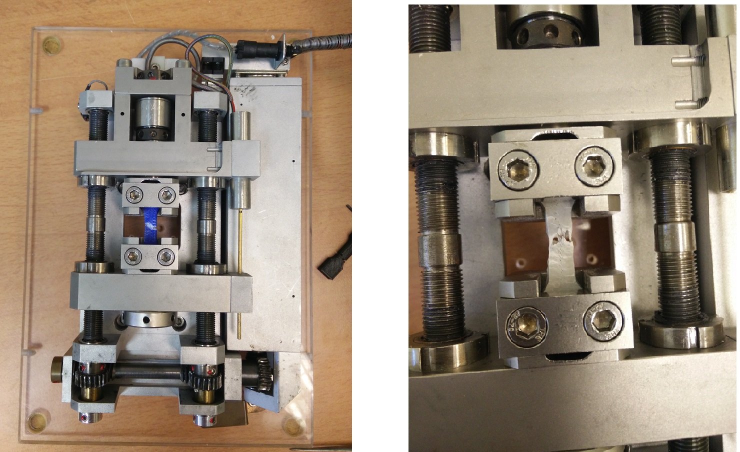

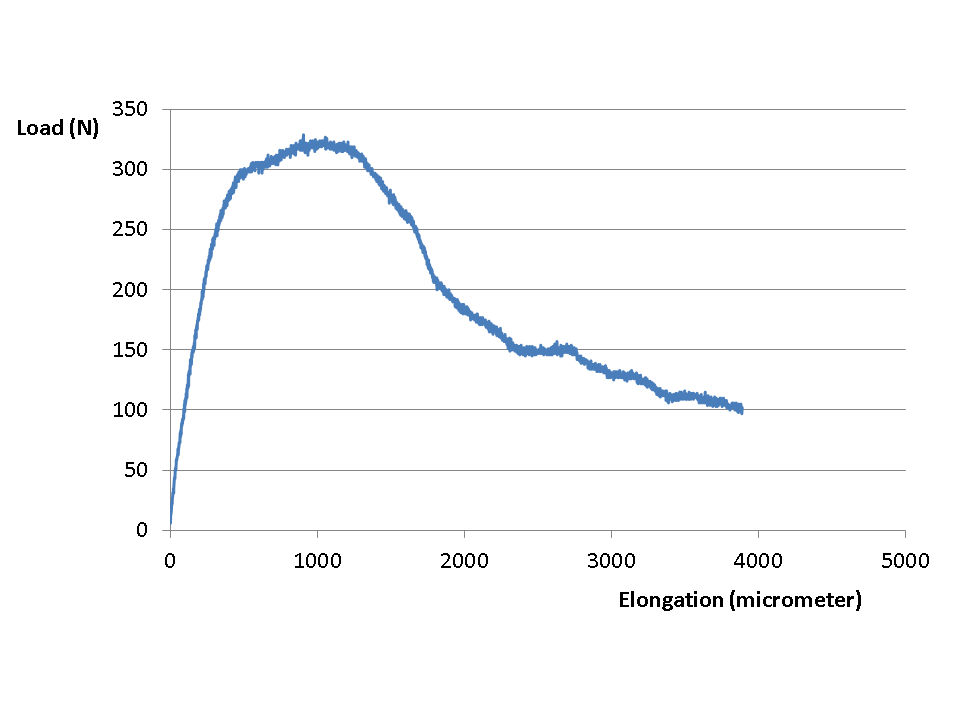

Using an Ultimate Tensile Strength (UTS) testing machine the strength of a material can be measured. The machine pulls on both ends of a part with a constant speed and measures the load that is applied:
(UTS testing machine)

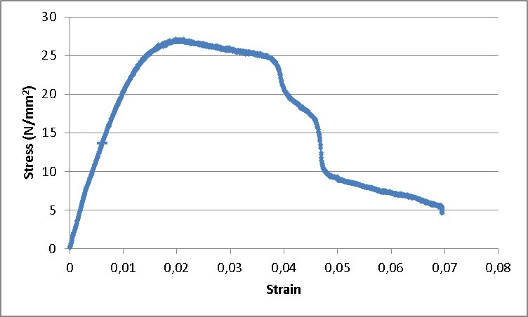

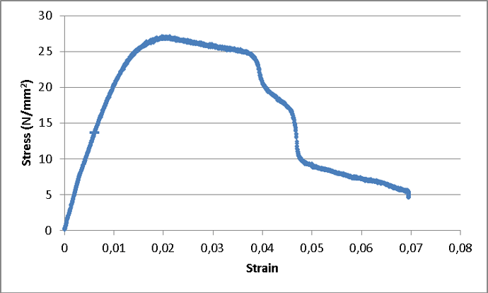

A typical stress-strain curve for a test experiment would look like this:

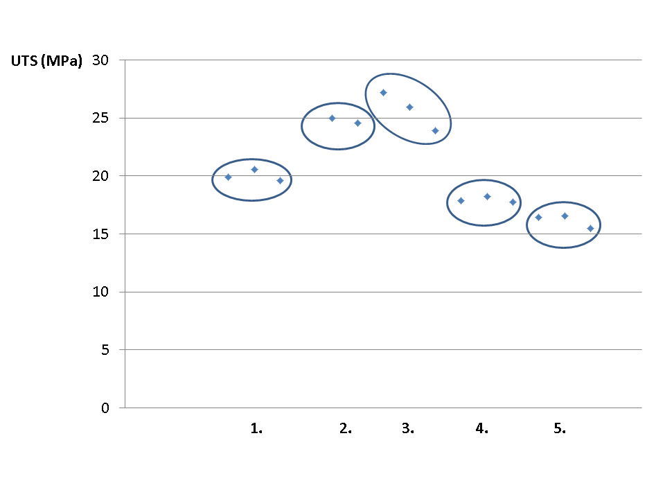

You can see that the load is increased until a certain point after which the load evens out and starts to decrease. The maximum load is used to determine the UTS. After some analysis this figure shows the Ultimate Tensile Strength for the different experiments:
Experiments:
  1. 100% Pellets
  2. 75% Pellets 25% Recycled prints
  3. 50% Pellets 50% Recycled prints
  4. 25% Pellets 75% Recycled prints
  5. 100% Recycled prints

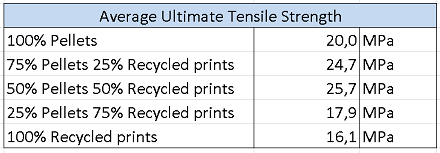

Based on these results the averages are the following:
Conclusions:
  • Excellent printing results can be achieved when printing with filament that is produced by a Filabot.
  • For visual quality of the prints there is little difference between fully recycled filament and filament made from new pellets. However the more recycled material is used the rougher the print is.
  • The strength of printed parts is actually highest when using somewhere between 25% and 50% recycled material in combination with new pellets.

Just curious to why you presented the load vs elongation graph instead of the stress strain curve? Not being critical just curious.
Hi! Good question :wink: there’s no particular reason to be honest but since the stress-strain curve gives a general indication of material strength whereas the load elongation curve only gives info on the specific specimen tested, I think its a good idea to change it. So I will update it with the stress-strain curve!
