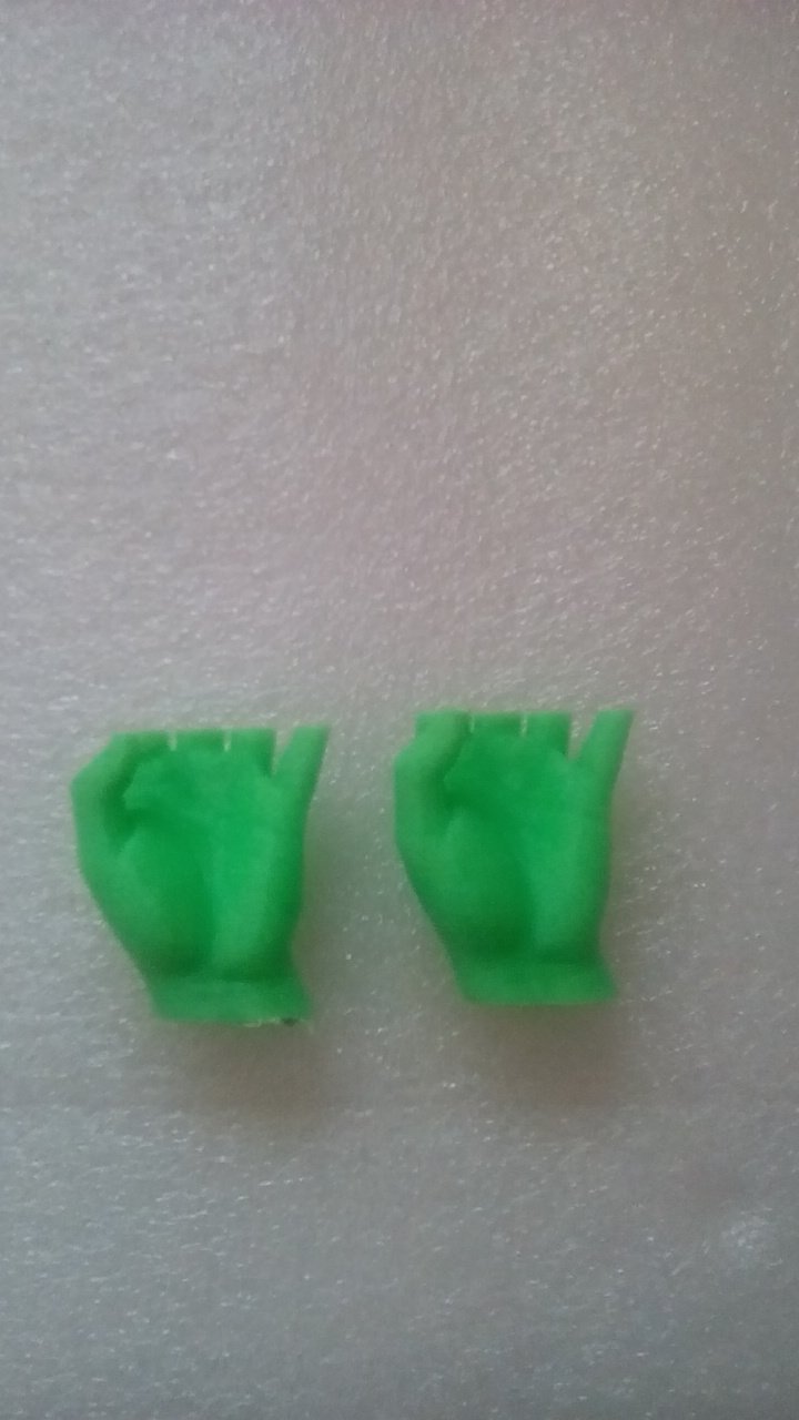

Ive recently purchased a duplicator i3 and being new to 3d printing was eager to try it out. I’ve tried printing the sample from the SD card (twice) and both times it got to 73% ( 35mm) then the 1st time it moved on the heat bed 2nd time, broke of the base. On both accounts it carried on printing. Is there anything wrong me the machine? or me lol

Looks like the bottom right corner of the left Ok hand had issues from the get go. The fact that it carried on printing is understandable, since the printer believes the part is still there. These printers need perfect bed leveling. If not there will always be issues like that.
