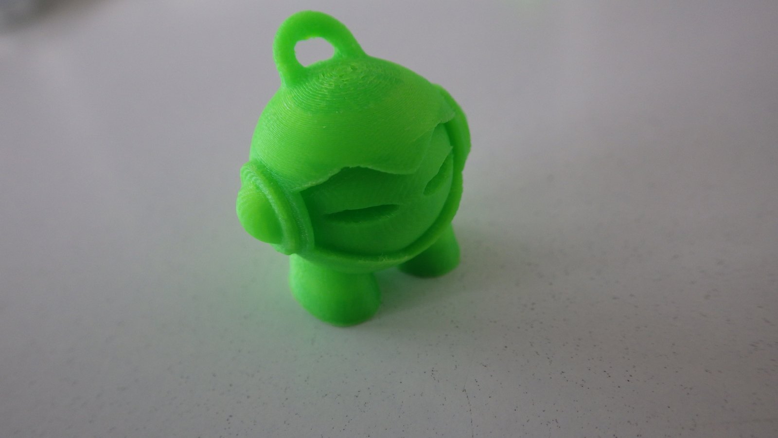

Hi all! I want to share with you my Italian Marvin!
My 3D printer is a @Sharebot NG. I’ve printed this object with a green ABS filament (layer high 0.1 mm, speed rate 20/30 mm/s, print temperature about 230°C ).
Hope you love it!

Was your fan turned on? Did you face any challenges in printing it out?

I turned off the fan.
I found some difficulty printing the top because it was very thin. So I printed at the lowest speed to obtain the maximum quality.

Did it take you long to get to a Marvin like this?
Thank you too!
I tried only 2 times. Printing time was about 30 minutes
Wow! Took only 30mins at 0,1 layer height and 20-30mm/s?
Did you scale it down?
No,I didn’t. I printed it at original size, as the file recommended by 3dhubs
