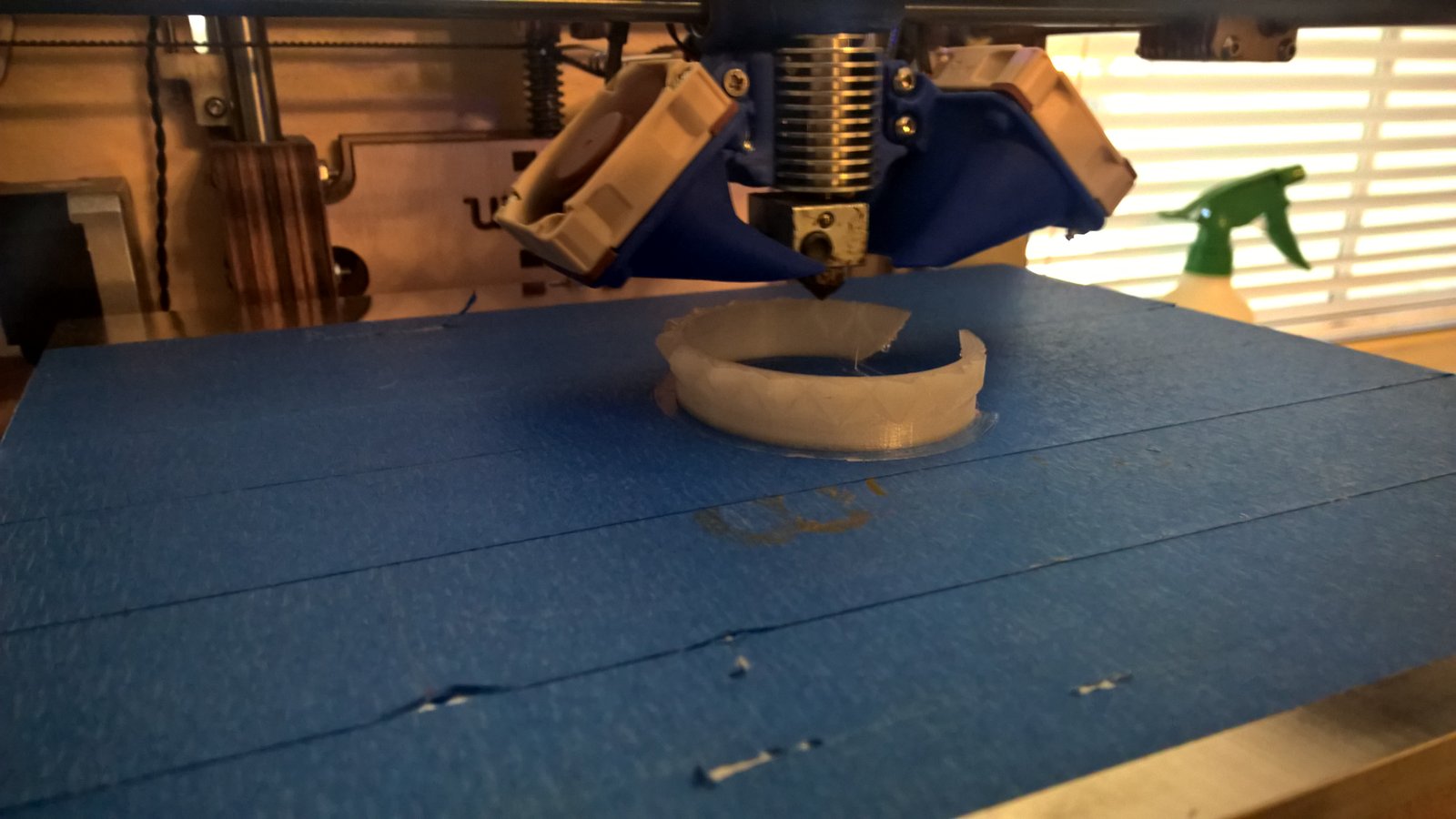

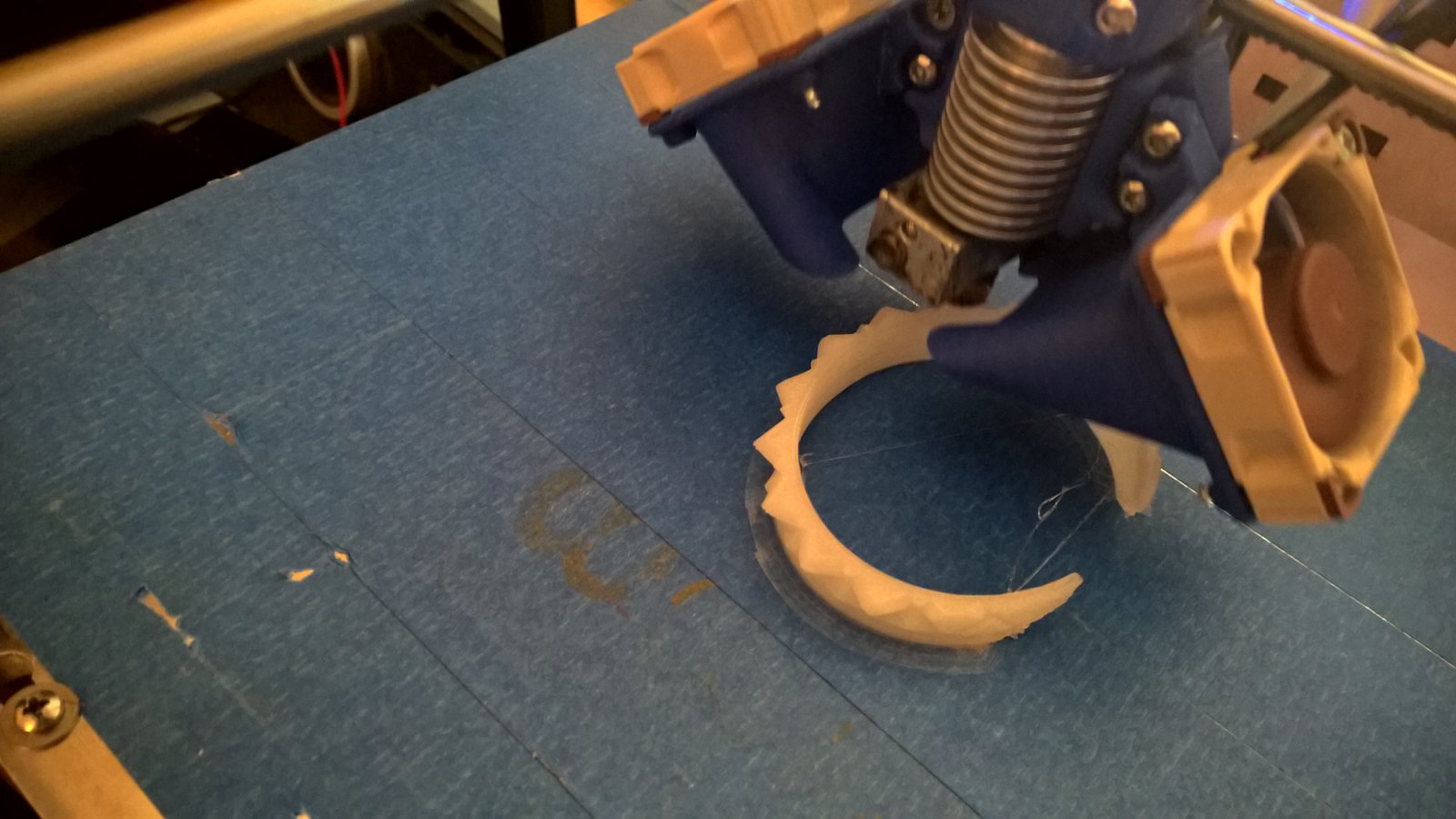

I am printing at .1mm layer height, 235C, 40mm/s, %100 infill and on a cold bed. Using an E3DV6.
So far no issues. Printing is going smoothly. I chose these setting to really test the limit of the material in terms on layer height. I will next run the same print but at .2mm layer height instead of .1mm and then try different infill percents.

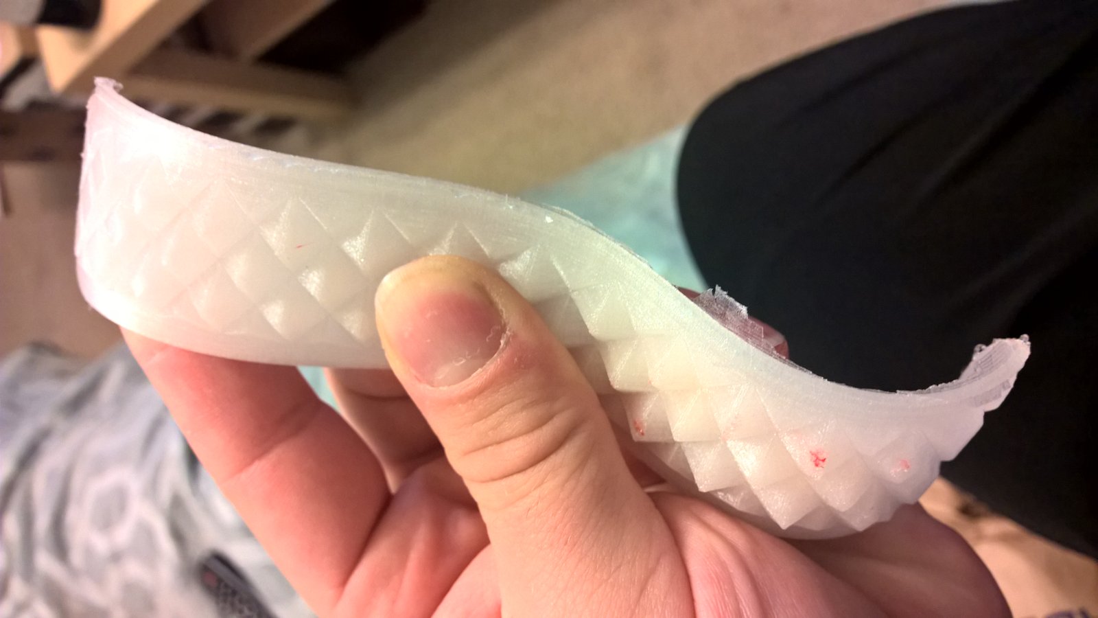

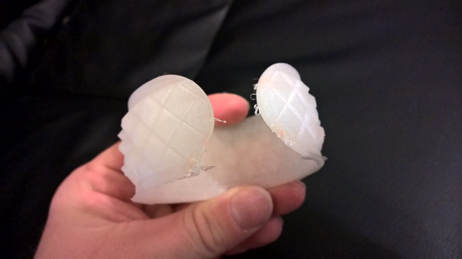

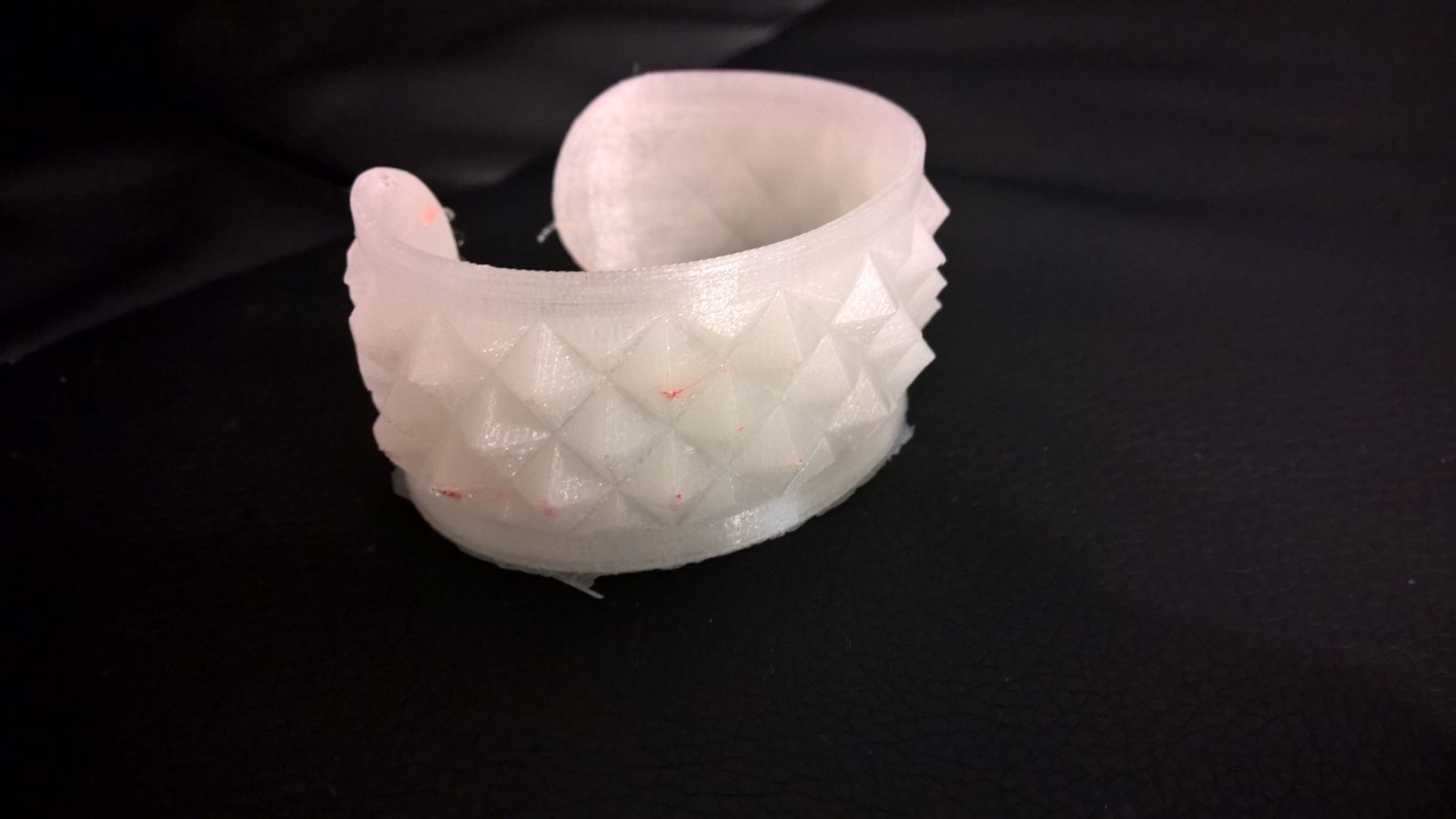

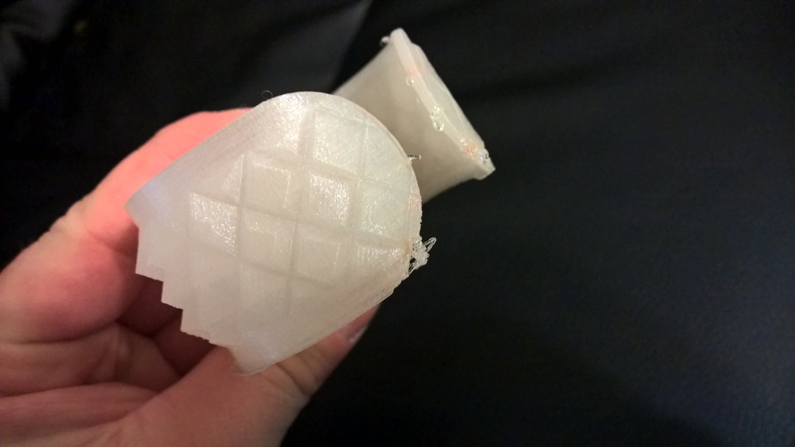

Print successful! Printing time was 3hrs 45mins. Cura estimated it to be 4hrs and 15mins so good to see it finish 30mins early. Other than a little globbing at the break in the bangle no printing issues. I kept my fan off for the first few millimeters then it went on full but I started to notice some curling in the print. I lowered the fan so low it was nearly off, speed at 75/255. I would like to try a print with the cooling fan off the entire time just to see. I am continuing testing the filament but confirmed with the E3DV6 on the Ultimaker on a cold bed with a bowden extruder you can print at .1mm layer height, normal flow rate, print speed at 40mm/s, 235C. I used %100 infill and I have no issues. I printed on blue tape with a brim and it popped right off when it finished.

I’m using the E3DV6 full metal hotend and the ultimaker mount for it I found on Thingiverse that I had a friend of mine print in ABS for me.
