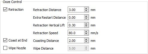

Oh, we’re going to get this working. FIRST, Simplify3d is awesome and you’re awesome for getting it. SECOND, and I say this only because I would hate to see other people yelling at you, but people might tell you to switch your display speeds to mm/sec instead of mm/min. Maybe not, depending on where you live, but if you want to, Tools > Options > Preferences Tab > Speed Display Units. THIRD, and this is just from my own personal experience, but 3000 mm/min (50 mm/sec) might be too fast for the smaller parts you are trying to print. I was printing a dozen small 28mm tall figurines for a buddy of mine, and was trying to print at 50-60 mm/sec, only to find that the figurines weren’t very smooth looking. Maybe try slowing down to 20 mm/sec or less? That may also help with the stringing between the arms and legs. May I ask what your retraction settings are? I spent a fair bit of time perfecting those for my Makergear M2 because I was seeing stringing, over-extrusion, and globs. I finally landed on the settings I’ve attached in the picture, and that also solved a lot of my problems with printing small figurines. Now, your printer will probably require some different settings, but hopefully that would be a good starting point. Let us all know if this helps in any way. And please feel free to ask as many questions as you want!

WOW first off the support on this forum is great! I love the details and @SolarCell007 thx for the unit tip saves me from converting every time! :slight_smile: My settings are below, I love all the options in S3D and am really trying to learn them though I know Cura can pump out some good quality but isnt very optimized and is wasteful (support structure size etc). Should 2mm layer height be good for smaller figures ? I’ve tried 1.5 and 1 but they either clog or dont stick at some point and the printer goes on printing into thin air. Thx both of you let me give theve a try and see what I get.
