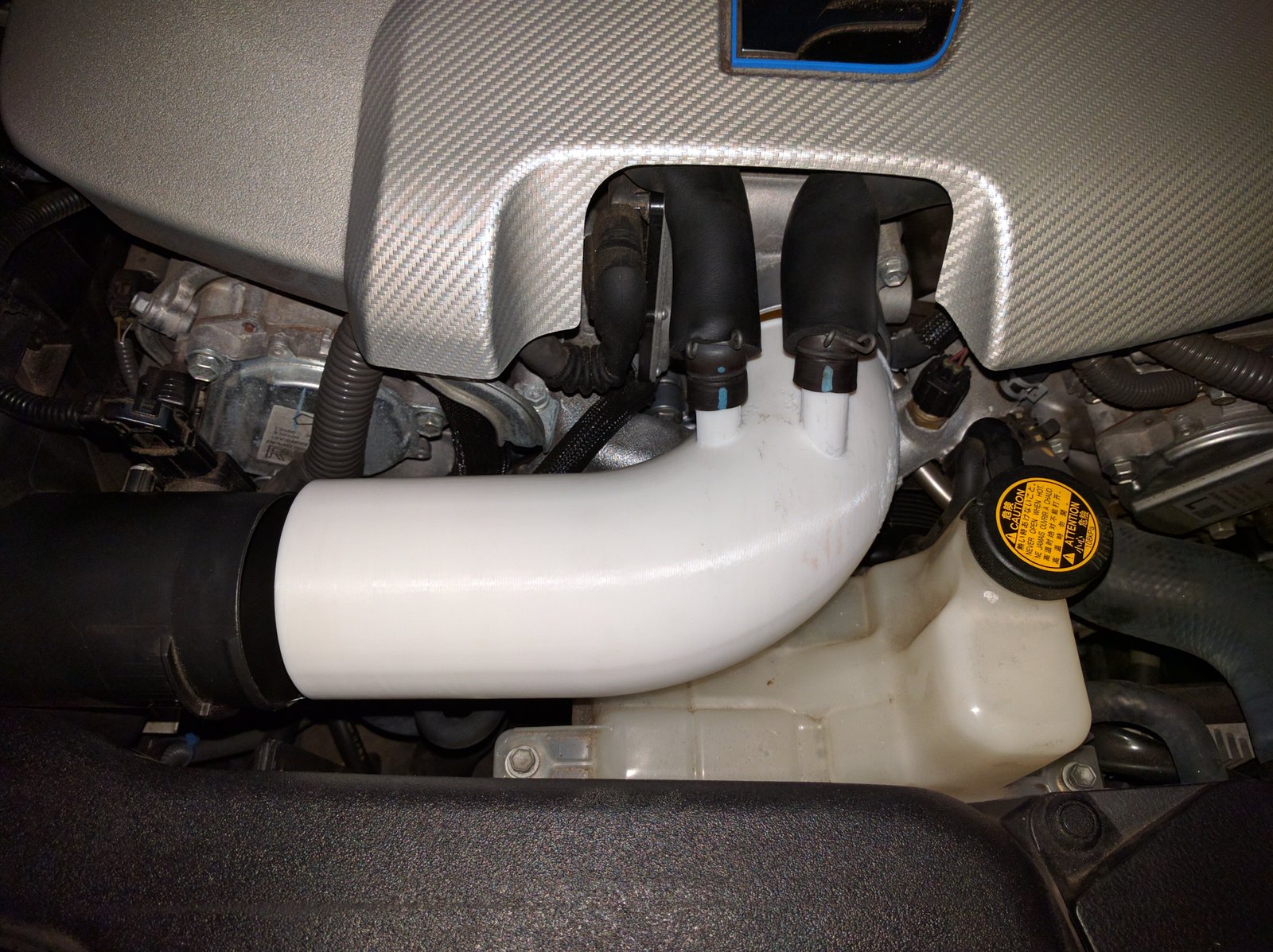

I been playing with the idea of making a 3d printed intake for my car. So far I finished with the design and printed a test fit piece in PLA. Now is time to pick a material that can take the under hood temperatures. Under hood temperature under heavy load will be around 210-220F. What do you guys suggest to print the final intake? Someone suggested Nylon. I did some research and Nylon 66 or PE 66 is used extensively in intake manifolds but I do t think is the same exact material that we can 3d print.

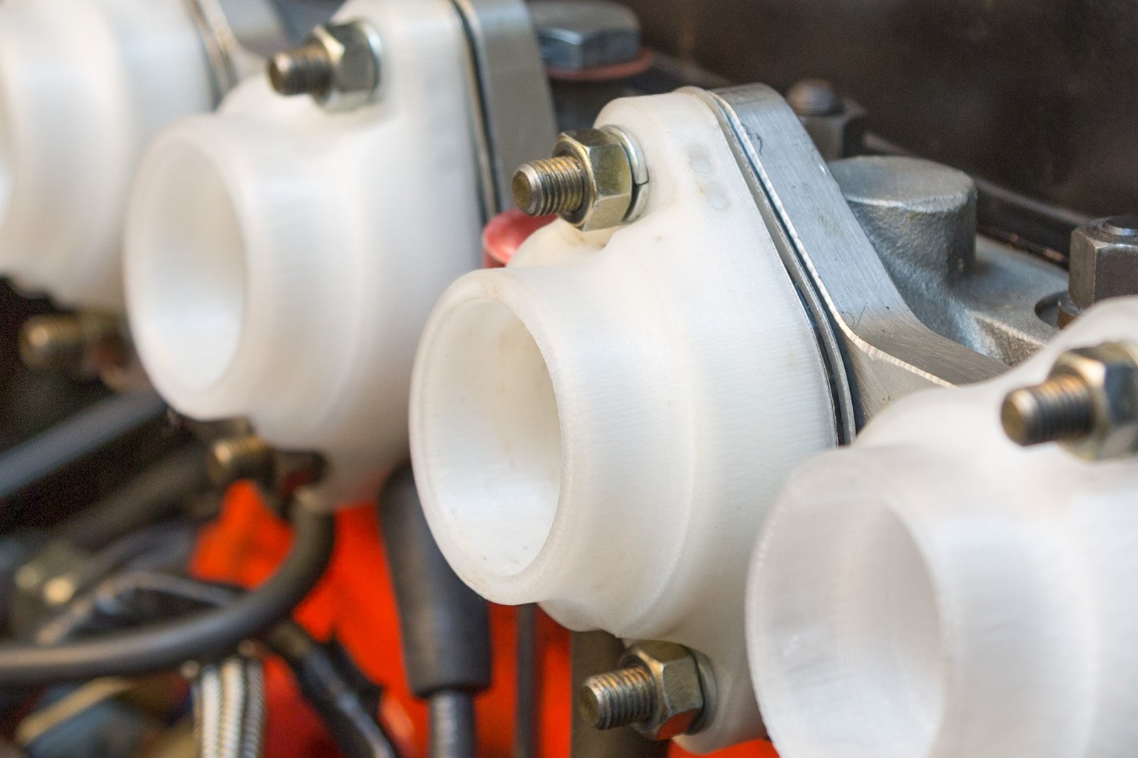

Nice looking part! Our HT material might just be enough for your application, with a temperature resistance of about 100/110C. We’ve helped a guy 3D print inlet manifolds which he has used on a Mini Cooper.

The elbow is not that big. I don’t have the model with me right now but if I remember correctly It is about 11" on the long side, on the short side is about 6" and the diameter is 3.25" OD. I will verify the dimensions when I get home. Let me know if you want me send you the STL file.
Thanks
The dimension are actually 9" x 5" with a 3.25" OD.

Thanks! It’s a little tall for the standard UM2, so I’ve split the part. Let you know how it progresses.
