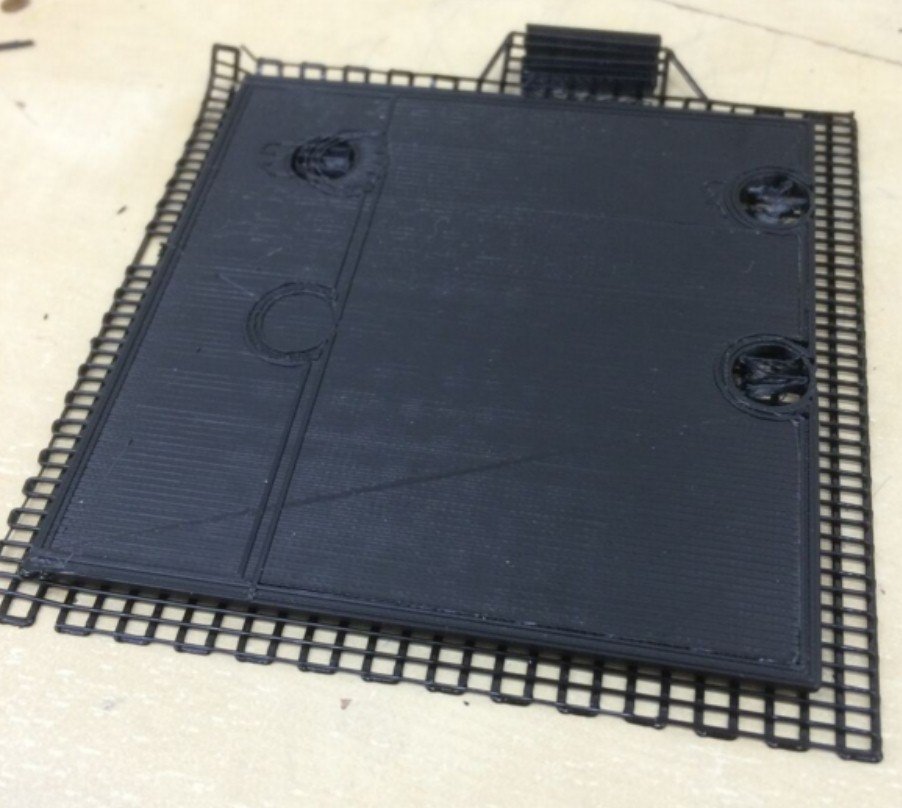

Hi, I recently purchased a FlashForge Creator Pro. Being a newbie to 3D printing I’ve had a lot to learn and still have a lot more to learn. Its been working well when I have set it up correctly, however recently it has started to skip along the X axis. I initially thought that it was a problem with the belt and/or the bearings. The belt wasn’t the problem and I greased the bearings and it began to work again.
However it now is continuing to skip at random points during the print. I was using an ancient computer that just about coped with running the printer. Could this be the issue? I’ve just upgraded to a newer PC and I’m currently running the same print job for the 4th time!
Any help and tips would be greatly appreciated.

Hi thanks for all the tips, I’ve greased the bearing thoroughly and ran a print via the SD card. It was working fine and I came back to check on the print job to find that it had jumped/skipped again. It’s now clear that its not a software issue but a mechanical issue.
I’m really having problems with this printer!
