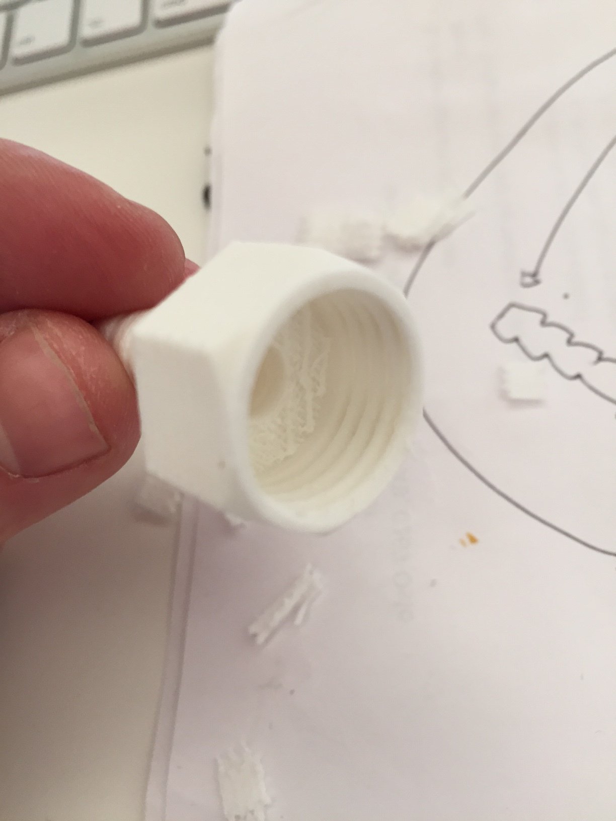

The part that I am talking about is attached below. Don’t have the measurements in from of me, by I assume it is about 2-4 cm in diameter where I measured 5-6% larger on the outside.
