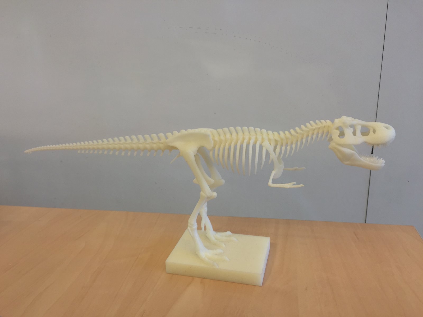

It’s printed actually… But not with GPP! Lots of overhang and complex design which makes it impossible to print with GPP. This print is done with the strong & flexible nylon material group.

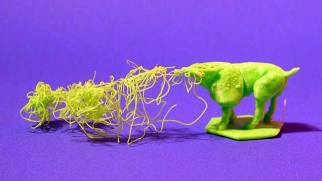

There is a very small chance of success with these sorts of models.

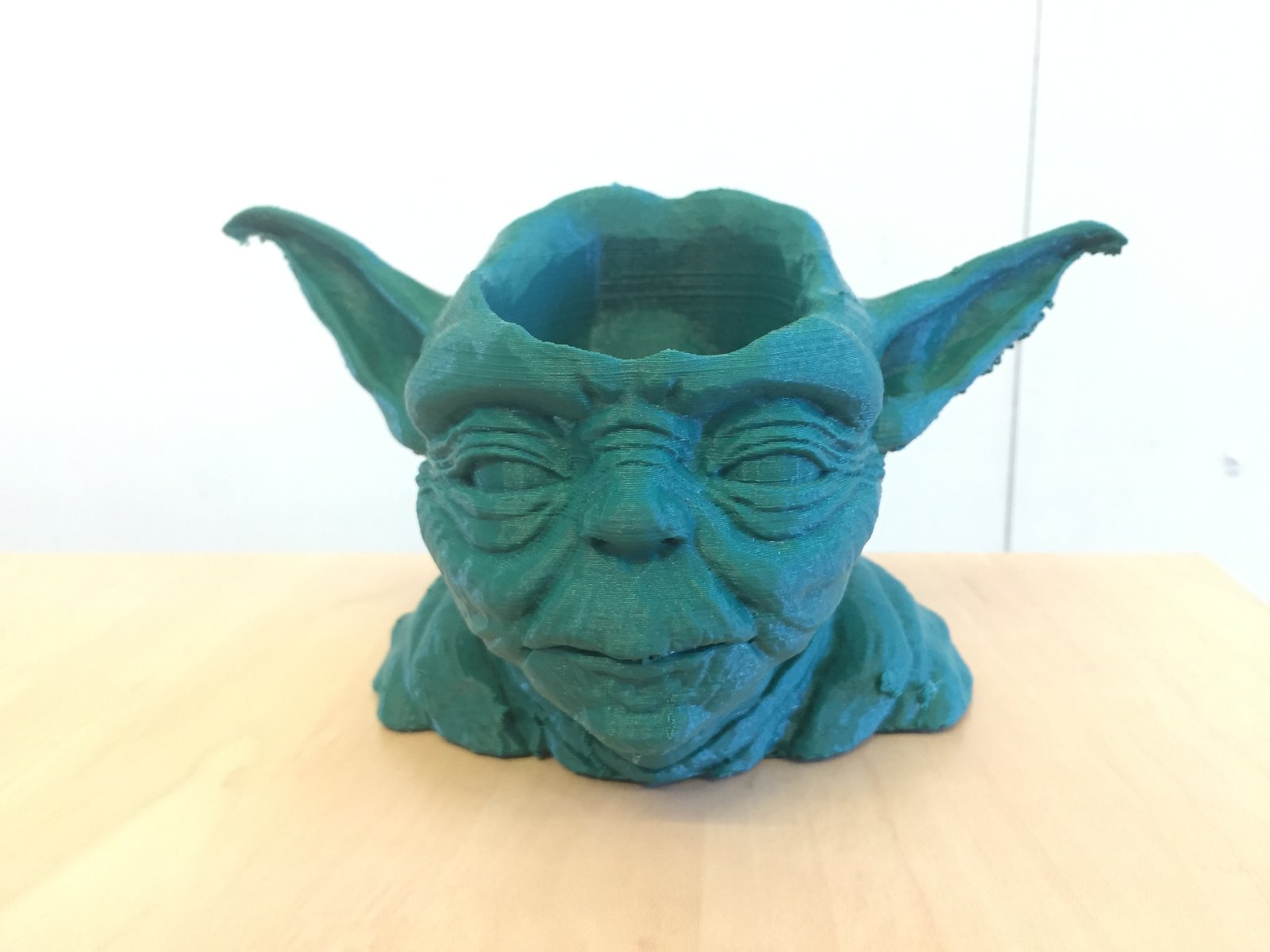

Borderline Designs
It’s printed with GPP… But as you can see, it’s definitely not perfect! The bottom side of the ears have some bumps on it, due to the overhang.

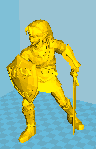

Link from The Legend of Zelda! Pretty cool figurine, huh? It’s printable with GPP, however, it’s gonna be as big of a challenge as finishing Ocarina of Time :wink:
Sometimes designs will come in that are almost 3D printable. These designs above are printable, but there are a few problem areas that make it very difficult for an FDM printer. For example, the ears on Yoda or the Sword from Link that has significant overhangs. If you are up for a challenge, you can accept the order, but first you need to get a better understanding of a a few things from your customer.

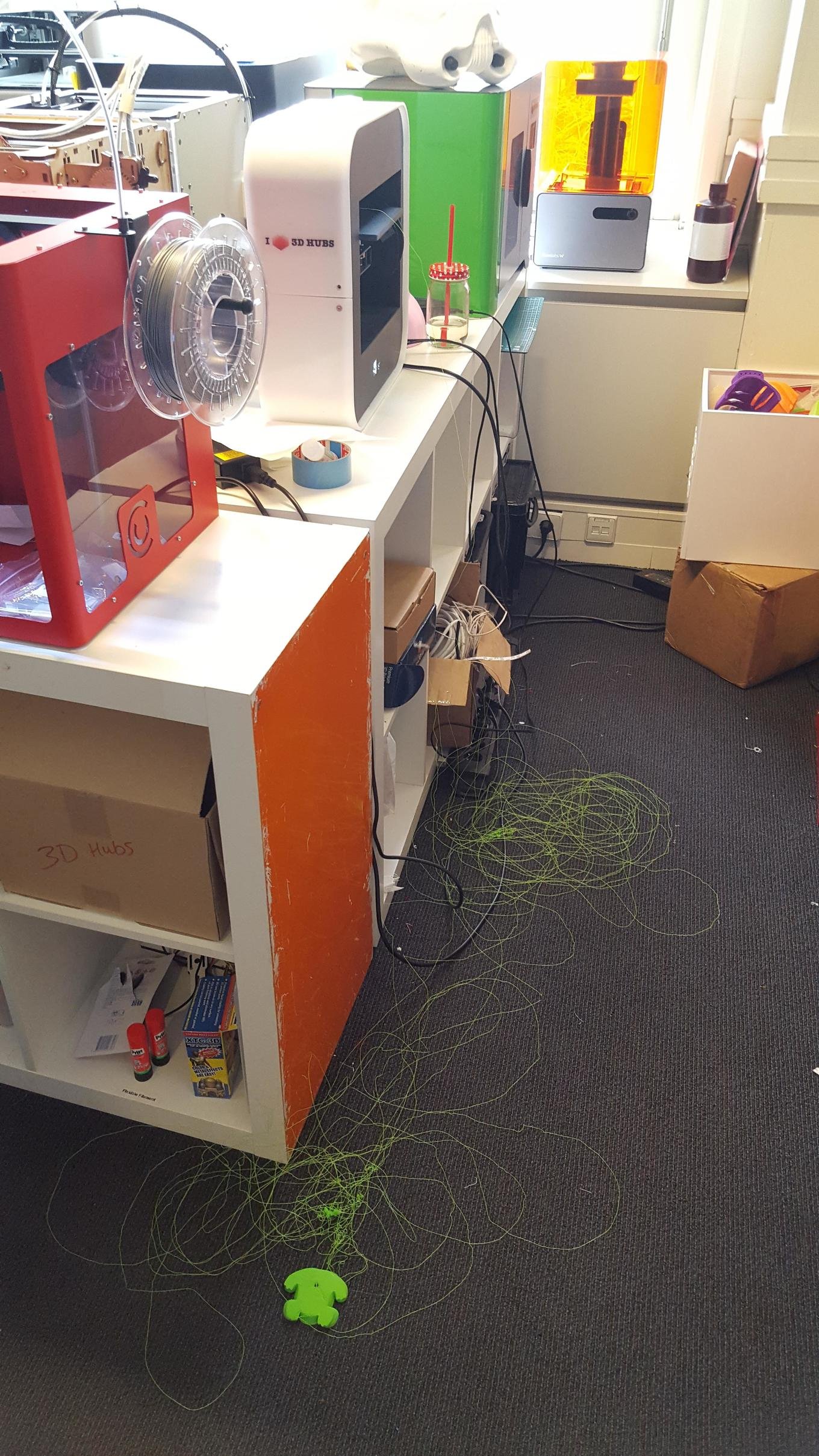

We don’t want to see those fails no more!
