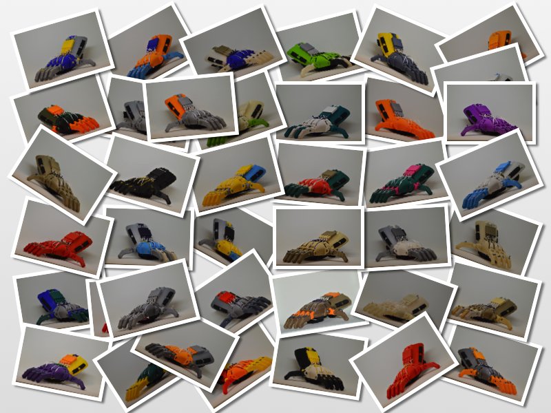

We had a crazy marathon last december when we tried to print and assemble as many raptor hands as possible within 24 hrs. These were all shipped to the Moore foundation to be used as show models.
Thanks @Nikki! I am certainly working hard to spread the word to get more of the Calgary Hubs involved. I’ve been in contact with the folks at e-NABLE a few times to get tips and advice on running a hand-a-thon. I can use all the help I can get so please let me know if you have advice @CharlotteJ.
Thanks for the mention @CharlotteJ for those interested to learn more, I’m always willing to assist. PS these are the hands we sent 40 total…
That’s awesome @martinv77! How did you determine what sizes to print? How many left vs right hands did you make? Did you print these all in PLA?
Hi Collin, since the hands will be used for demonstration proposes we printed them at 100%. We did print 25 right handers and 15 lefties… We used a variety of materials provided to us by our sponsors #ColorFabb and #Ultimaker. Most were PLA, but we also used XT and the all new nGEN
