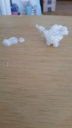

Hi guys. I just got an M3d after my last printer broke and I realized most of the prints i was doing were really small any how so opted to get a smaller machine for my little studio.
So far i haven’t had much luck. Prints get a few layers in and start to peel up. Either won’t stick to the raft or they just start to delaminate from the print all together.
see my two attempts at Marven I have a few more now but seem I can only get the feet before it starts to mess up.

thanks. I did check the level My floor is apparently not straight, which means my table and printer were also not flat. I put a few shims underneath and have gotten it more level. Seems to be helping a bit. But the layers still seem to delamanate from each other. I am using the M3d filament will try to order some others. I am a bit worried to burn it if I put the temperature up to high. But I also wonder if there just isn’t’ enough filament coming out of the nozzle, as if it is clogged?
