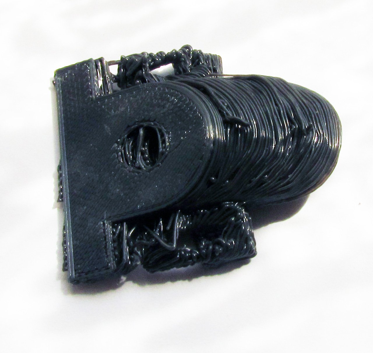

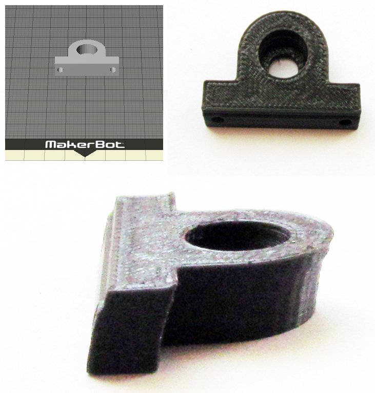

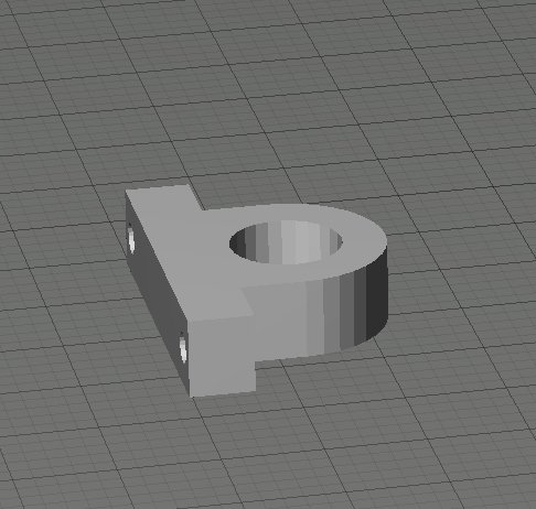

I printed one of these brackets, but it prints the layers ok, but they are not lined up properly, its like 1mm step on each layer so it looks like a pack of cards that have been slid to one side. any idea why its doing this?

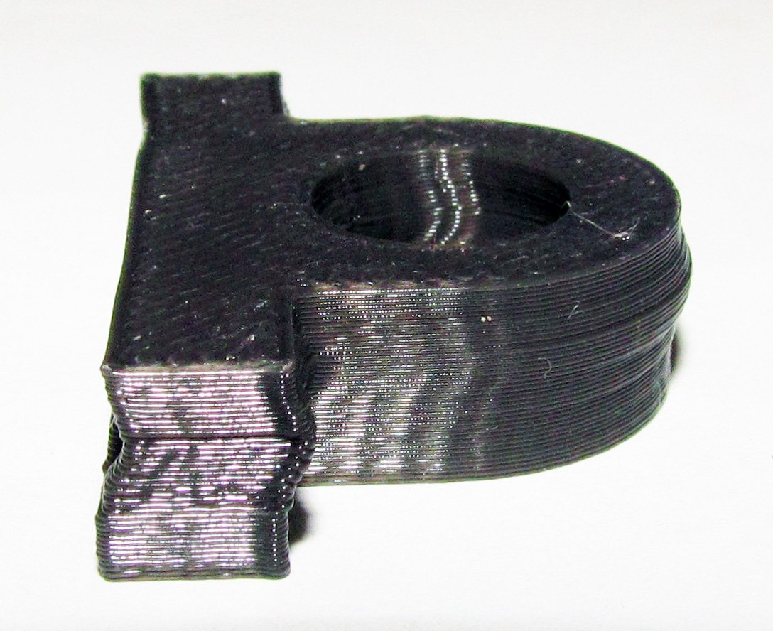

the last print was not dead center of the printer bed so i put the object in the center with makerbot then send it of to print and its a lot better but still not straight as shown in the pics, im hopping this might pin point my problem better.
Thanks Marius.

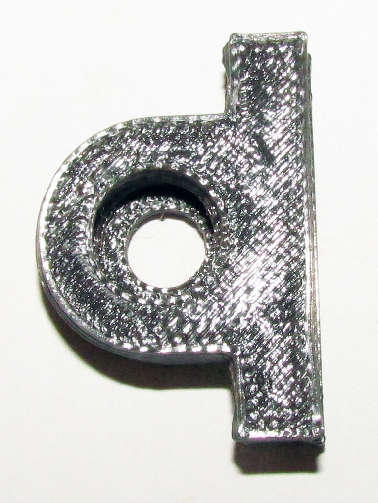

I just uploaded a new printout. i changed nothing other than the location of the object on the print bed and its a lot better but still off a bit.

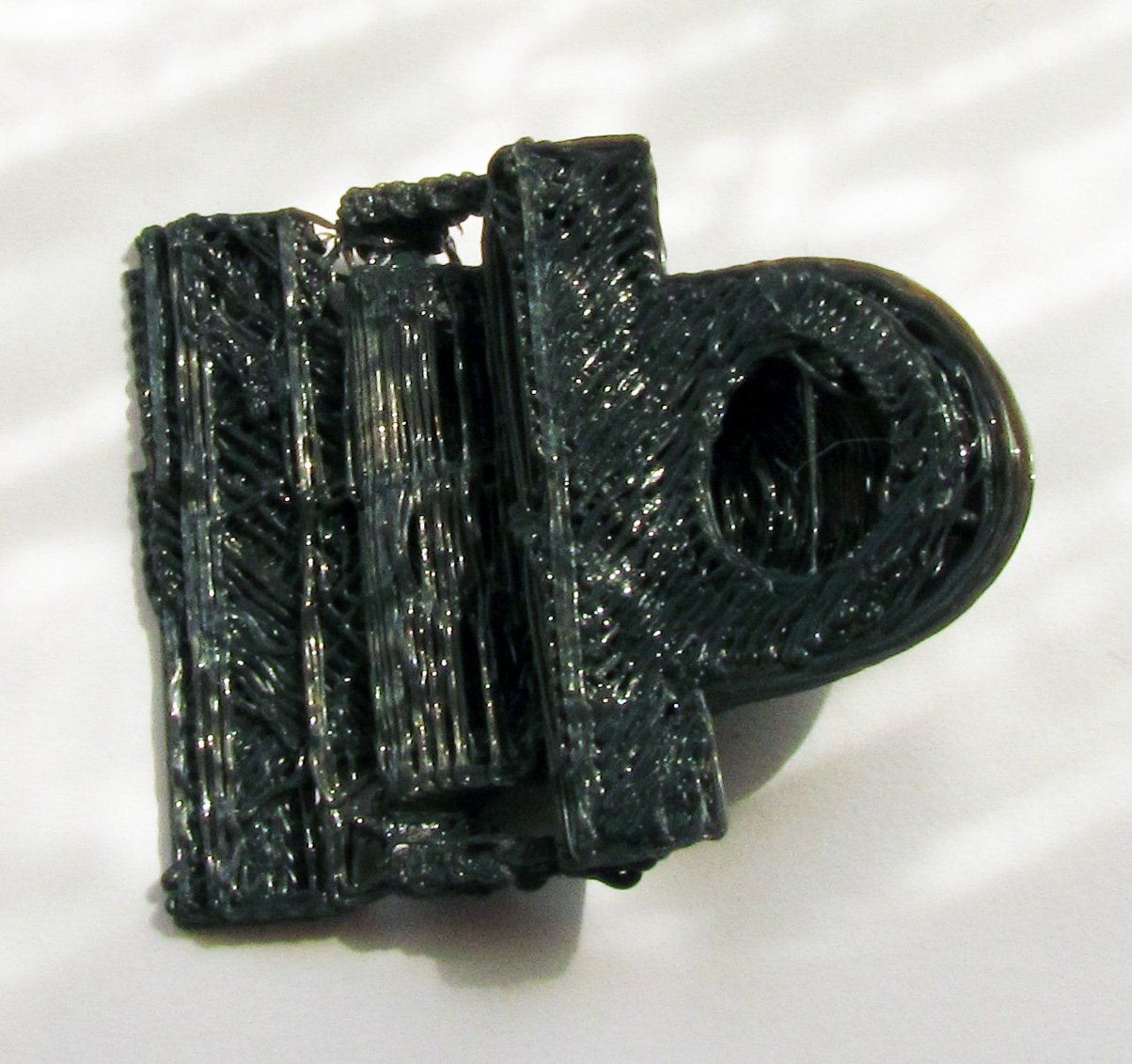

This is bizarre! True Failed print @

Could be one of the stepper motors is not behaving right. there is an encoder in the motor to tell the drive board where it is, from the photo, one of the axis is off, then other is good and the Z is good. Try unplugging and replugging the cable into the motor to make sure it is plugged in correctly. It may have come loose from shipping.

i’m getting my best ever results now :slight_smile: something is still not right but wow what an improvement from my first post to this one.
