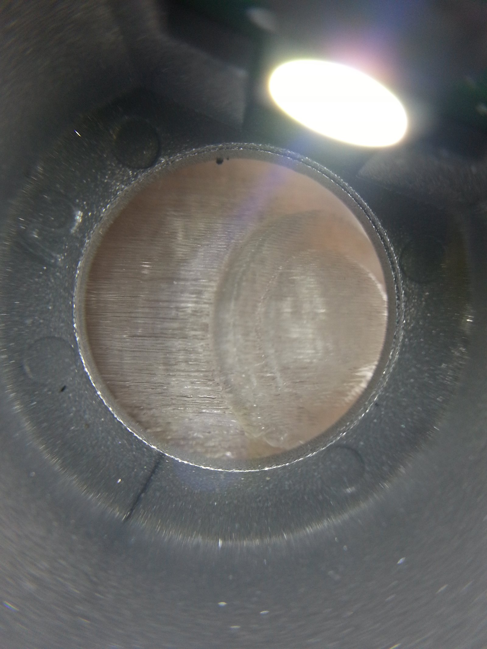

Here is a Microscope close up of my print of marvin to show my printing quality, notice solid layer bonding. I can also mail out a sample print.
Hi, my apologies. I mistook your name for Marvin. I am not familiar with the 3D hubs site, and was referred to it by Shapeways while researching potential companies for printing our prototype, and did not realize Marvin was a mascot of sorts. I donât believe you have given your name in any of our correspondence. Thank you for the image of the microscopic view of your product. What material is shown?
All the best, Rob.
Sorry about that! My name is Bobby Willhite, pleased to meet you. Did not realize my name doesnât show on here. I do not use 3d hubs very much either, But I take a special interest in the Jacksonville hub page, our city has a great economy and the 3d print industry is ready to boom here.
The material shown is clear ABS plastic, one of the harder to print materials due to warping. Polycarbonate has this same issue, another reason I had suggested looking into nylon. But of course I donât know the application so I canât make that choice. But as a printing enthusiasts I only want to spread information. Another thing about both materials, they are hydroscopic so having a way to remove moisture from the filament before printing is very important especially here in Florida.
