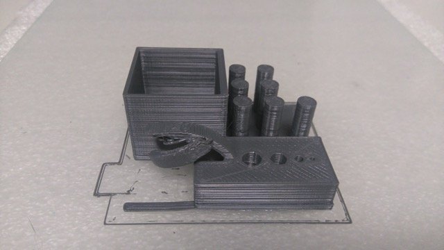

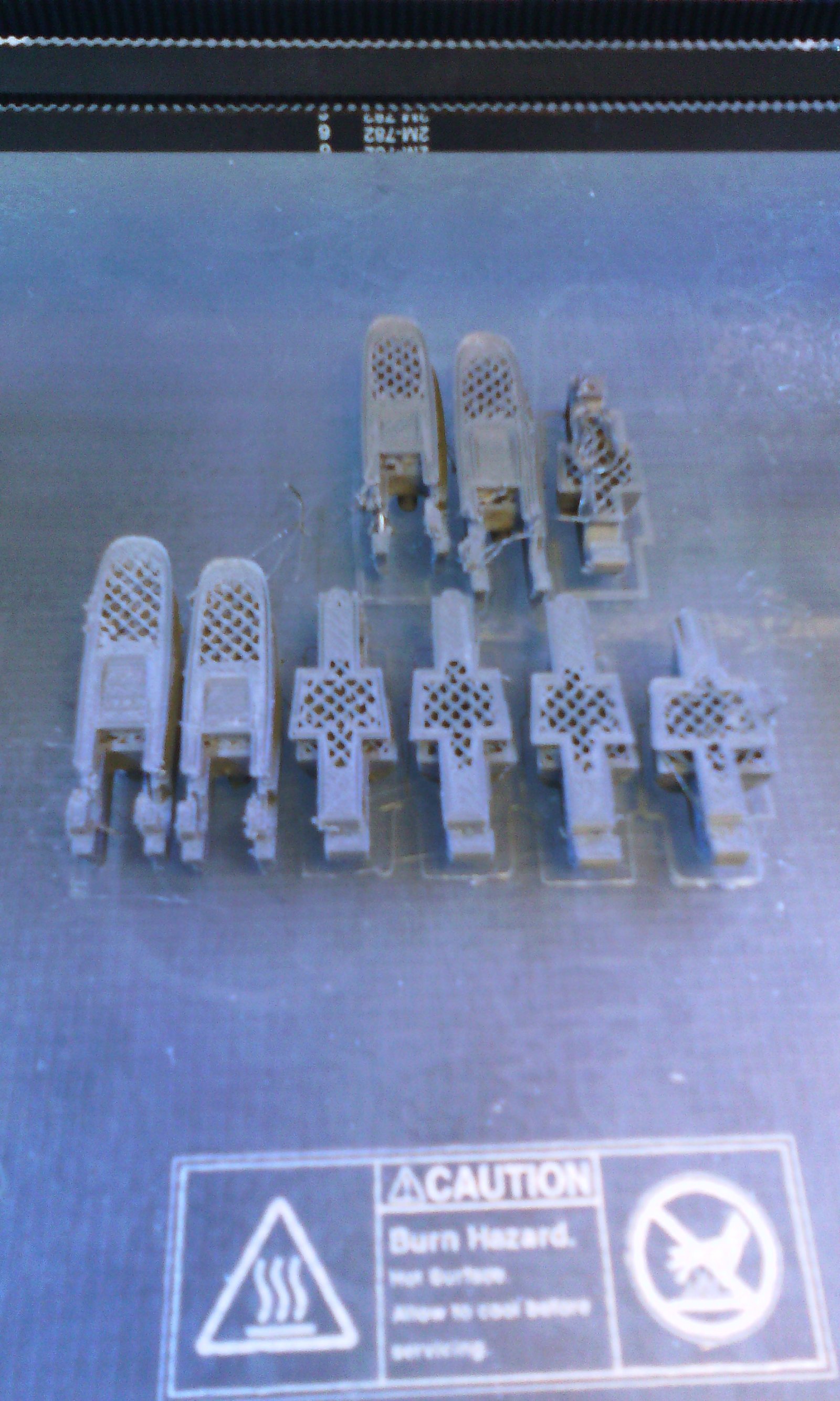

I have lost several big prints over the past 4 days with shifting and the bed appearing to jump. Please see attached full bed picture showing the typical issue Does anyone know what the issue is? Bed is levelled and calibrated using latest driver and cura, print speed 30 and retraction giving near perfect test results.

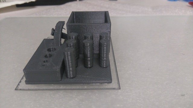

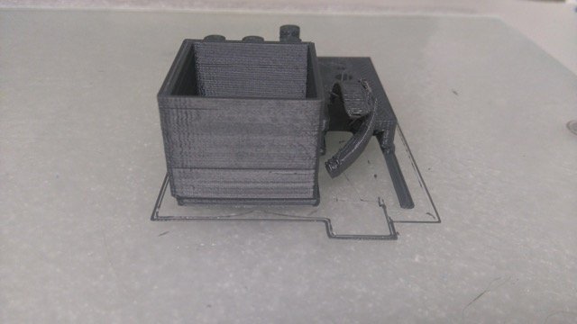

One possible cause I thought before doing the stress test attached, which shifted at the bottom layers was when the head is moving around the bed it is hitting the other parts and that is effecting it. As it is printing some holes on the vertical plane, parts will curl up as they are built and the nozzle sometimes hits the little bit thats sticking up as it repositions, however, not sure if that enough to make the shift you see in the full bed plate.
I also wondered if it could be a filament feeder issue, with so many small retractions constantly happening that I may be getting some grinding that is causing the head to jump. I just managed to get the sweet spot for retraction with XT 2 days ago, but this was happening before that.
I tightened the Y axis belts the other day.

This can be caused by many issues, some of which are: 1. Bed screws loosening and resulting in bed height changing DURING print. 2. Motor failing. 3. Loose belt slipping/ y axis binding 4. Shorting or disconnecting servo wires
From my recent experience ( actually yesterday) i found out similar case, when some part of the print curled up and hardened ( cooled ) enough in order to make the hot end head to shift for some steps and ruin my print ( my luck it was a small part).
What kind of material are you using ?
What is the travel speed ? ( if too high can also cause this )
In order to prevent curling i would suggest to try print slower and with some kind of box of something that will prevent for rapid cooling of the part.
What plastic are you printing with? If it’s PLA then it’s cooling. I actually have a desk fan I blow across the bed when printing PLA. Some prints with spheres you may catch me using a spatula to hold the plastic down from curling up (my bed is stationary). Oh, you may also want to look at Retraction Vertical Lift (Simplify3D is on Extruder tab in the profile) or the like (I have mine set at 0.8mm).
I get this issue occasionally on my printer. In my case, I have found that it is caused by the belt which moves the bed slipping slightly, causing the rest of the print to be offset in the y axis. Usually, tensioning this belt fixes the issue for me, or slowing my print speed down ( but in your case it is already at 30mm/s which is at a slow enough pace). I would suggest taking a look at the tension of your belts as well as orientating your prints so that the part’s longer side is parallel with the x axis rather than the y axis - this means that your bed will do less moving and will reduce the chance of slipping. Hope this helps.
