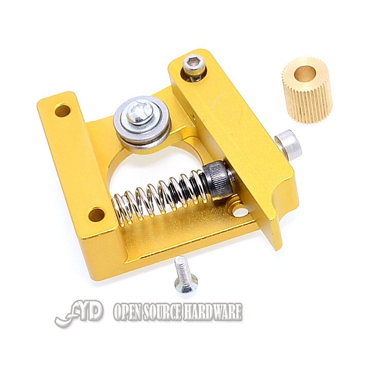

It’s MK8 extrusor but the filament when the extrusor push it, sometimes it sounds like clack clack, and when it sounds, the hotend isn’t extruding. The first extrusor I had was the one’s it comes whit the prusa that didn’t have any system to regulate the pressure of the gear on the filament, so I bought one that has a screw to regulate. But if I grip hard it sound clack and didn’t work, if i grid slow it haven’t got pressure to press filament to hotend. If i grid not hard not slow sometimes work well and sometimes didn’t work
Without pressure screw: LINK
with pressure screw: LINK

I solved the issue. The problem was that the nozzle had little particles of something inside it (maybe burned ABS/PLA) and ABS couldn’t went out. I take the nozzle, put it inside a bottle of acetone, and every hour I took it and I tried to clean it with a cleaning tool. Now the printer is printing well.
