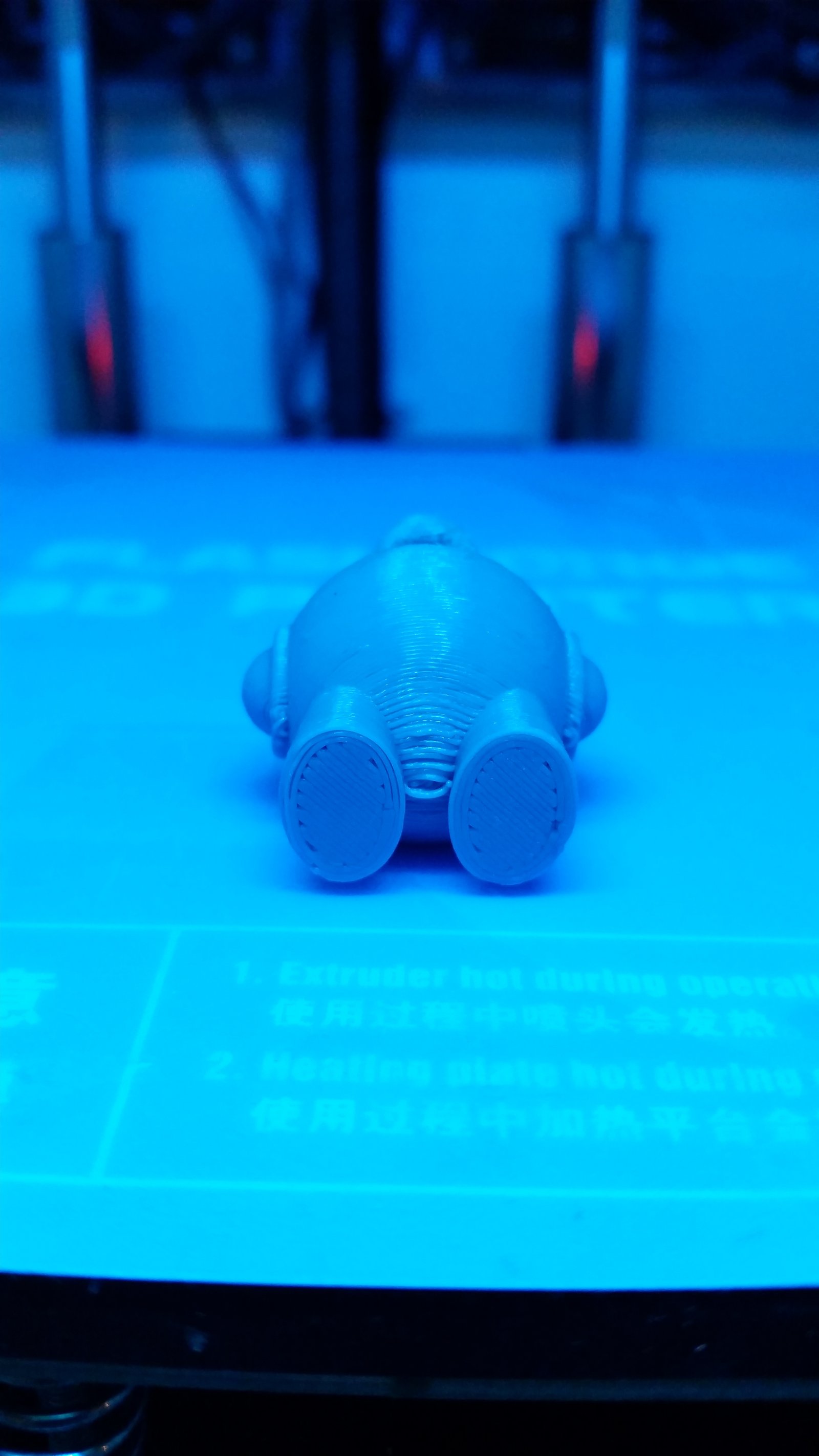

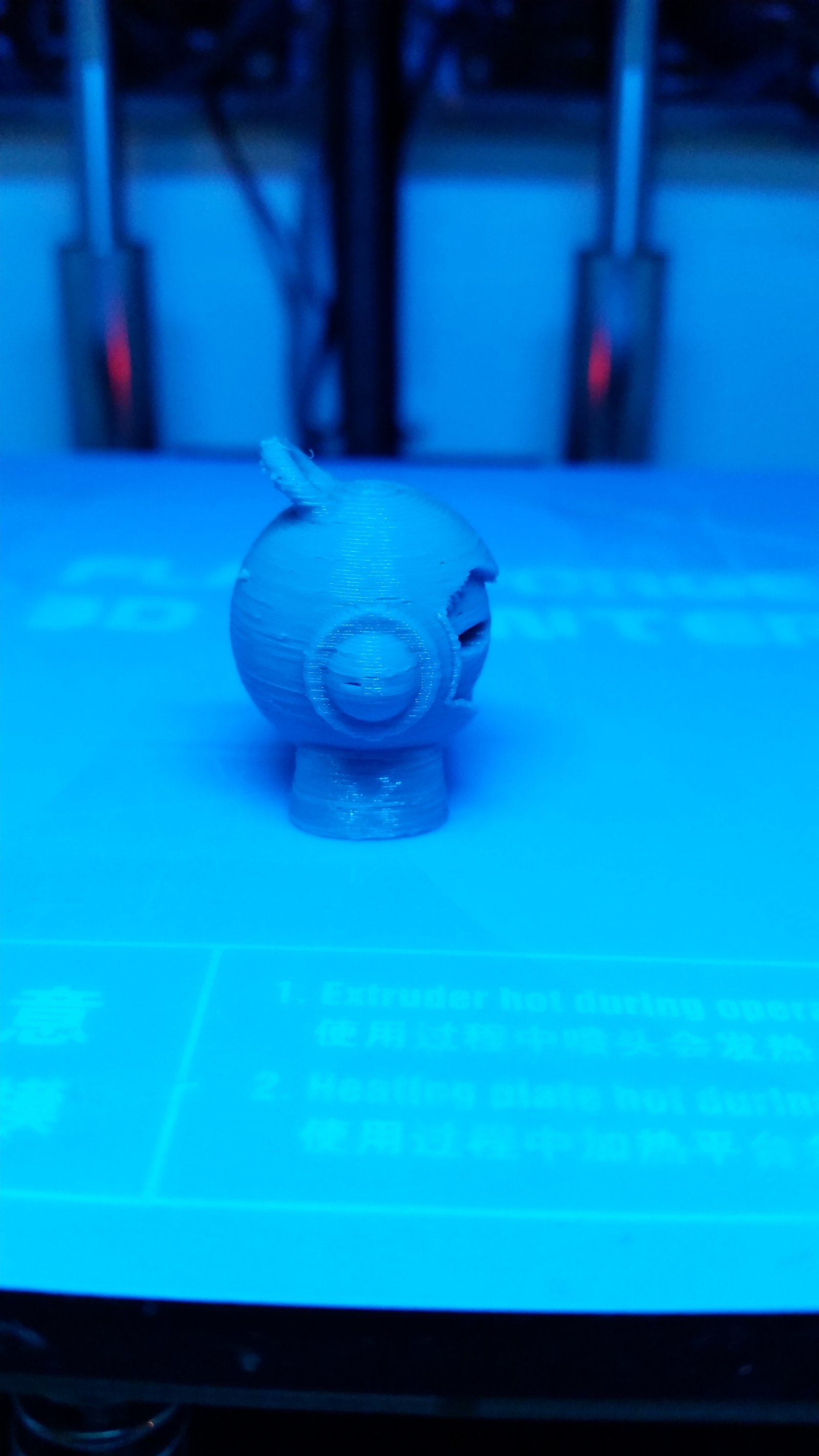

I have been preparing for my 3D Hubs Marvin Test print and haven’t had much success. Please critique my pictures and give any advice. It will be appreciated. Printer: Flashforge Dreamer Filament: Inland PLA Grey Layer Height: .2 mm Extruder Temp: 190*C Bed Temp: 60*C Adhession: Build take Print Speed: 30mm/s Travel Speed: 150mm/s Retraction Length: 3.mm Shell Count: 3 passes Top/Bottom Layers: 3 Fill Density: 10% hexagon Cooling: Fan on 100% after .4mm height

Looks like first layer is little high as the first layers have a bit of a gap between lines
Looks like a little under extrusion on the rest and retraction settings could be teaked for blobing
reprint and go up in 5 degree increments up to 220.
See the differnence (190 is on the low end … see where the filament and printer has sweet spot )

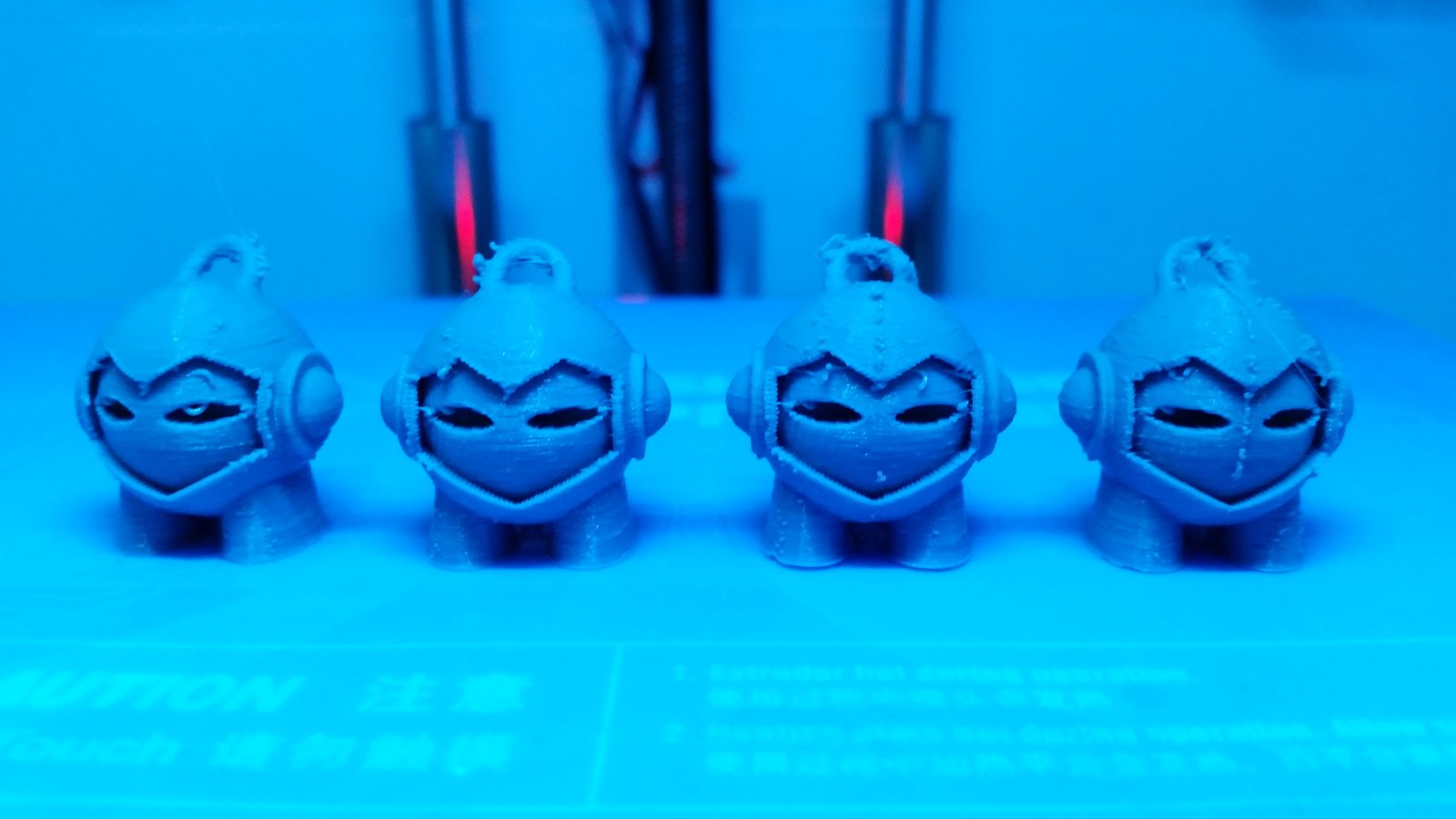

Print 3 or 4 at a time, gives each layer enough time to cool and you can pick the best one to submit.
Yes If the print is small I usually print 2 or more. I went with 4 on this print. All looked pretty similar.

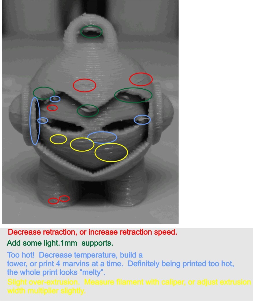

OK, since its very difficult to translate what I want to say to the pictures, such as “holes in layers, blobs”, etc. I did a graphic for you.

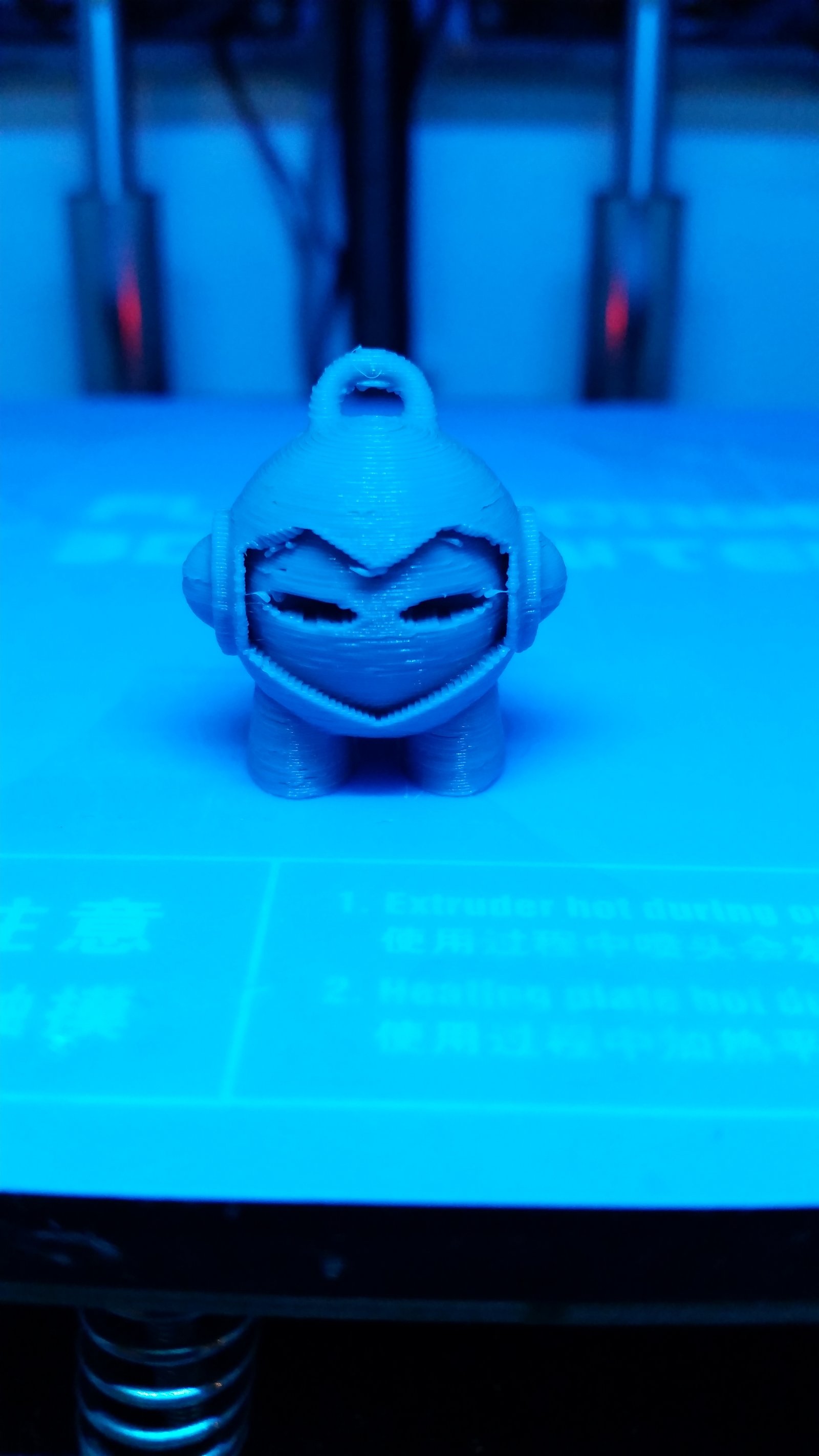

I think you are almost there. But you need some tweaks before you get there. Obviously, you are printing too hot. No question there. If your prints look alot like melted plastic, then you are printing too hot. Hard to tell for sure, as photos of 3d prints always look worse than they really are. But you have obvious signs of overheating. You could try keeping that temperature and printing faster, which leaves plastic in your extruder for less time, which could help.
190 is pretty low, so it could be you are just printing too slow.
Secondly, feel free to use some supports on the top edge of the open face helment (eyebrows) and keychain fob part.
Also, measure your filament. This is key to good prints. This is step one for good prints. Measure width along a stretch of filament with calipers.
I would move away from printing the marvin until you got very good with calibration items. Print a 20mm x 20mm x 10mm cube at 100% infill until you have a really, really nice cube. 100% infill will show you where you are over extruding or underextruding. (over extruding, hump on top. Under extruding = concave or layers not filled in.)

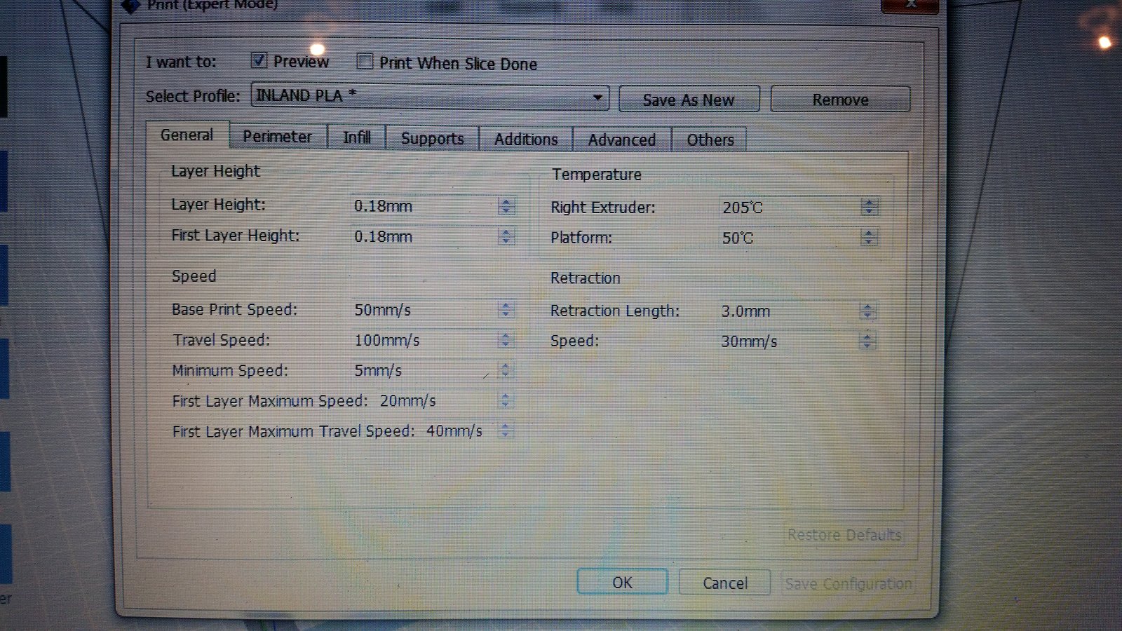

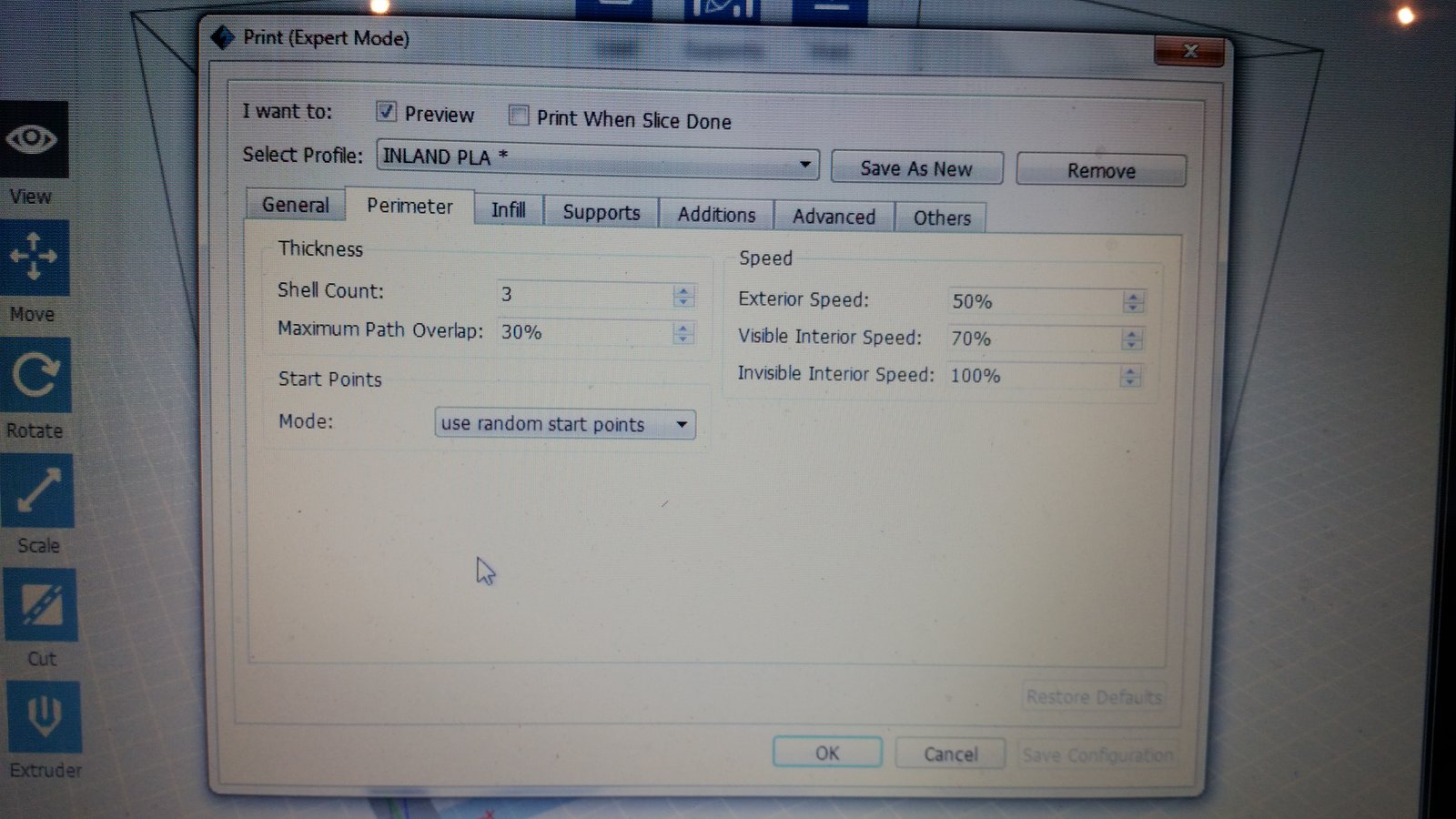

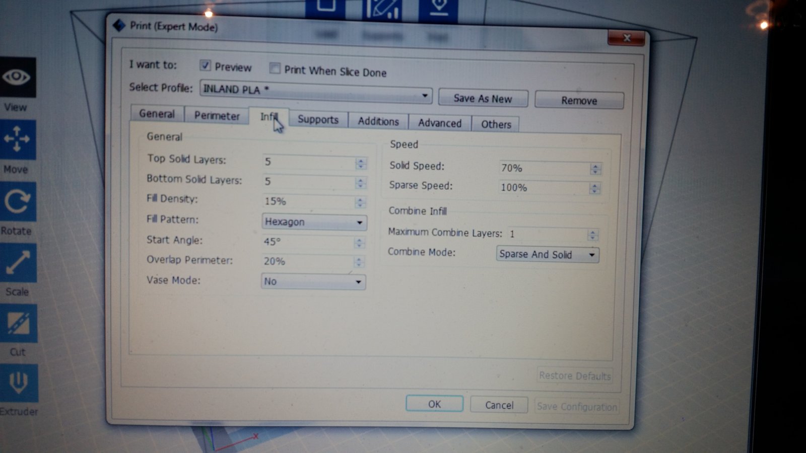

Here is my latest test with the sethings as shown in images. I attached pictures of my settings in flashprint to see if anything looks out of the ordinary. The fan is on 100%after the first layer and my extrusion multiplier is set to 92% which is a higher than it should be by about 2%. I’ve ran a 20×20×20 cube no infill and in vase mode to measure my walls. They came out pretty spot on at 90% extrusion multiplier, but it appeared I was still under extruding so I bumped it up 2% after releveling the bed. One thing I have noticed is when I ran .1 layer heights, I was able to get a lot better looking print still printing 4 marvins at a time. However they still don’t look like they would pass. I am going to print out some 100% infill blocks to see if I can help dial in the over under extrusion. I am also going to move the same filament to the extruder closer to the print fan and face the marvins towards the print fan to see if that helps anything. Any more suggestions would be greatly appreciated.
