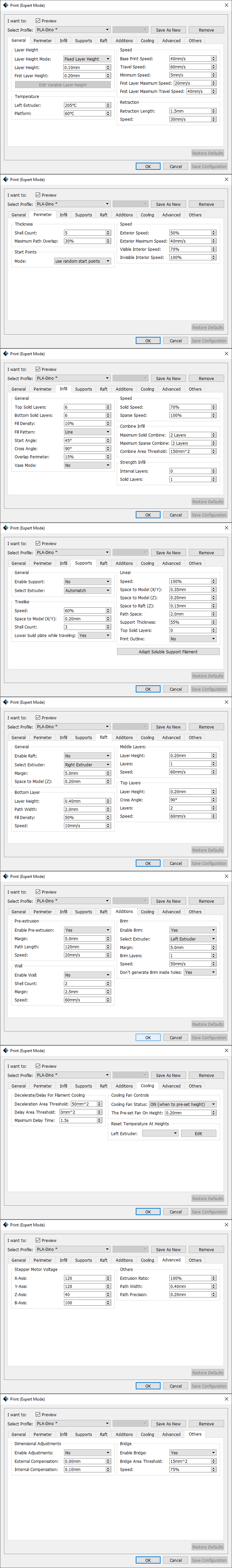

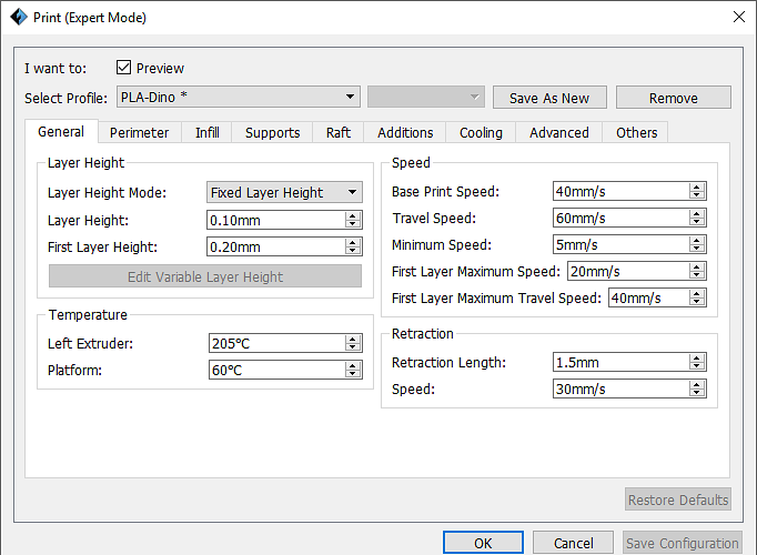

So, I’ve finally tuned in my settings and i’m printing consistently good prints, even overnight and unattended. That said, i’m looking to improve the speed of my printing. I use .1mm layers for detailed prints, and .2mm for geometric prints.
The PowerSpec 3d Pro2 is basically a clone of the FFCP 2016. As a first printer, I couldn’t be happier.
Back on point; I’m printing the thingiverse t-rex skeleton from makerbot at 150% scale, and the top half of the skull came in at a dozen hours or so, and I saw many people saying its a 3 hour print.
What setting in the attached file am I overlooking?
