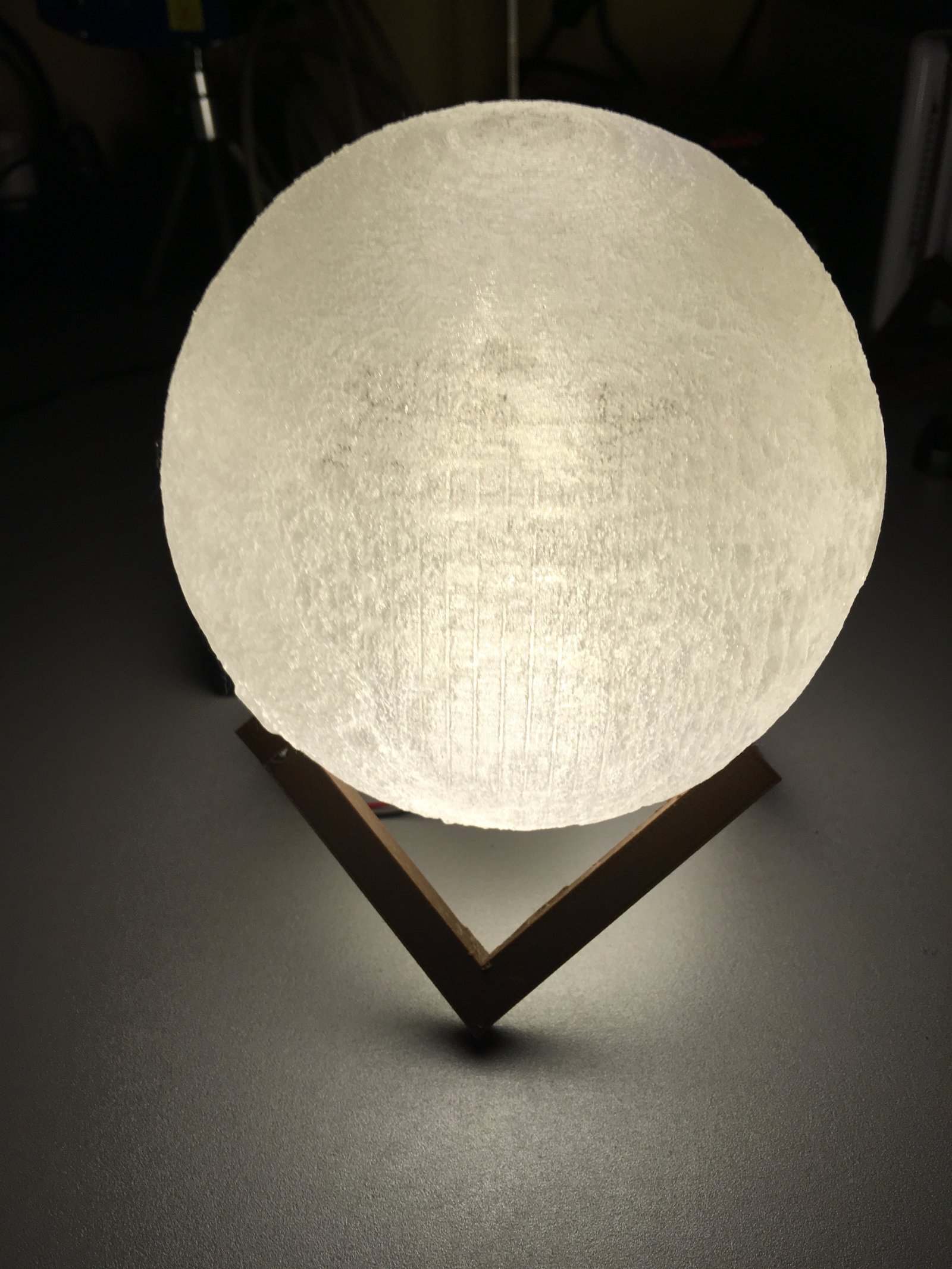

After some rookie mistakes, and a trip back to the Prusa repair shop for my printer, I finally am able to produce something worthwile on my printer. Or at least I could but not anymore. I’ll explain: I have successfully printed the 14cm moon surface nightlight from Thingiverse once and now am trying to repeat this feat but keep failing (4 times already)
It seems to fail when I only have to complete a centimeter of the globe, the printer makes short stops and the vibration seems to wiggle the print loose and starts creating the well known spaghetti.
