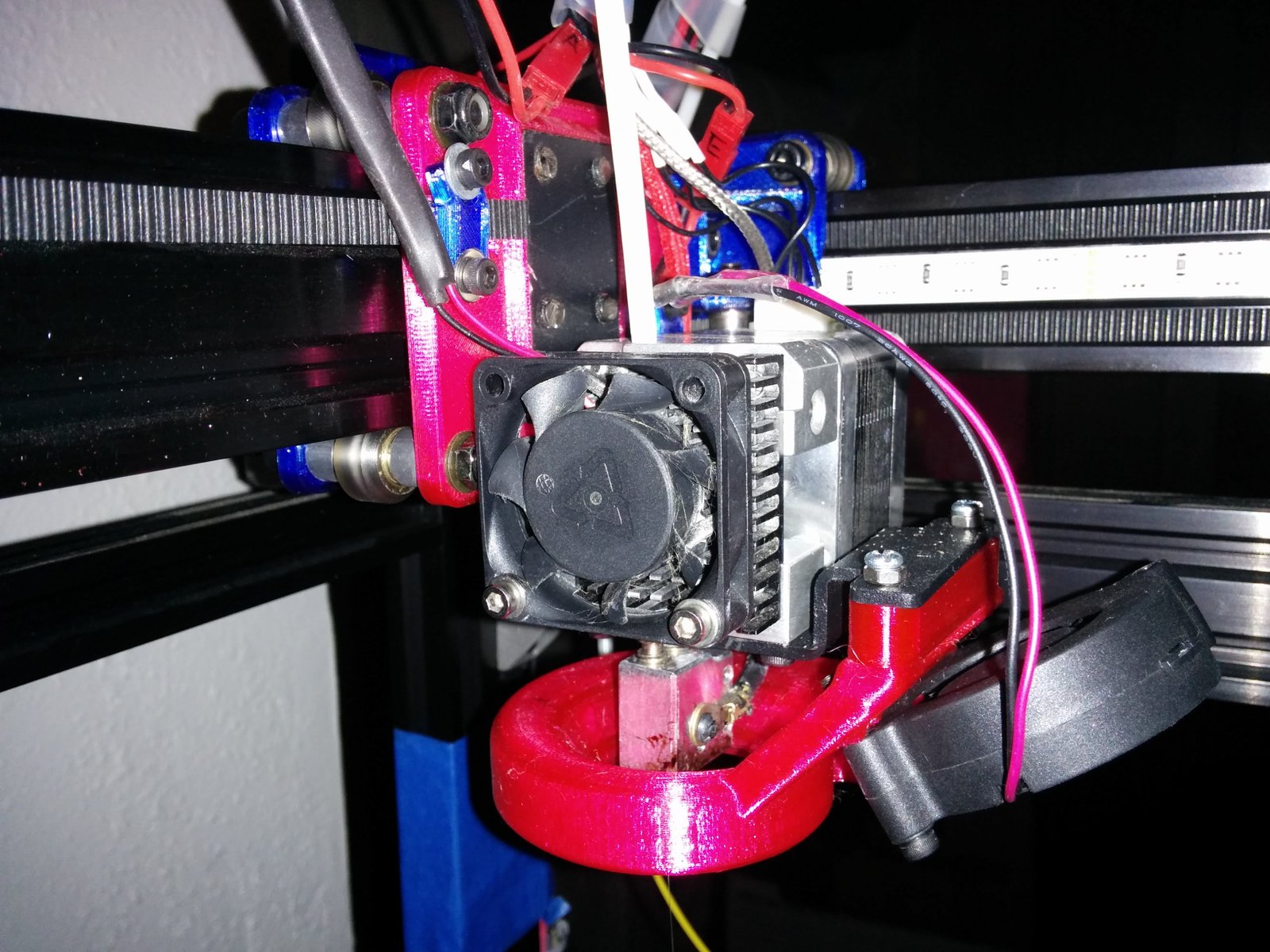

There is no PID autotune in sailfish. You can change all the paramaters manualy through the onboard preferences in RepG. There were some changes recommended for rep2x users as there was some fan wash. AKeric and I share inspiration for our printers, mine is the triple leadscrew varient, any advice you glean from his blogs is worth noting.
One a side note, I also use a volcano nozzle on my big bot, running a flashforge mightyboard, I do get pretty consistant temps.
