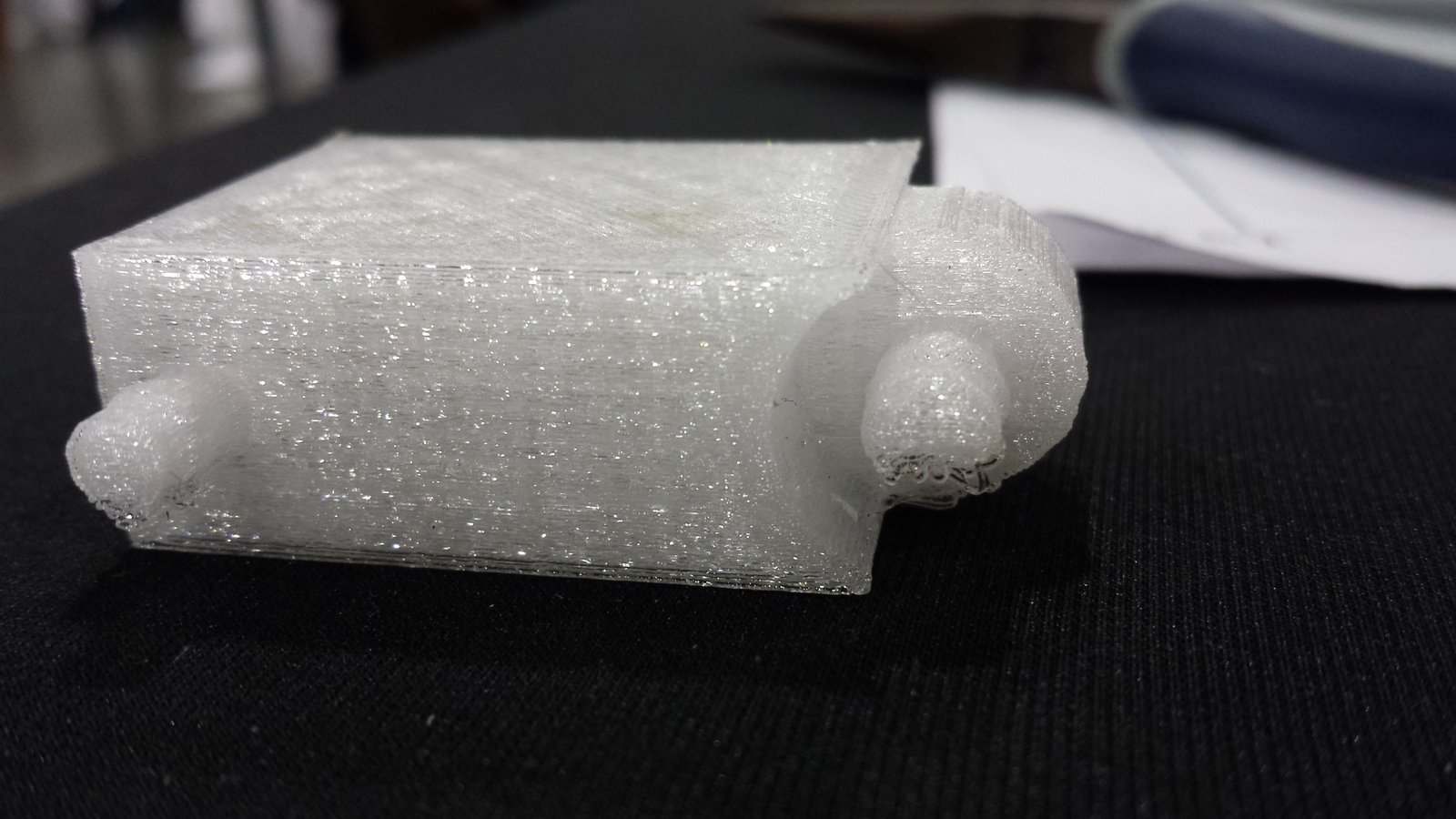

I just got some new PETG and I’m having some trouble with the top and bottom surface finishes. The sides turn out fine, but whenever it has to span over the infill it gets blobby and creates holes (as seen in the picture). This is printed with 4 top layers, all layers are .2mm, and it seems silly to have to do more. I believe the top was printed pretty slow, maybe 30mm/s.
Any help would be appreciated :slight_smile:
At what temperature and general speed were you printing ? The whole side surface looks pretty … rough … to say the least :wink:
Try increase the cooling a bit and definitely increase the flow rate (if possible). Also increase the fill density, PETG isn’t really the greatest material for bridging. I usually go with 8-10 top layers of varying layer heights, you should definitely consider this.

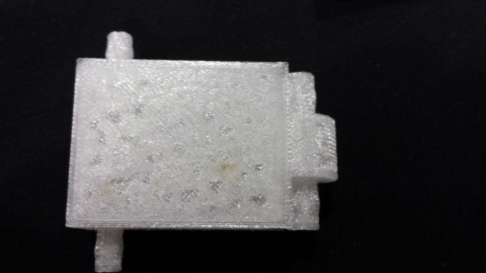

It seems like you’re generally underextruding so increase the flowrate, printing temp and lower the speed. Do you have any other color of PETG in stock? White / clear is the most difficult color to see the surface imperfections (pic 3) in detail.

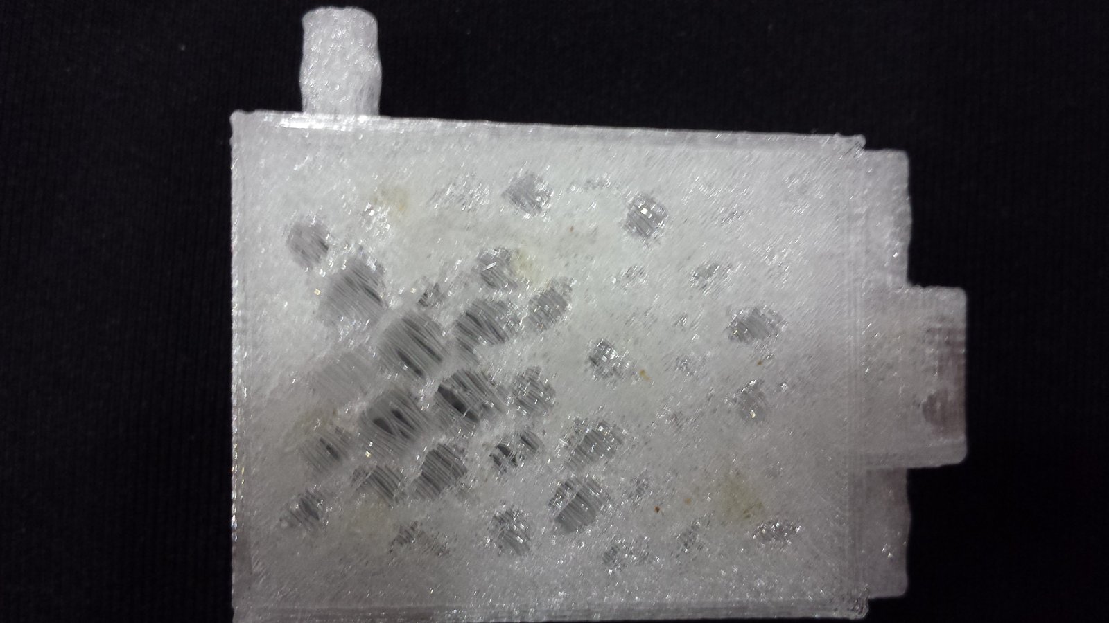

Bottom:
For the bottom try over extruding on the first layer. This will help get a good finish and can take up some space caused by poor bed leveling.
Top:
I would try active cooling. PET seems to hold heat longer and that could cause some of your issues on the top.
If the top solid layers all face the same direction see if there is a setting to rotate the fill direction. You could also try a different infill type.
You may also want to increase the infill density to get the top and bottom to have a better chance of laying down.
My personal preference is to never use honeycomb infill. It’s not always stronger and beats the tar out of the printer when printed fast. I rotate straight infill by 30 degrees every layer. This gives all of the angles of honeycomb without wearing out the machine.
So with the v6 unless I’m printing low temperature PLA I don’t really use the fan. And there is very little heat creep. I can infact touch the lowermost section of the heatsink with my bare finger and not get burnt. It’s super efficient
Thanks for the replies, I’ve been printing with 8 top and bottom layers and added cooling. Everything is looking great as of now. I’m going to play with it some more soon and see if I can reduce the amount of top layers. Thanks!!!
